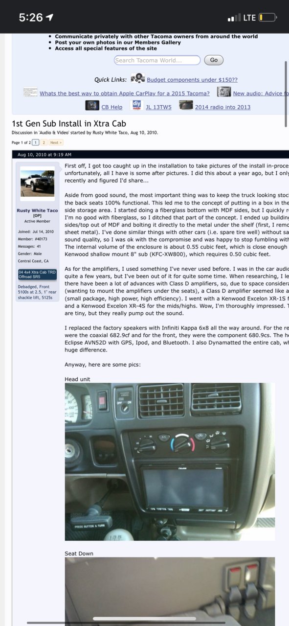

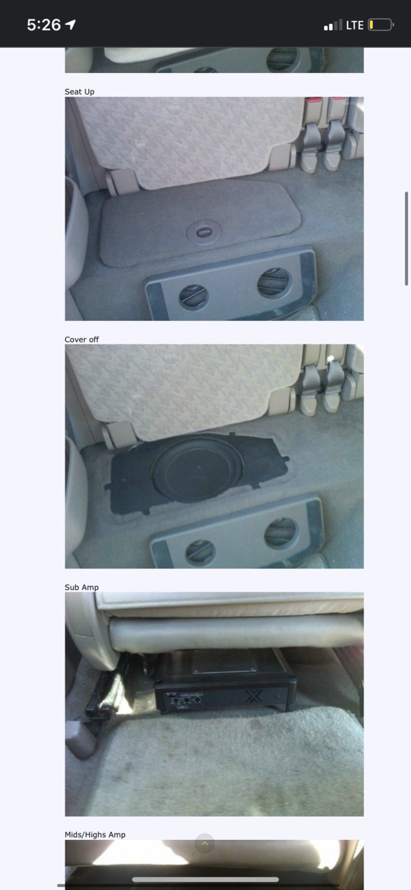

    Hello!! I have a first gen xtracab tacoma and have a full audio set up. All I’m missing is some badass subs.
    I was doing some research and saw some work I would like to replicate but unfortunately I have no idea how to do so.
    the picture I saw was that he had turned the passenger rear seat storage compartment into an 8” sub housing .
    That part I’m struggling with is how they filled the compartment with mdf. Plz help!!!!

    Actually the guy said he lined it wit mdf!

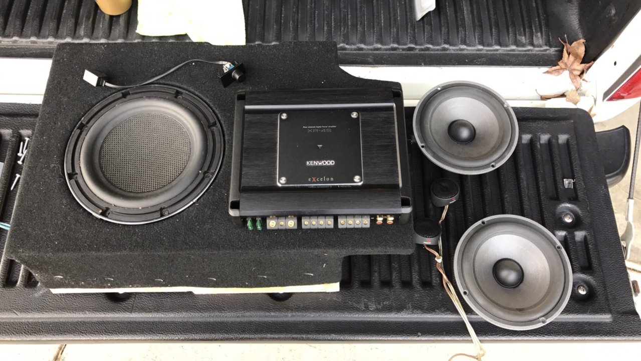

    I built an enclosure like that for my first gen years ago, you have to disassemble the rear area so you can pull off the metal shelf. Make a frame that fits underneath the metal shelf, once it fits, i used fleece and fiberglass to contour the floor.
    Lots of test fitting and back and forth between the bench and the truck, but once you find fitment, its a few layers of fiberglass.
    edit: not the greatest photos but hopefully this gives you an idea

    You can do it with a small amount of fiberglass and mostly MDF.
    You need to cut each panel to a size that fits in the hole. You will pretty much be building the enclosure inside of the cavity. Since you wont be able to get perfect lines or perfect seals you will then use the fiberglass inside to seal up the enclosure. Just remember once you build it in there, its going to take a more work to remove it than it took to put it in.
    I made the same enclosure for my 92 pickup many years ago. Thats how I did mine.
