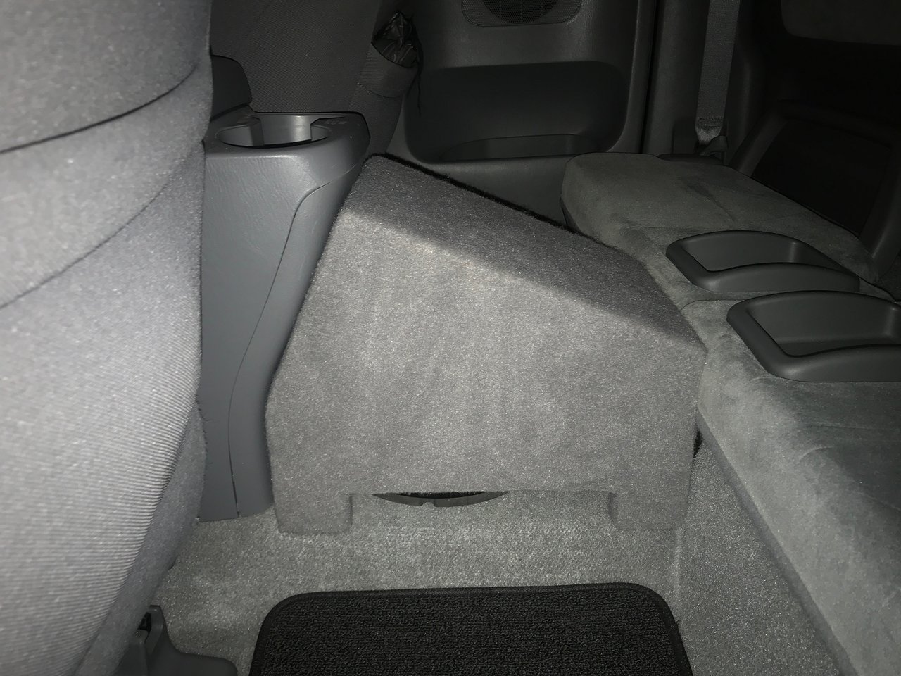

    I just had this installed in my 2008 access cab. The box I ordered from super crew sound $150. The 8”sub is a CDT QES-820 $150 I got that from woofers etc. ask for Joshua he helped me with my whole system. He is very knowledgeable with the CDT speakers. He sold me a Focal 900x1 amp to drive the sub and had me wire it in series so your getting 500watts of really clean power. It sounds unreal. When I installed all the other CDTs tweets mids and woofers I was hoping to do without a sub. It sounded great but went with this sub set up and couldn’t be happier. If you go on CDT audios website they have a anniversary package that has $1000 set up for $500. I did a similar setup but added 2” mid tweeters,and used 6x9s instead of 6.5s. If I would have know I was going to add the sub I would have just stock with the anniversary package. Josh at woofer ect. Sold me a sundown amp to run the other speakers. I left stock speakers in back for know and power them with my pioneer 4201 nex. Will switch them with cdt coaxils later. I didn’t do any of the install I found a guy on Craigslist and he did a unreal job It’s a bit more then I wanted to spend but god a deal on most everything and will never have to upgrade. Also when the guy did the install he used sound Deading in both doors and the makes a big difference. If your not experienced with hooking something like this up I would shop around for someone to do it. I stream Spotify and music I don’t even like even sounds great. 1AE85DD8-F48C-4F76-84D1-9C8EA98B8859.jpg42854C2C-A15F-43C0-875F-245591974D21.jpg
