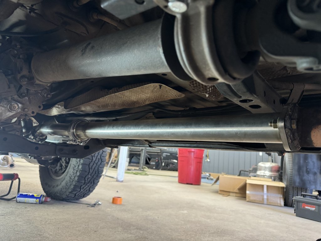

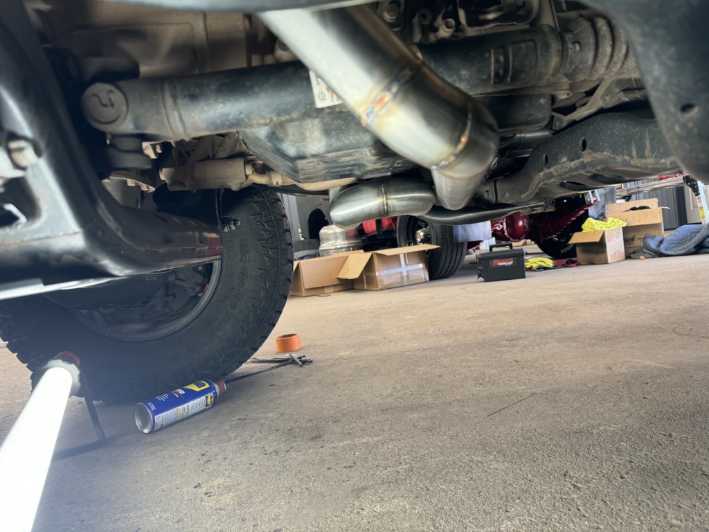

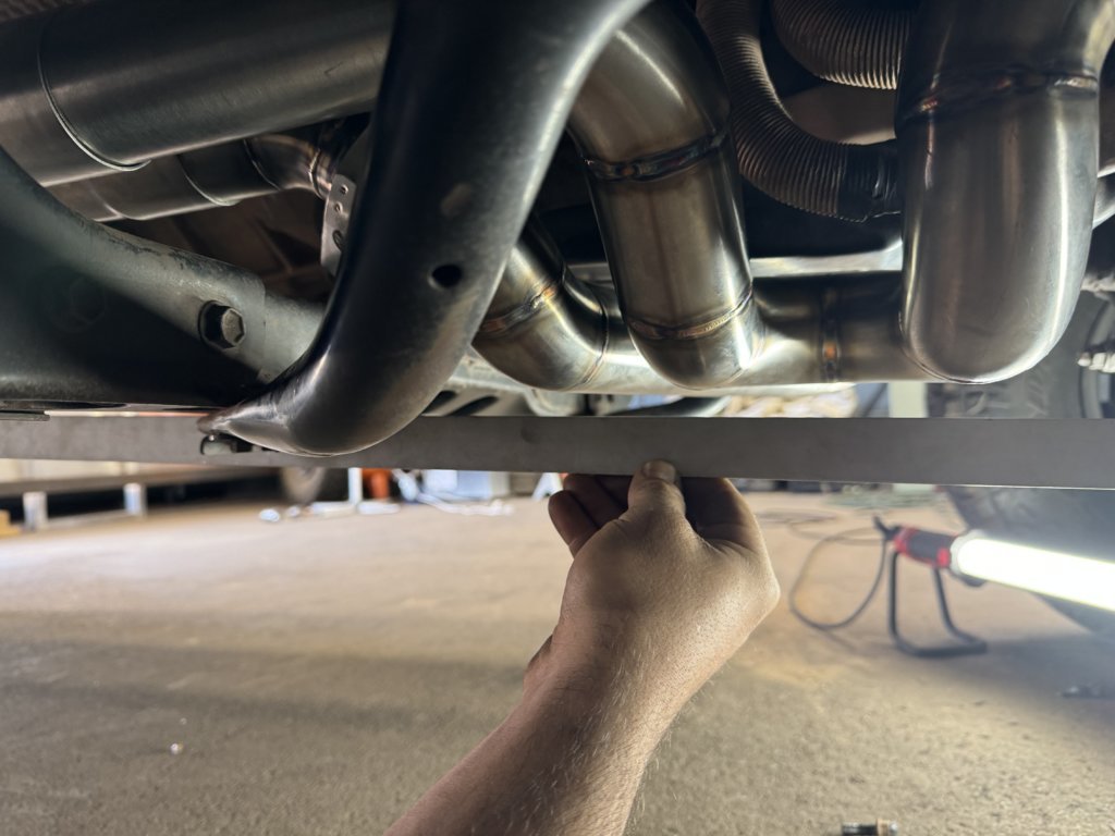

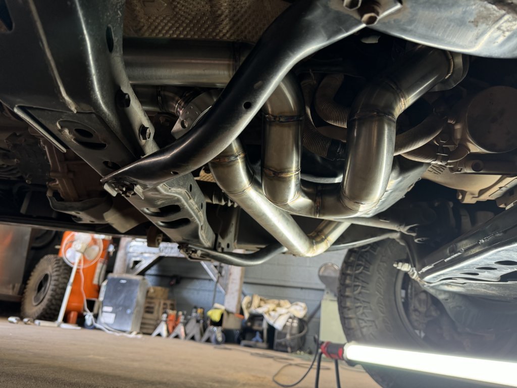

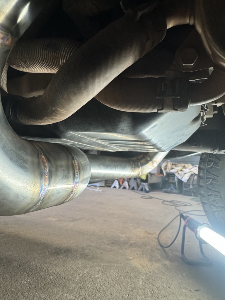

    3rd gen is done ish. Some finishing touches to do, and a jig to build. She’s an odd one, the passenger side gave me a single option to achieve necessary length. I do have some reflective heat sleeve on the way for the hose as it is within 1”. Probably fine without but I’m not chancing it.
    The mid pipes are substantially larger than the 2nd gen’s and do allow more than sufficient room to add a resonator for those that want to tame it down with a straight through like carven or MBRP.
    Curious to get his feedback on what the gains feel like.
