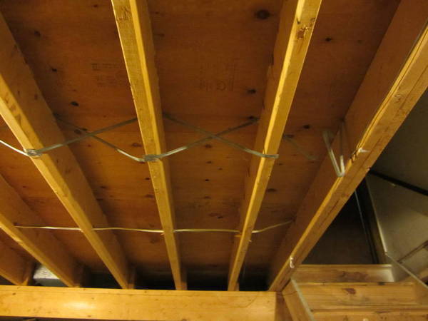

    jflan the house was build in 1979. The picture I put up was the best place to take a picture of the bridging that is there today. The side of the house I will be dealing with has some wire but also carrys all the plumbing for the house but the worst is the lines for the heat pump run through all of the joists in the area plus duct work that covers about 3.5 feet so sistering the joists is really not a good option.

    Any chance the stamp is also labeled " T+G " or " This Side Down " ?

    This is all that I can get off the stamp that I can read.
    Sturdi-I-Floor 20 OC
    19/32" inch Interior (APA)
    Exterior Glue NR8-108/FHA-UM-66
    And another stamp that has this on it
    2-2-2-2-2-2
    K-K-K-K-K-K
    And one more question. For nailing the joist to the block what size nail is reccomended or will screws work?
