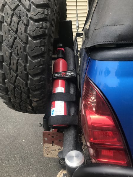

    Fire extinguisher installed. Needed fairly quick exterior access. I have another extinguisher located in-cab.
    Attached by velcro to both the fire extinguisher and diagonal tube brace of the BFF swing-out.
    Thanks @cynicalrider for the Poison Spyder recommendation.

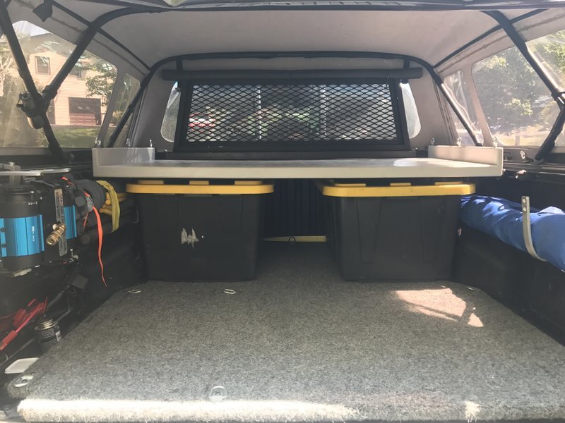

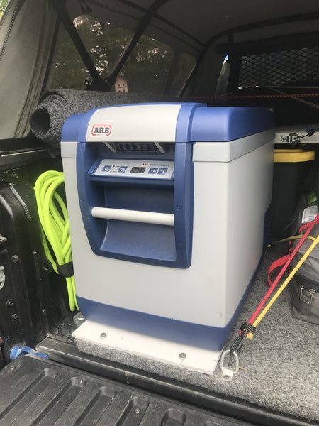

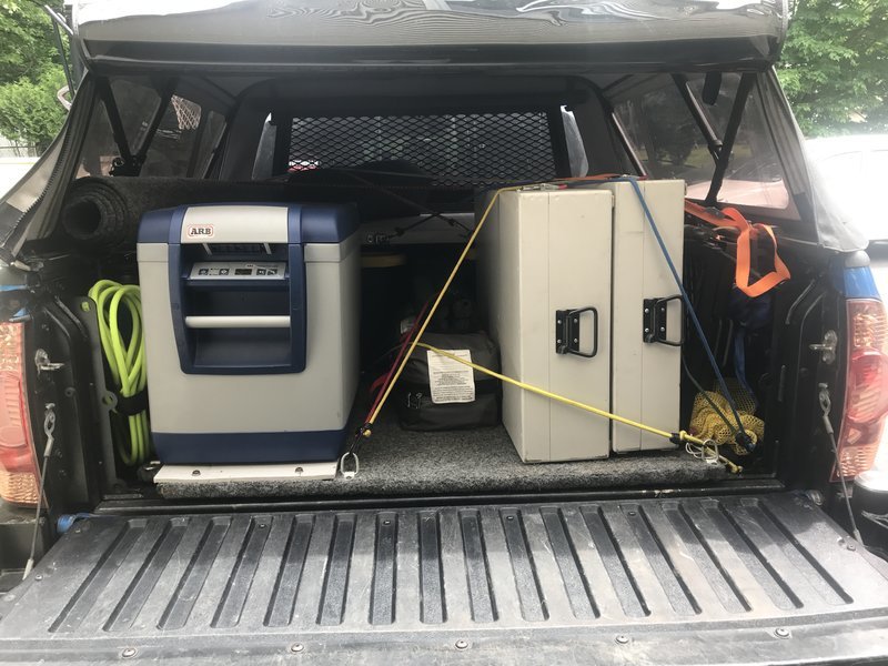

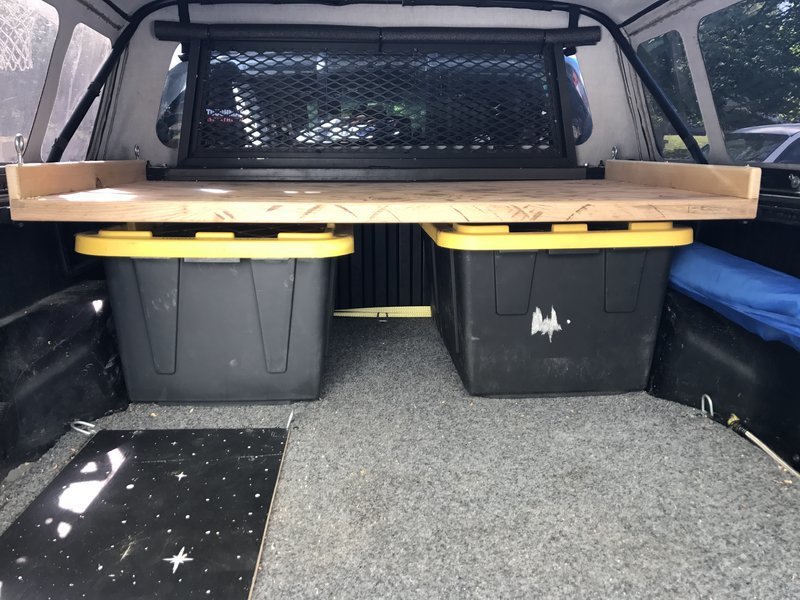

    I made a valiant attempt to organize my bedside for useful and efficient camping and hardcore wheeling.

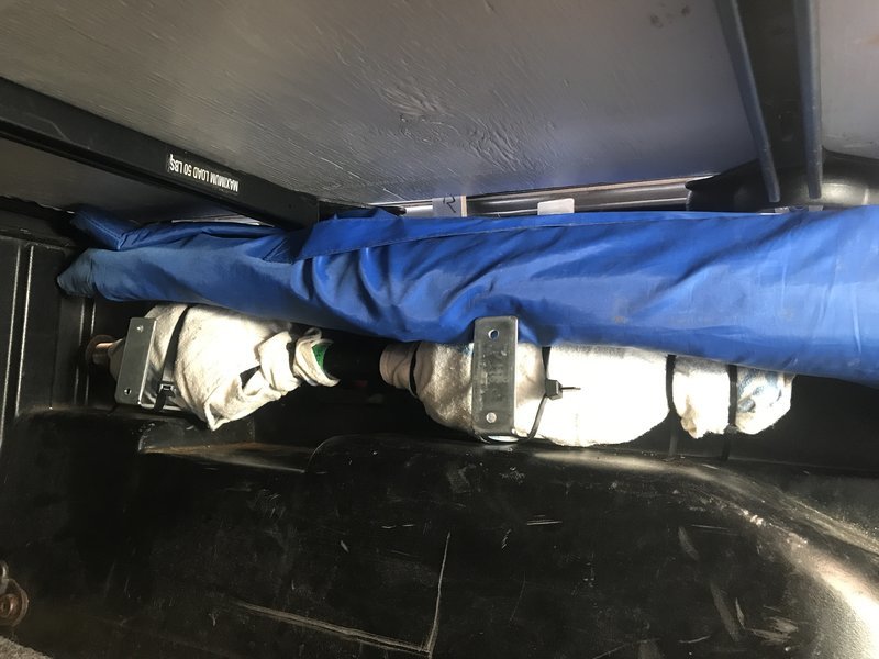

    Space above the DS rear fender was used for a full driveshaft, split into two pieces.
    Space above the PS rear fender is a CV Axle and a 8 foot shade umbrella. I used available metal brackets and other metal scrap that I tend to hoard and save in my shed. I bent the brackets using a good 'ol vice and BFH. Brackets were attached to bedrail via t-nuts.
    I built a shelf in the forward section of the bed with scrap plywood. Height is perfect to store those yellow top containers both below and above the shelf (if needed.) Added a bunch of screw eyes in various locations for tie-down points.

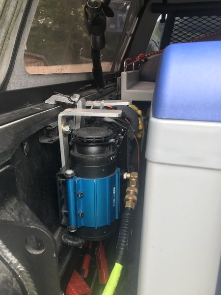

    ARB Twin compressor is mounted to the rear DS bedrail with two scrap aluminum pieces bent to provide protection above the unit.
    ARB Fridge/Freezer is mounted to the rear DS for better access to contents without opening the swing-out. I originally mounted it on the PS, but the rear mounted spare was in the way of easy access.
    Two wood boxes were originally from my daughter's school project a few years ago. I replaced the piano hinges with beefier utility hinges and added pull down latches. They contain my stove grill combo and other cooking paraphernalia.

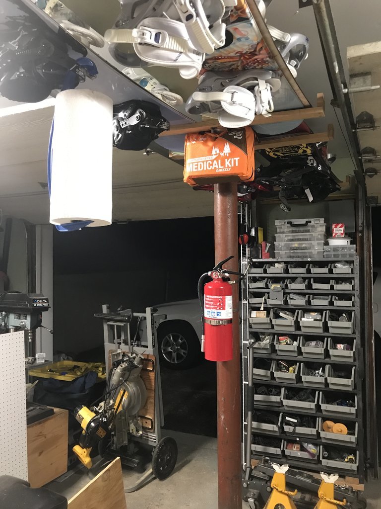

    Improved the safety factor in the garage a thousand fold.

    Where is the electrical tape to go with the paper towels, I mean emergency bandages?

    is it safe if you cant reach it?

    It's a yank down quick release. Everyone in the household can reach it.

    For gushers, use the whole roll AND bungee cord (actually, the paper towel roll is the backup.)
    In the trauma kit, your go-to is the battle compression dressing and quick clot :thumbsup:
