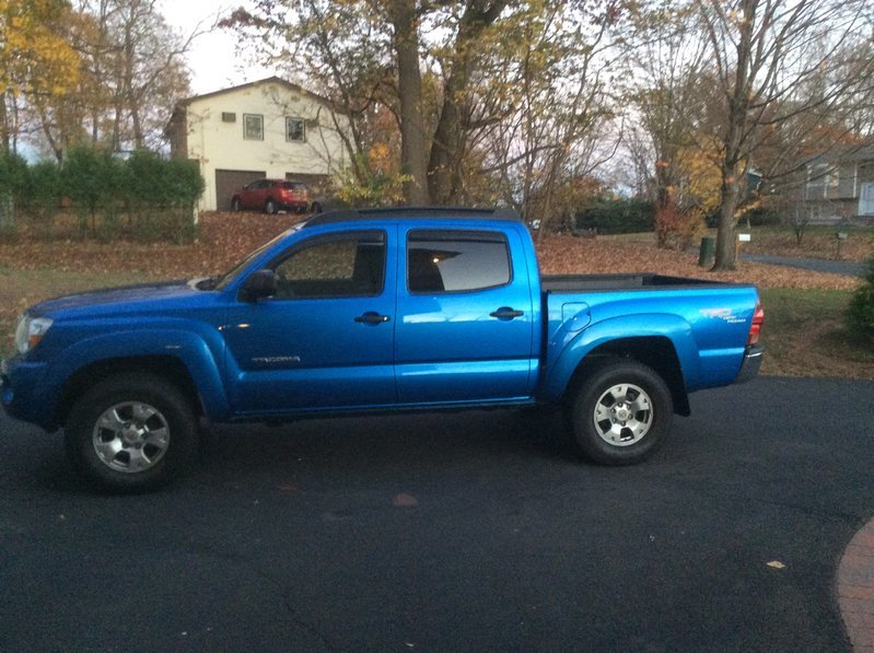

    Toyota Tacoma 2005 TRD OR DCSB, 4.0L V6
    Ordered early 2004 and took delivery late 2004.Ordered everything possible at the time: ABS, VSC, DAC, JBL and other acronyms that I thought I might need. Paid $200 over invoice.
    Was about to sell the truck in 2015 because the frame was all rotted from the salt laden winter roads of the Northeast (moved from Seattle to NY in 2007 for a job) but found out about the frame replacement campaign. After frame replacement, I fell in love with the truck all over again.
    Never took a picture of the damn truck for 11 years. Didn’t know that was the “in” thing to do LOL.
    Here’s the oldest pic (just prior to the frame replacement) November 2015

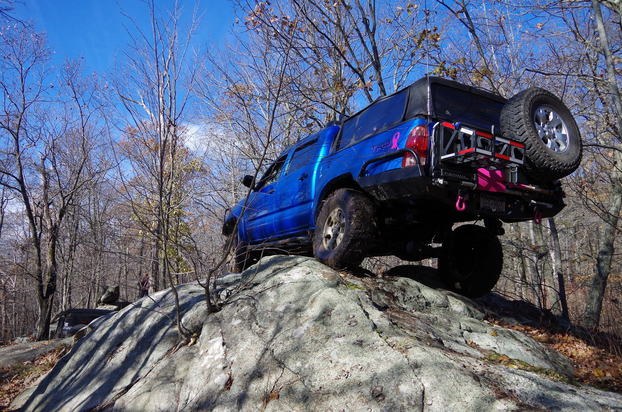

    Rausch Creek, Nov 2016. Photo Credit @MY50cal

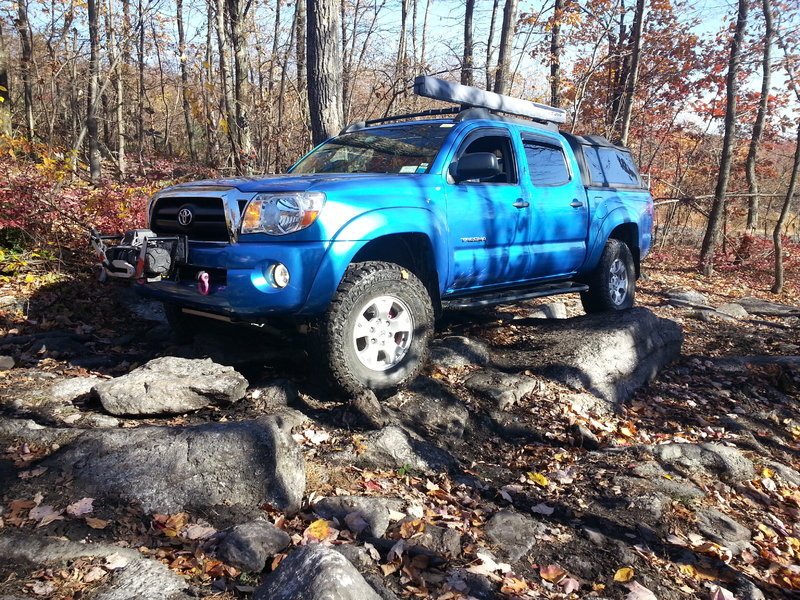

    NNJ, Jan 2018

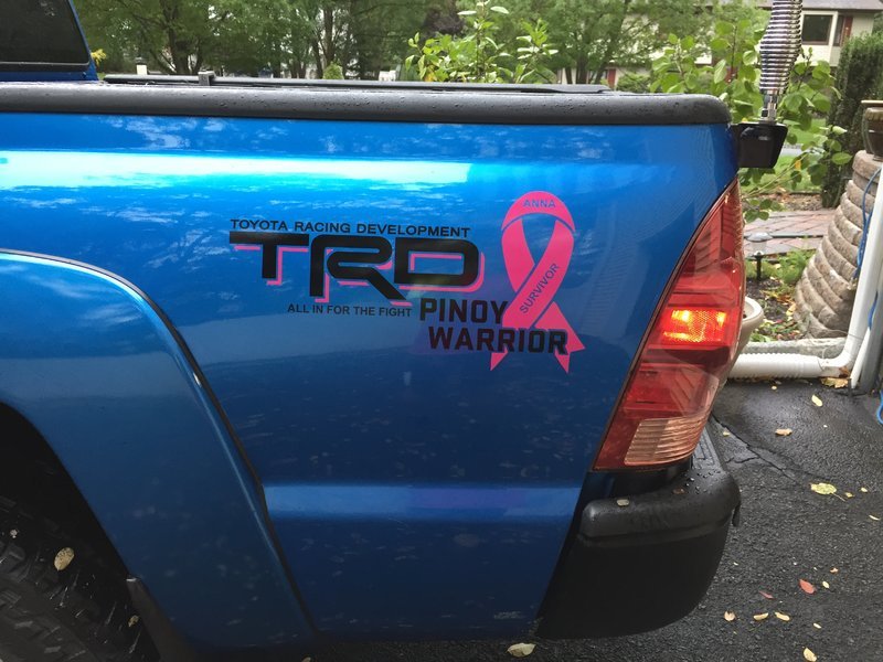

    My best friend, my wife, is the love of my life. She beat the hell out of breast cancer that we discovered over three years ago.

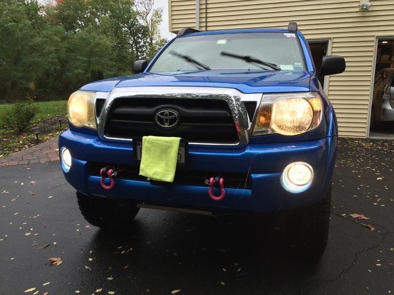

    I pinked out the truck this October. Check it out:

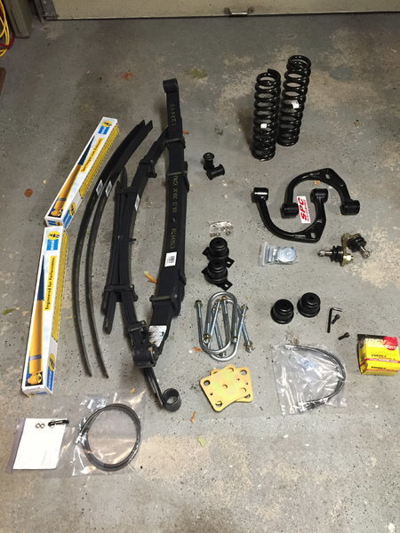

    Slowly starting to install the stuff that's starting to accumulate in the garage:
    It's like a giant puzzle.

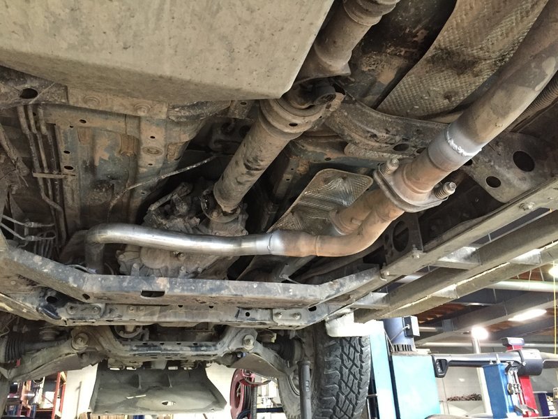

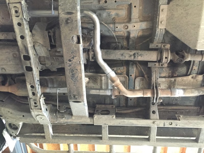

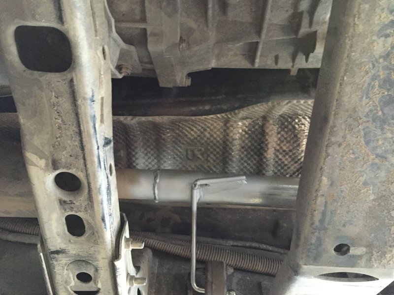

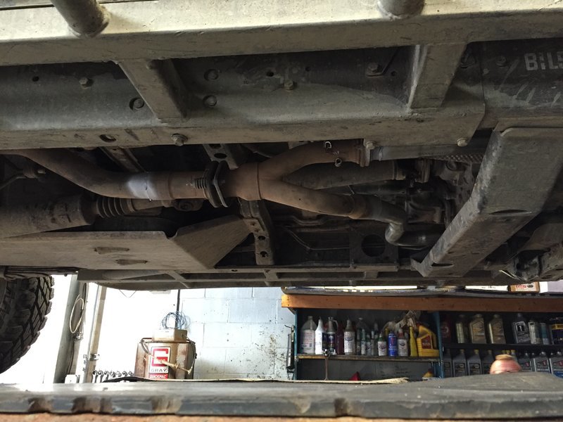

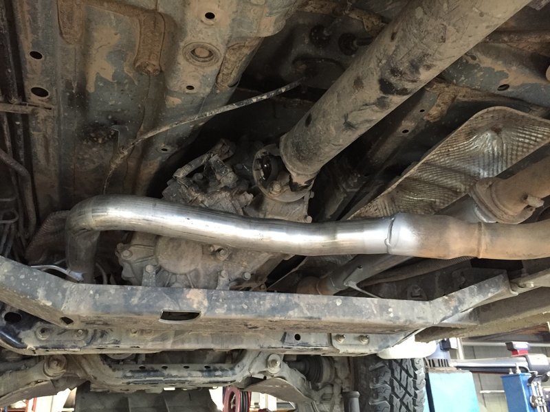

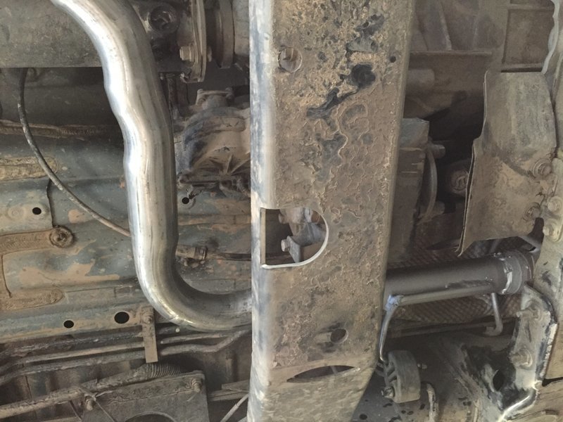

    Got my exhaust rerouted. Brandon at Manbeck's in Schuylkill Haven PA did a fantastic job! Thanks @stairgod for arranging this and hanging out with me!
    This is where the pipe used to run under.
    Who's Mohawk is peaking out of the lift deck?

    Happy to help you out with the exhaust reroute. Always great hanging with you.

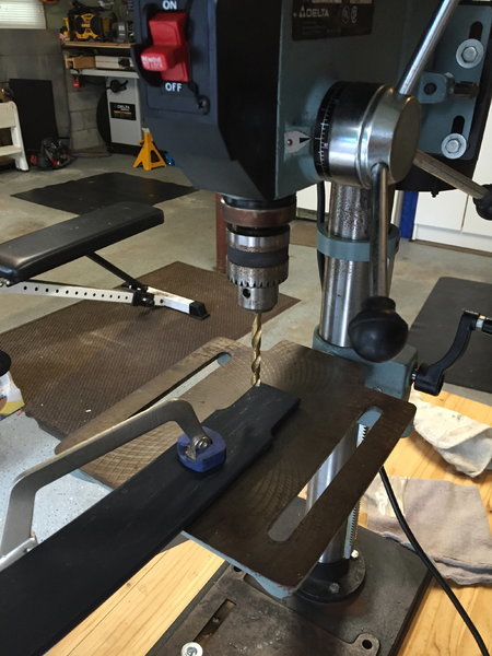

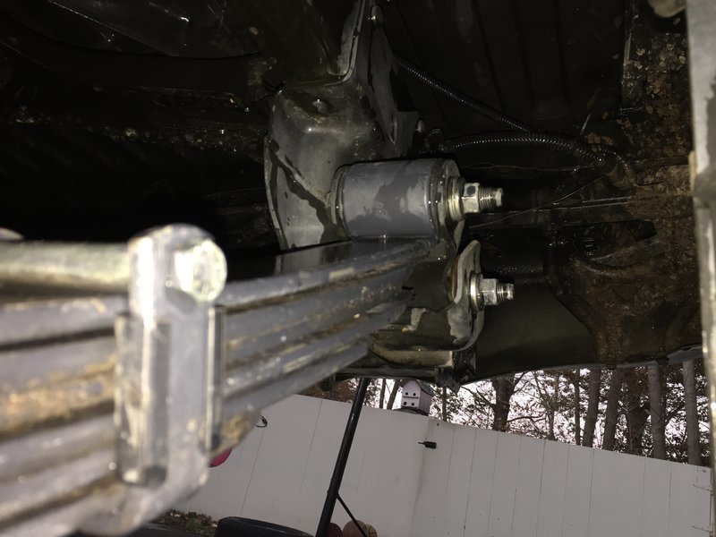

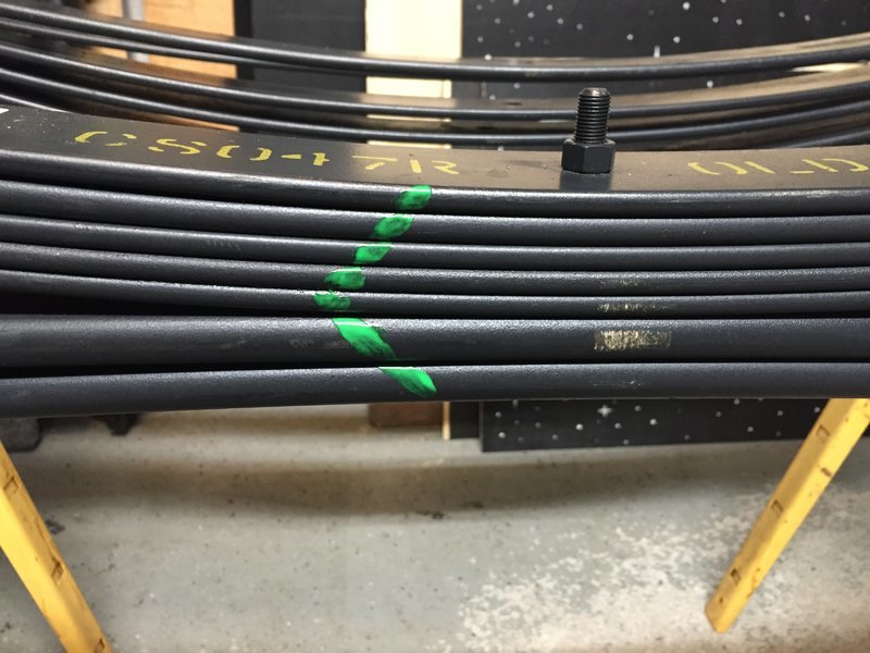

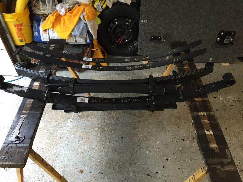

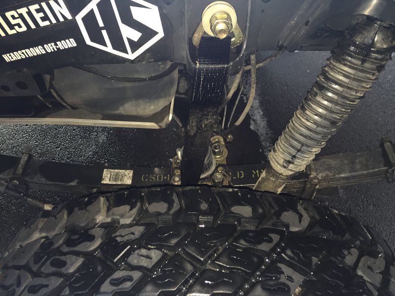

    Rear OME Dakar's with 29XL AAL, Overload delete.
    Installing leaf isolators using Squeaky Dakar thread as a guide.
    Painted reference marks on the leafs to make sure I get them back on correctly. I used green nail polish for driver's set. Pink nail polish for passenger side.

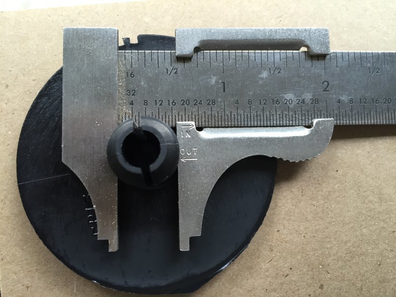

    Verified holes that need to be drilled are 1/2"
    Drill press was helpful

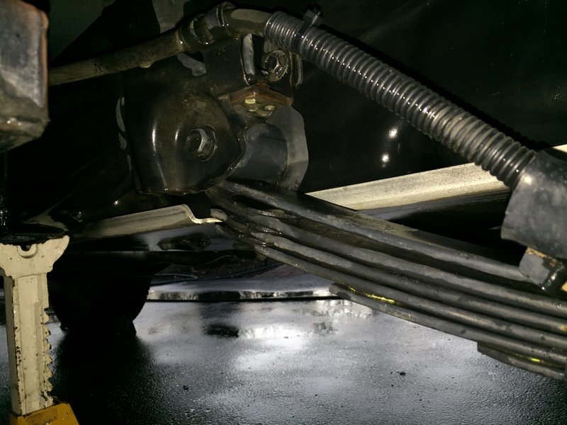

    Isolators installed:
    Internal view.
    Full droop:
