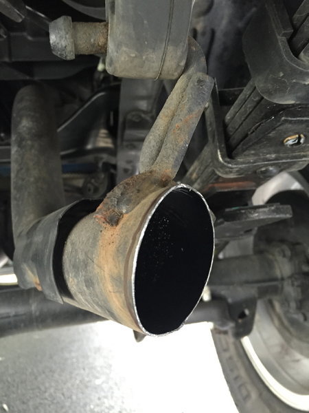

    Awesome! Your pics are great, good to finally "see" your truck.
    Exhaust reroute looks great!!!

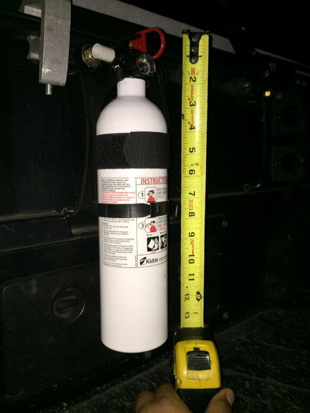

    Always gotta have a Fire Extinguisher. This is a Marine/Auto B-C rated one that I bought at Home Depot.
    This is installed on the driver's side bedrail using the included mount attached to a Bed Rail mount that I bought used on TW.

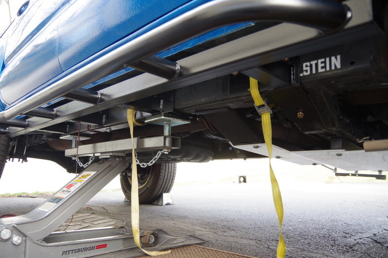

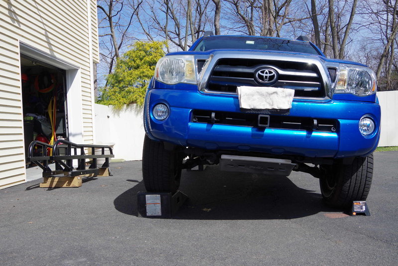

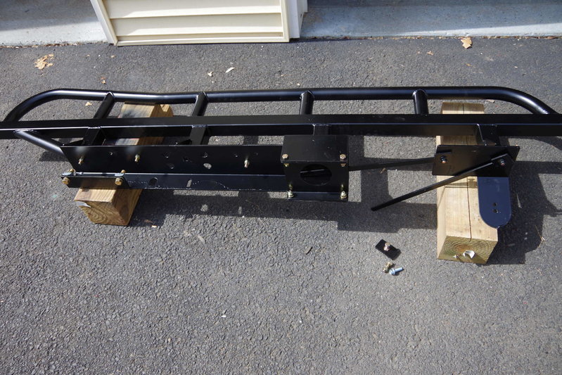

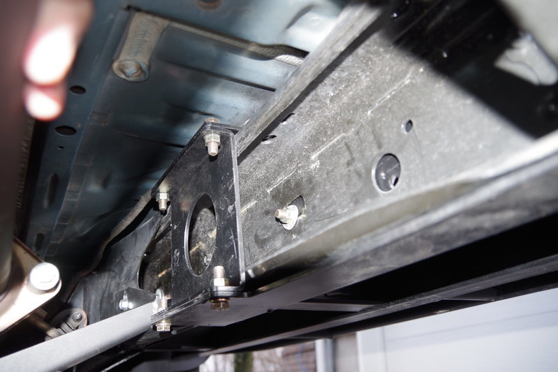

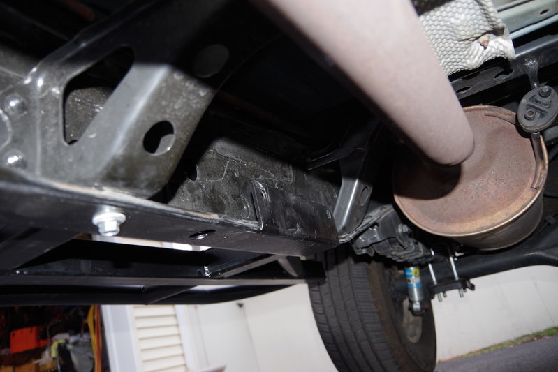

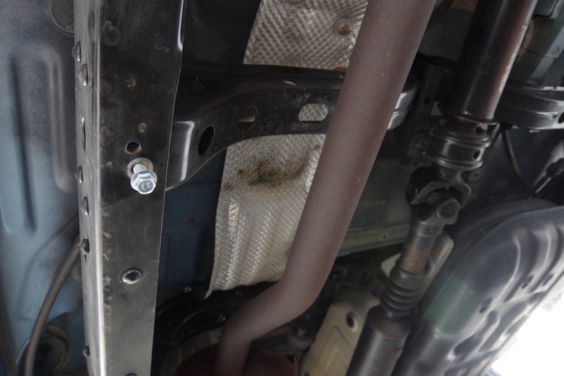

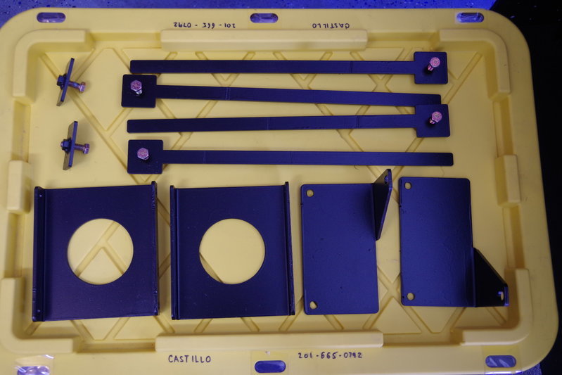

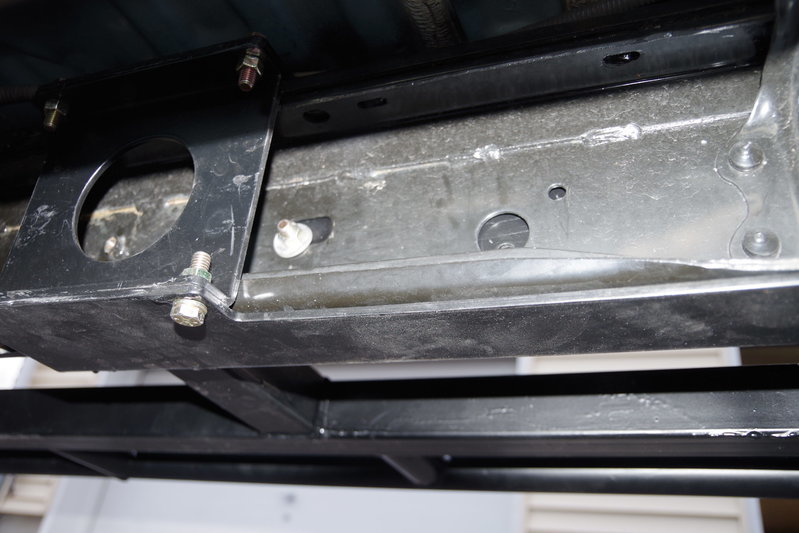

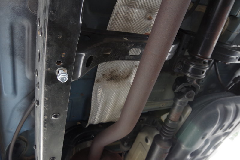

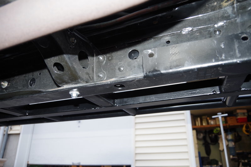

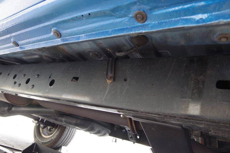

    @Mobtown Offroad Bolt-on Slider installation. Sometime in the spring of 2016

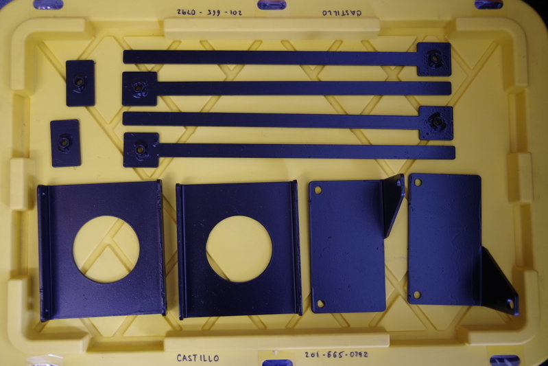

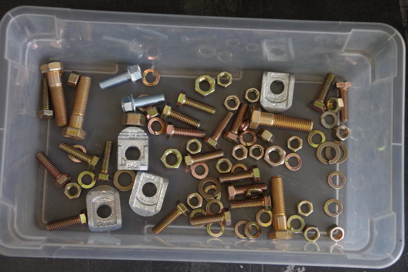

    Nuts and Bolts inventoried

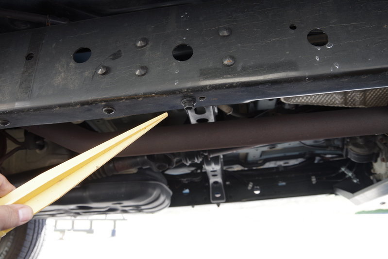

    Don't forget to check for these if you have an earlier 2nd gen. The beam clamps won't work for my '05
    Make sure you look for any bolts and protrusions on the frame before you jack the heavy bastards up into the frame. You DO NOT want to bring it up and then have to bring them things down again.. and then back up again.
    I used a Jack with optional side extension arms. Also used cam buckle straps as an extra safety measure. Did I mention these things are heavy?
    Crom and Tatts521 like this.
  7. Nov 10, 2016 at 6:04 PM
    #27
    Mobtown Offroad
    Mobtown Offroad Boss
    Jul 23, 2014
    #134511
    10,797
    Joe
    Harrington, DE
    2002 SR5 4Runner
    Dude, how you held them up to the chassis is literally the most simple and effective way I've ever seen and now I feel dumb for not doing it. They're a (insert bad word here) to install alone. I do it often haha. Nice tip!

    Yeah, it was pretty easy to bring the damn things up against the frame. The only reason it took more time, is that I used the safety straps. As I brought it up a few inches, I tightened straps a little more. Jack up, tighten straps, repeat.
    The whole goal was to save the freshly painted sliders from scratches.
    Scratches aren't really an issue anymore Haha

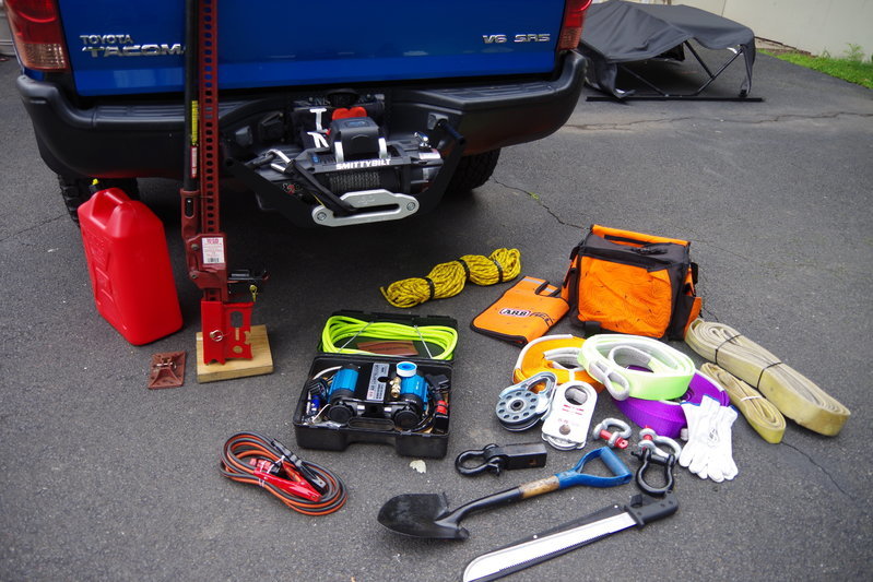

    My recovery gear:

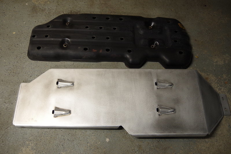

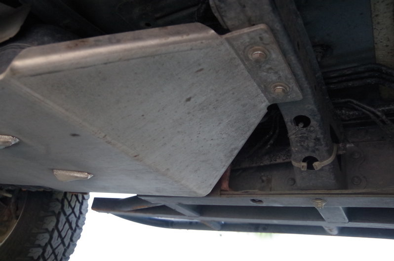

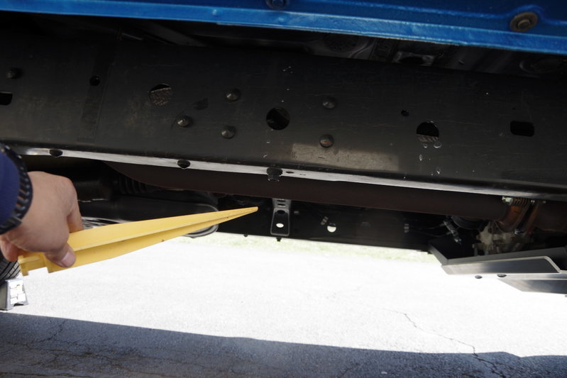

    Side by side comparison of the OEM plastic gas tank "protection" vs. the @Pelfreybilt gas tank skid:
    I like how the front of the skid bolts onto the frame crossmember vs. others that simply float underneath the gas tank, held by the OEM tank straps. Also like how the attachment bolts are protected by the welded on "triangles."

    That is the only skid on your truck that is not FUBAR.

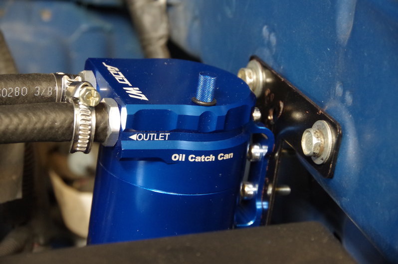

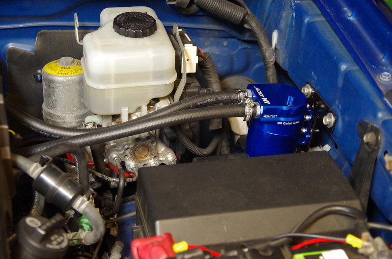

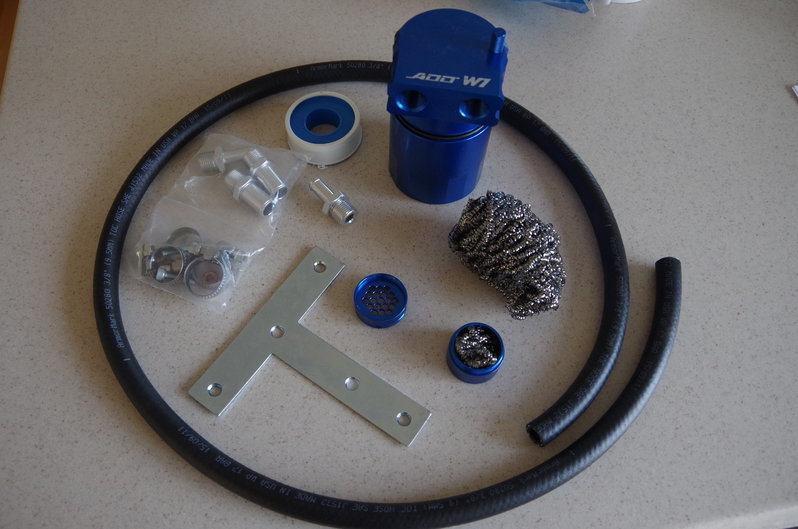

    Here's my ADD W1 Oil Catch can install:
    Reserved for oil in bottle pic

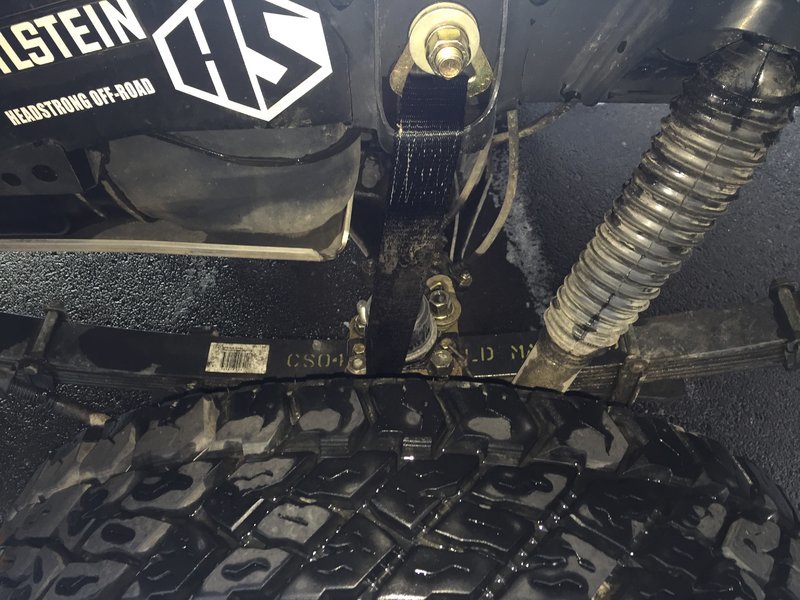

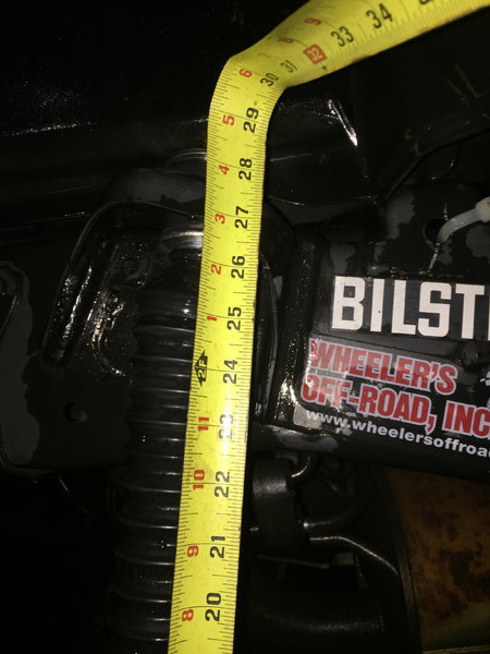

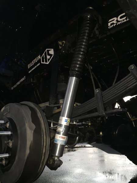

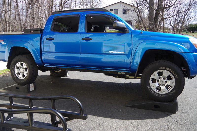

    Rear Bilstein B110's installed:
    Published extended length of these shocks are 27.28"
    Guess where I'm at?
    Crom likes this.

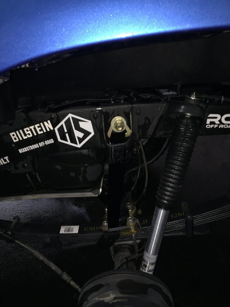

    Jury rigged "axle limiting strap" to limit droop to prevent over-extending the new B110 Bilstein shocks and yanking off the stock brake lines. Extended brake lines are due as soon as I can break apart the flare nuts on the hard lines.
    Almost reached the 27.28" extended limit of the shocks, even with the "Axle Limit" strap. About a half inch to spare.

    I cant believe you have limit straps. I need to measure my rear travel somehow..
  20. Nov 13, 2016 at 7:04 PM
    #40
    Subway4X4
    Subway4X4 [OP] Shameless Copy Cat
    Nov 10, 2015
    #169260
    11,652
    Lloyd
    NY/NJ
    05 Speedway Blue DCSB OR TRD
    Everything TW members recommend
    With the Dakars+AAL and the Bilstein B110's, I should be OK without the limit strap. The strap is basically to prevent the OEM length brake lines from yanking apart. This is why I have only have a limit strap on the rear driver side. The passenger rear is strapless.
    Once I get the extended lines installed, the strap goes away.
