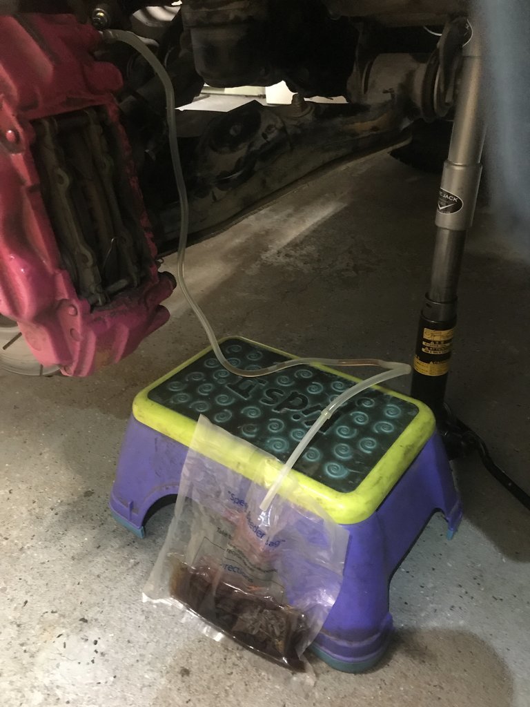

    Who cares if you spill some? Put a pan under it Floyd lol

    Well, I be doing this little brake project tonight after dinner and dessert.
    New line will be ready.
    Yes. P/N 47318-04150 (Drivers side front)
    Pan at the ready.
    I try the easiest first. This is it.
    The good news: I saved the vacuum cap that you suggested awhile back.
    The bad news: I saved it with my new brake line. I can't find 'em.
    EDIT: Found
    Apparently you two are agreeing: Air present in the system equals no brake fluid in same system.
    To mitigate this, I've added a lot more brake fluid.

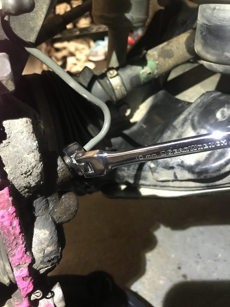

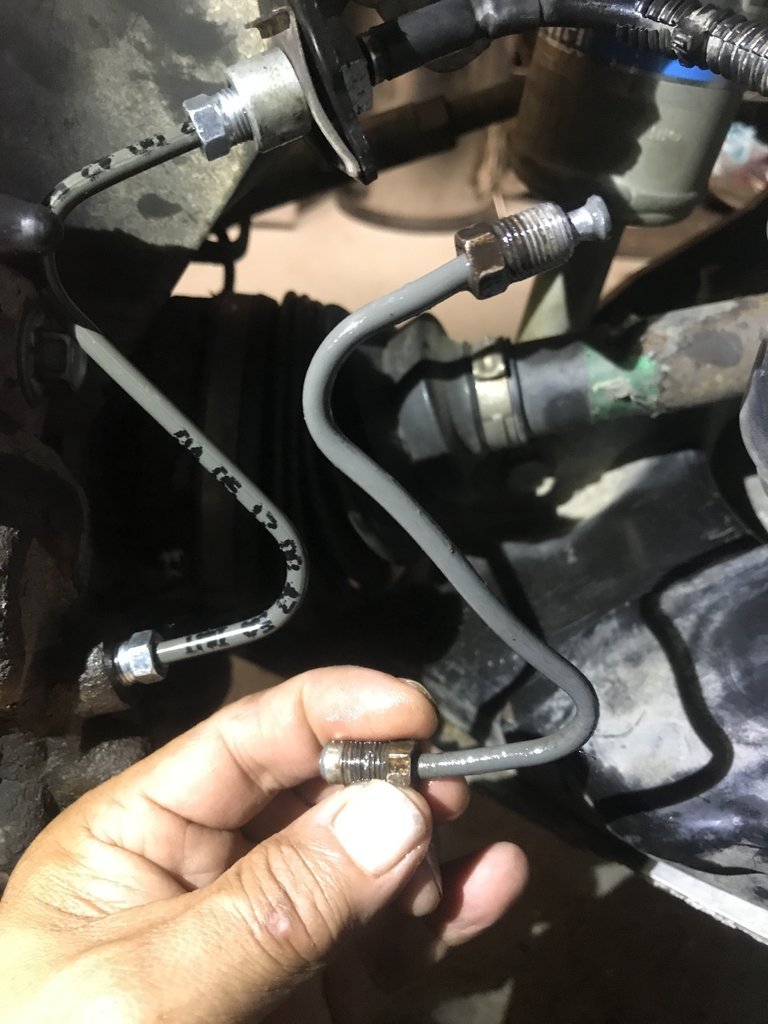

    Another thing I learned. Thanks TW!
    Got to use my fancy flex head flare nut wrench (didn't really need the flex part.)

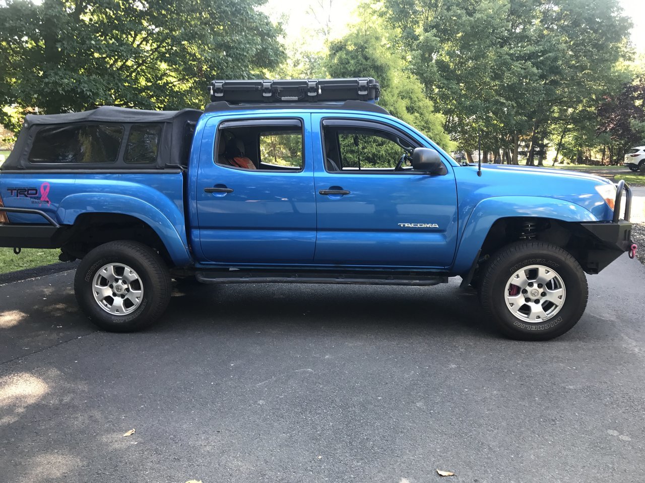

    Truck still looks good with 265/70R16 Michelin LTX's
