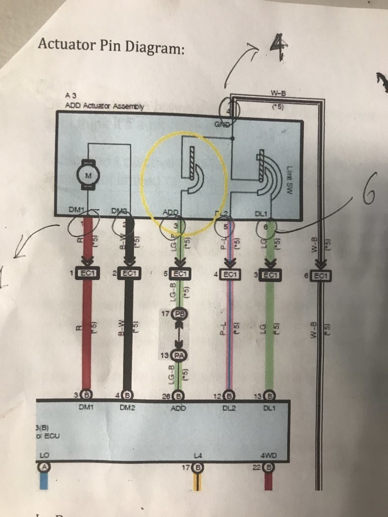

    So, this is the electrical check process?
    1. Switch to 2H
    2. Unplug and check pin continuity based on diagram.
    3. Switch to 4H
    4. Unplug and check pin continuity based on diagram.
    5. If wrong, open cover, re-adjust gear timing.
    6. Switch to 2H, then back to 4H
    7. Unplug and check pin continuity.
    8. If wrong, open cover, re-adjust gear timing.
    9. Continue until pin continuity checks ok.

    Electrical continuity checks are good.
    In 2WD
    Confirmed NO continuity between pins
    3 and 4
    3 and 5
    Confirmed YES continuity between pins
    4 and 6
    In 4WD
    3 and 4
    3 and 5
    4 and 6

    Looking at that diagram, 6 is labeled as ground, 4 is DL2, 3 is DL1, and 5 is ADD. I don't think 4 should have continuity with 6 in 2WD. @jowybo ?

    Not sure you're looking at the same diagram as me.

    I think you're looking at the pin #s wrong Murph. #4 is ground. 6 is DL-1, 3 is ADD.
    I circled the pin #s in this pic. And labeled 1, 4 and 6. I didn't label 2, 3 and 5 to avoid cluttering the diagram.

    I remember now. I actually took a pic of the gear assembly before I took it apart last week. Then returned everything to its exact timing position.

    I was starting to suspect that we were using different numbers, which is why I added the labels to my post. I was using the numbers by the ec-1 boxes. This clears up my confusion that started last night. Sounds like the ADD is good, thanks for translating Lloyd.

    I'm glad I did this exercise. It completely rules out the ADD actuator as a problem.
