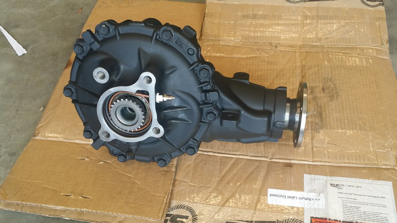

    ECGS sends the clamshell with it pre installed, that's why they ask what yeR make and model it's going in. No need to change them over.

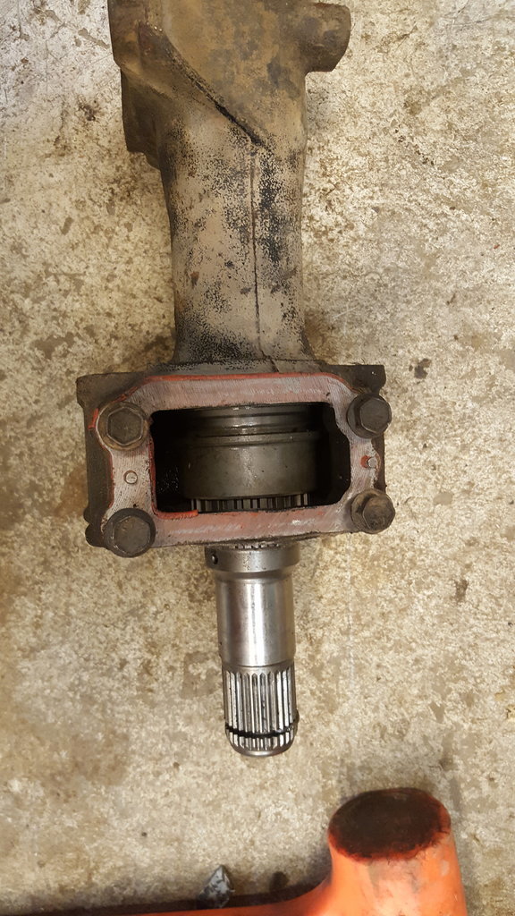

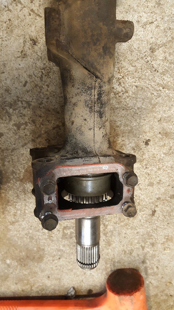

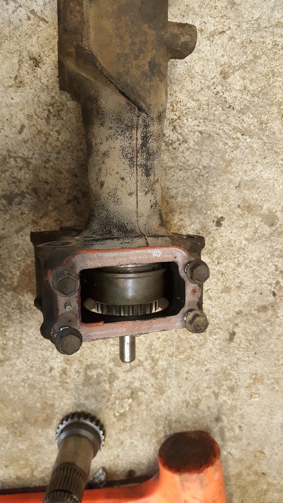

    The stub shaft is not turning at all, it's not a matter of whether or not the collar is engaging it, you should be able to watch it spin when you've manually pulled the collar off the stub shaft but have 4wd and locker on. Lloyd doesn't have that. Collar off stub shaft, the stub shaft still isn't moving when the driver side is turning

    R u kidding? The stub shaft needs to be removed from your old clamshell and reinstalled in the new one. ECGS does not send one with it.

    Freshly opened from ECGS ^^^^

    I got mine in May. No stub shaft. @M192 did his in August. No stub shaft.
    Steve and Tim had no stub come with theirs either.
    Idk what the hell is going on with ECGS. In their instructions they tell you to remove the stub from your clam and reinstall on new one.
    Anyway, Lloyd, I have a spare stub shaft if you need it.
