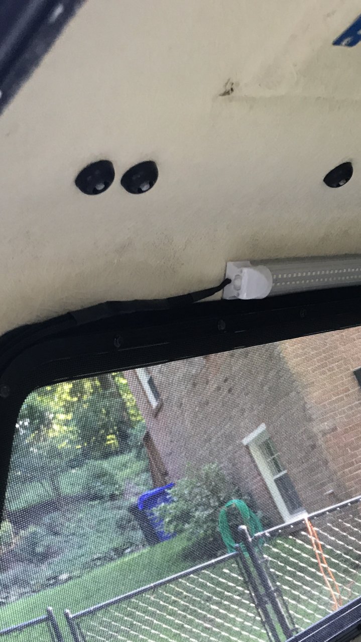

    Heres a few pics of the mounting on joes old cap, back when it was mine. It was these special washer things that also held the nut in place.

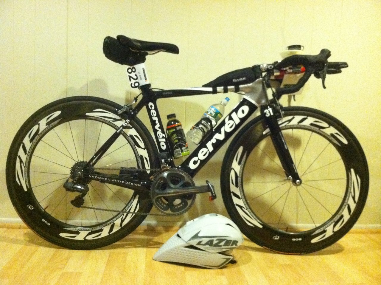

    Not imagined.
    I was thinking about carrying my $$$$$ bicycle on top.
    But the CF handlebar, CF wheel and the spokes do have an airfoil cross section :)
    Because I lost the option of securely mounting on my bed.

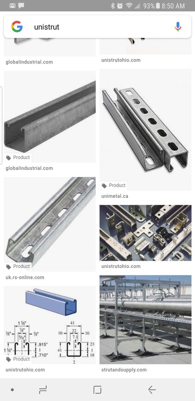

    NY/NJ
    05 Speedway Blue DCSB OR TRD
    Everything TW members recommend
    What’s ELECTRICAL STRUT?
    What’s UNI-STRUT?

    Home Depot electrical section by the conduit. 10 ft lengths two different thickness 7/8 and 1 3/4 I think. Around 20-25$ for the 7/8.
