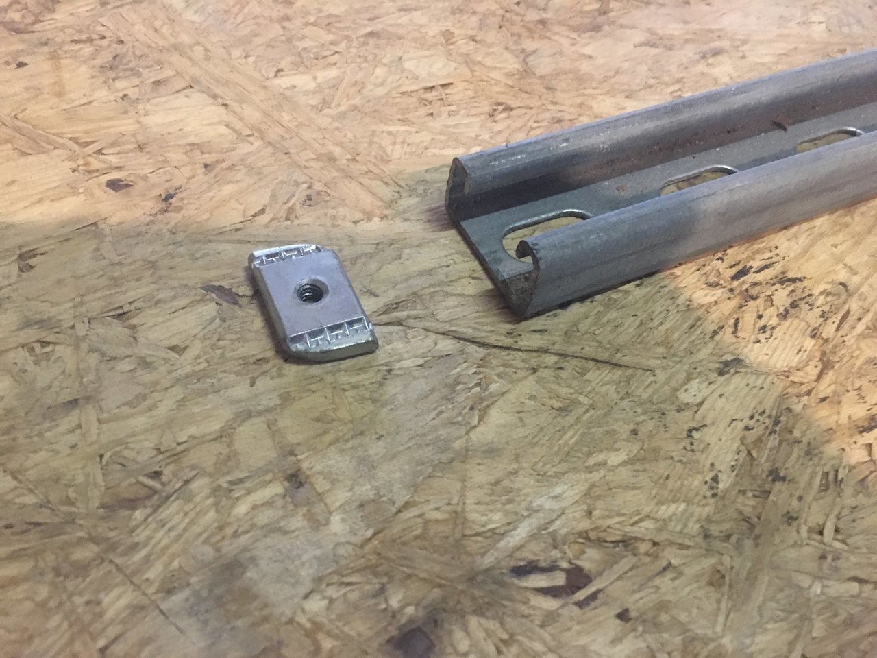

    It's very sturdy. I built a rack for my old cap out of it.

    These nuts usually have a spring on them and slide in the strut.
    I removed the spring to use in my bed rails. If you cut them on the lines they fit in the notches on the bed rails and can't move for and aft.
    If you get some check each bag for size bolt and number in bag. They always get mixed up.

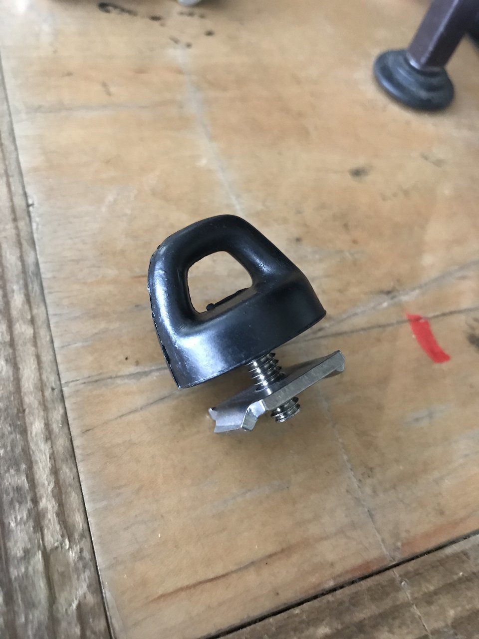

    Thanks. Great idea. I’ll check HD today.
    Or I might just get another set of the same aluminum rails for this. They have the nice adjustable tie downs that I can use on the roof top and now possibly down below.
