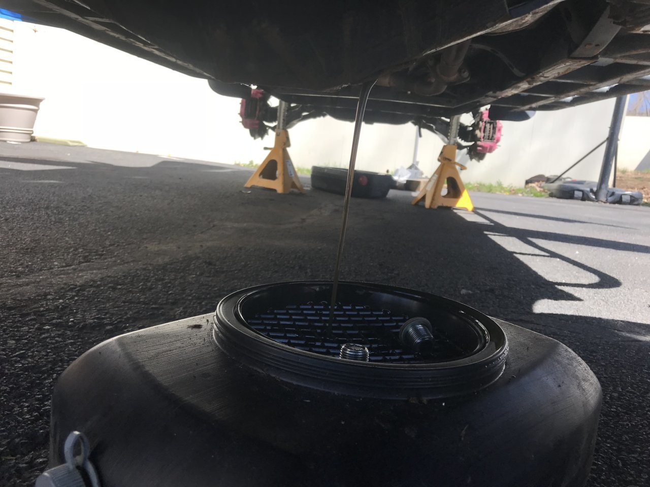

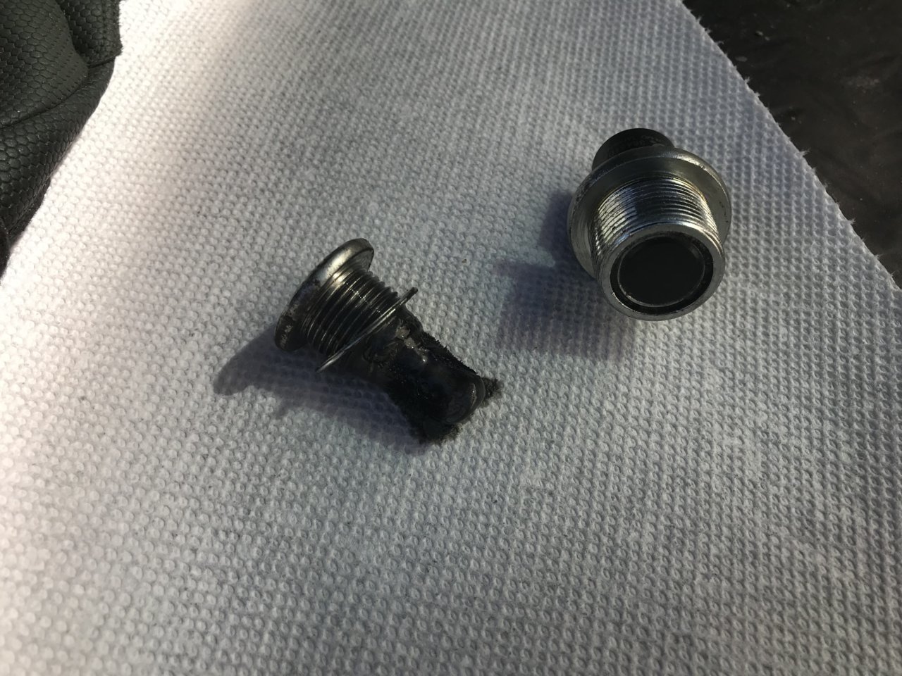

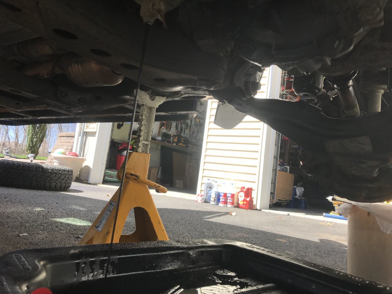

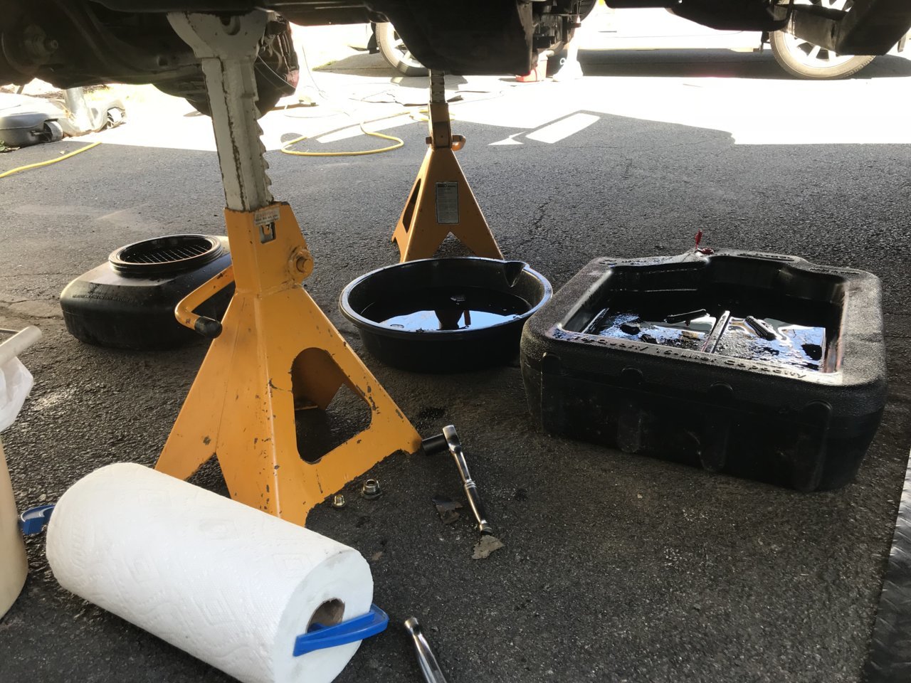

    Annual Spring fluid change.
    Front/Rear Diff
    Transfer Case
    Tranny
    Engine Oil
    7400616A-9D90-4D46-A2CB-CE9A1EE20C45.jpg 9289A7F8-D6B8-4455-9CD6-0C36B5B37DD3.jpg A937F80E-8472-4B23-A90B-7613DFB60FD6.jpg 6333EFC6-3D82-40B4-8AD6-058BCB214E72.jpg D64FD391-BCA1-4CB4-8828-A1A59EF99B5B.jpg

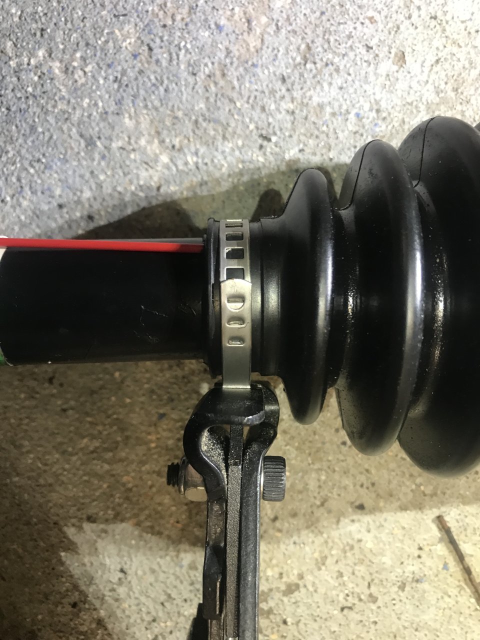

    What’s the consensus of how much to slide down the inner boot collar? 3/4”
  5. Apr 29, 2018 at 7:26 AM
    #1085
    stairgod
    stairgod NOOB
    Aug 16, 2015
    #161924
    7,965
    Jo n
    PA/NJ
    2011 MGM Trail Limo
    Locked Boosted 35s
    Did you save the end of the old boot? Typically that is clamped in the regular groove and the new boot rests against it.

    Yeah. That’s what I did.

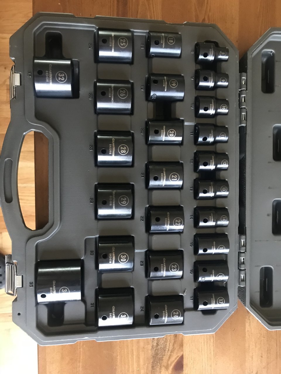

    GearWrench is my go-to for mechanics hand tools nowadays. Chromoly steel, excellent fit and finish. Mid-price point.
    I’m slowly replacing my chrome vanadium stuff that I’ve accumulated over many years. I still have the no-name set that I bought at the swap meet 35 years ago at the Jack Murphy Stadium in San Diego. The 24 mm socket finally blew apart last week. Had to borrow my neighbor’s 24mm shallow. Which led to the purchase of this nice 1/2” drive metric shallow impact set.
    Which complements this 1/2” drive metric deep set I purchased 2 years ago.
    And this 3/8” drive metric/SAE shallow deep set acquired last year
    I should be good to go for our family fleet of three Toyota’s.
    Note the Torque Limiting Extensions are not GearWrench
    Tibetan Nomad and Nimble9 like this.

    I love all my gear wrench stuff. I think for the price they are one of the best bangs for the buck. I am kind of a tool snob and have everything from VIM to Snap-On. Some of the Gear Wrench stuff I have I also have it in a "higher end" brand and the gear wrench is my go to. You'll be very pleased with your purchases.
    Don't trust the torque sticks. I have proven that they are not always accurate with air and electric impacts, too many variables. Always double check with a real torque wrench. They do work to a point but you can still over or under tighten with them.

    Yeah. The torque sticks get me close. I always pick the lower torque value. Then go down one more stick. Then it gets torqued by one of these Precision Intruments split beam torque wrenches.
