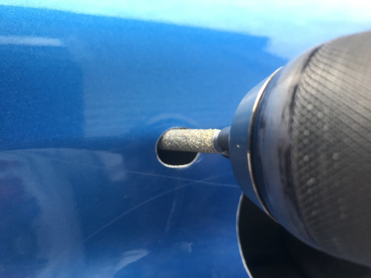

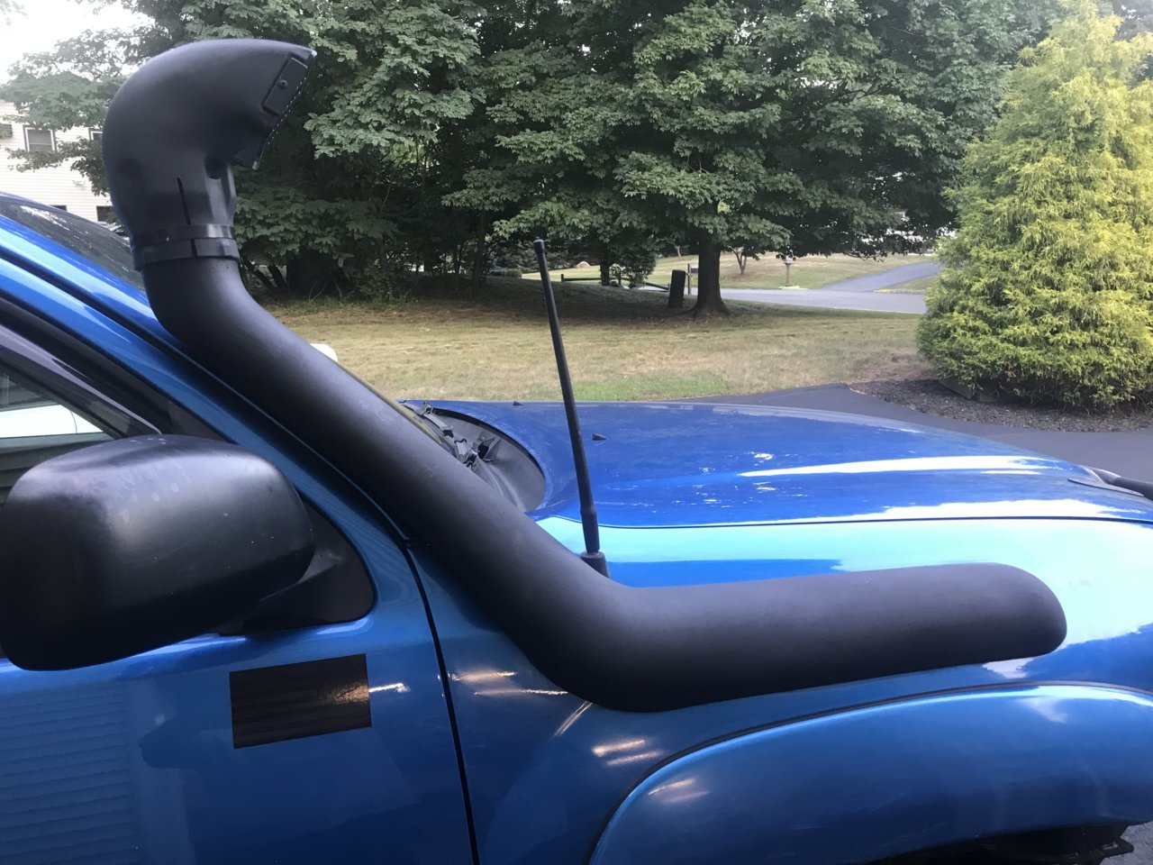

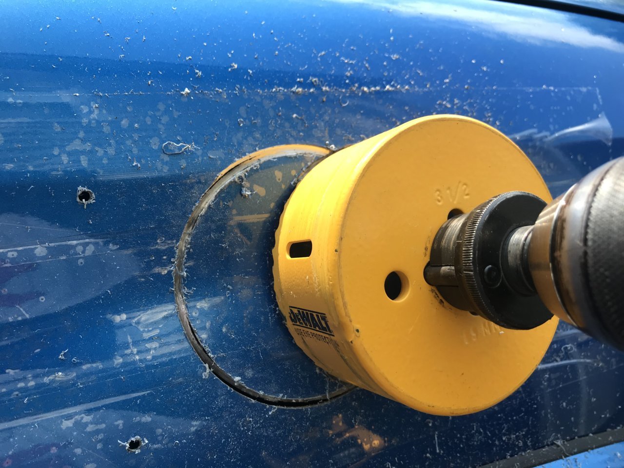

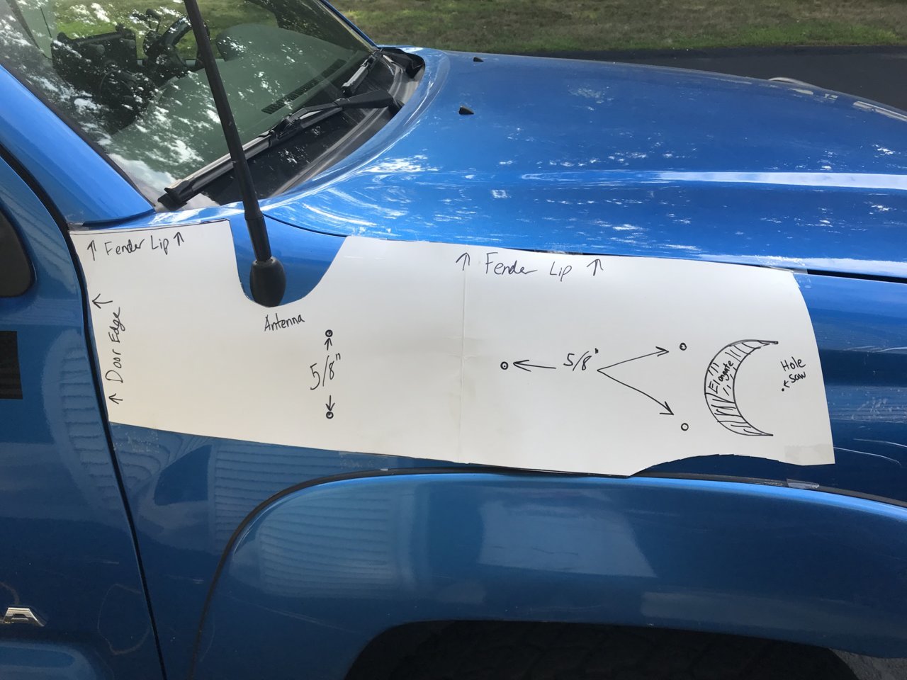

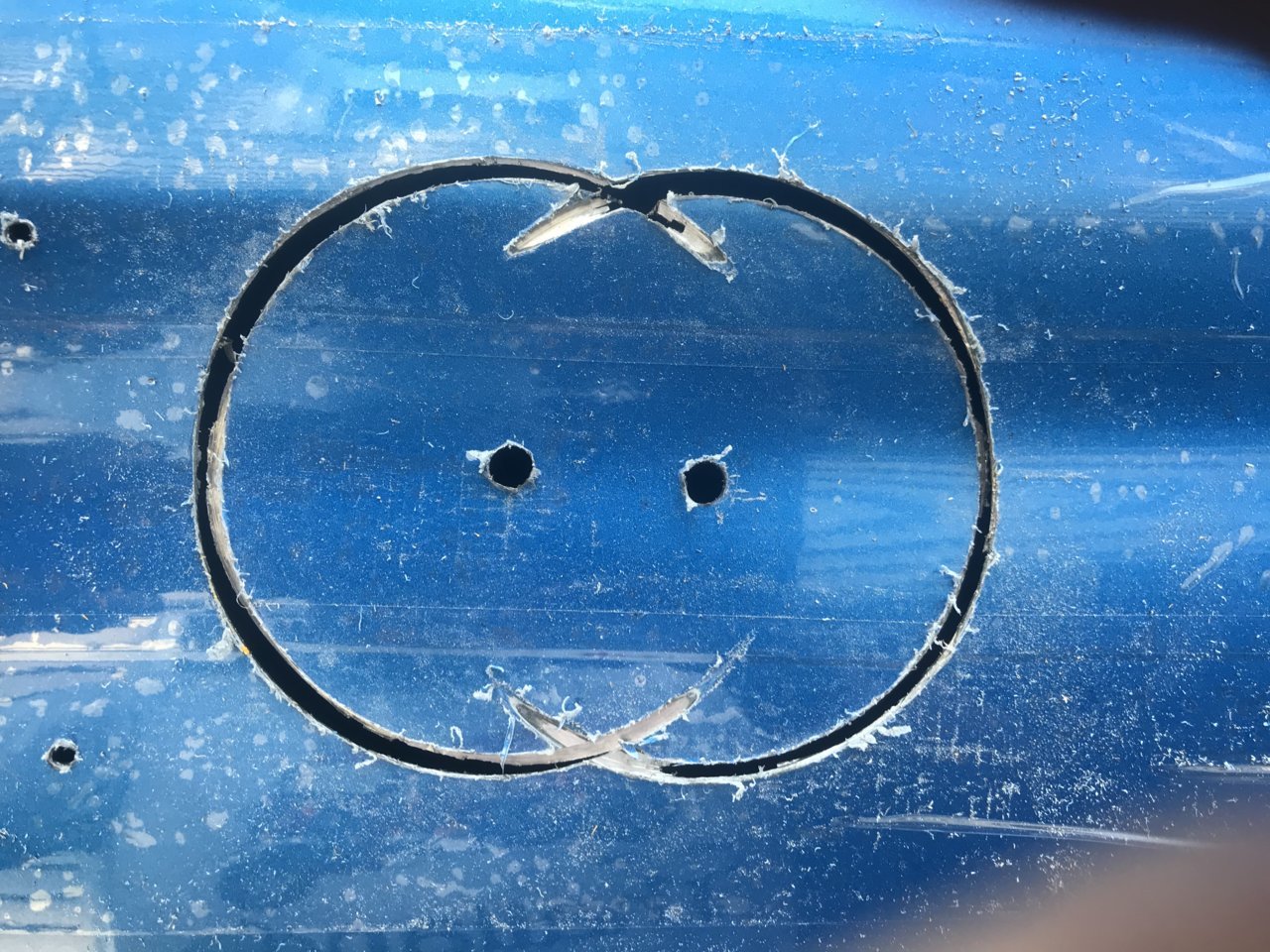

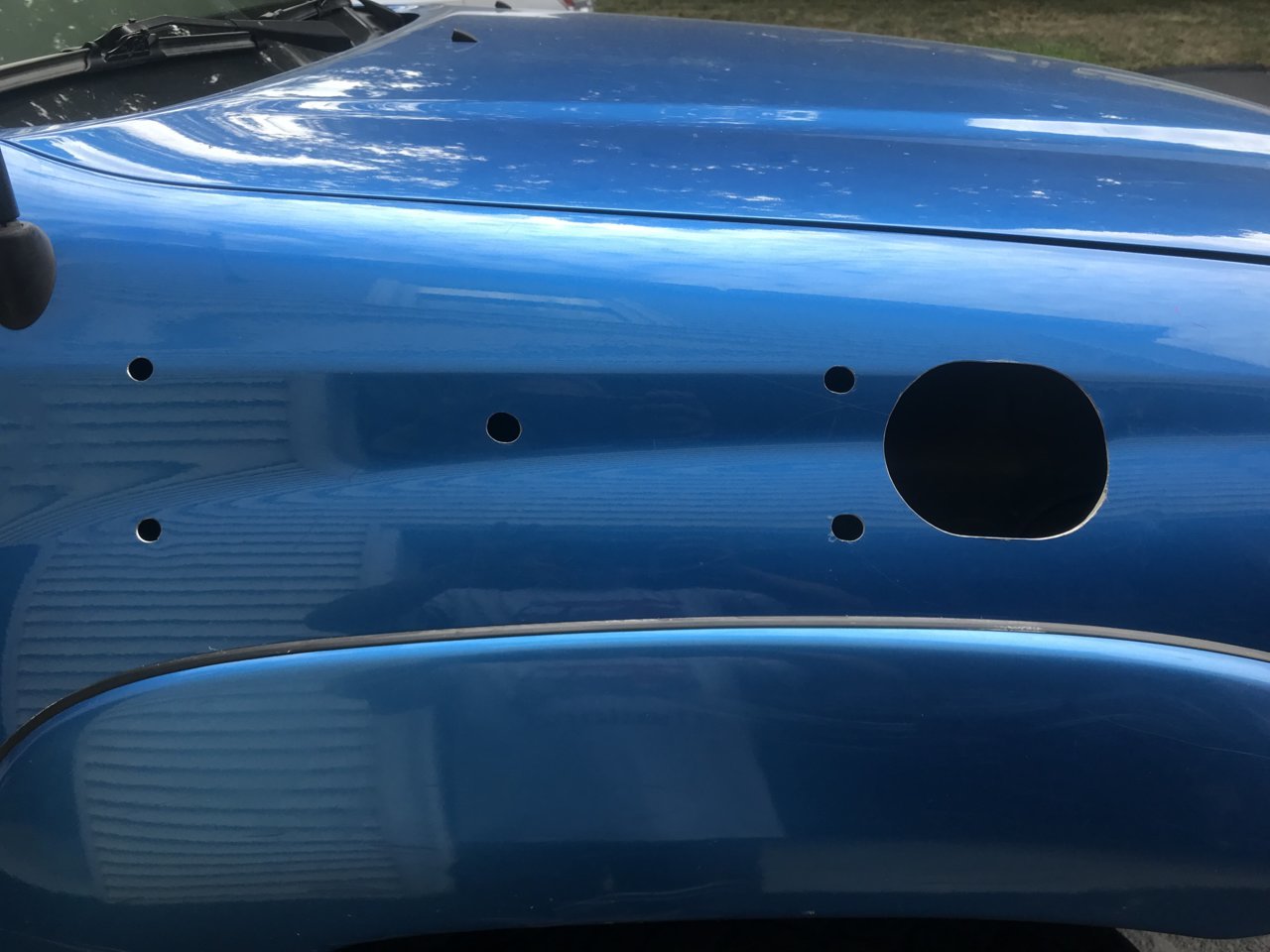

    Faux HiLux snorkel install.
    Followed @inesshell 's detailed install.
    And additional words of wisdom from @Nimble9
    @Wheelspinner 's template
    Hole saw
    Diamond coated bit to clean edges
    Beee yoooo teeee fullll...clean holes. Raw edges painted.
    Installed

    looks good :thumbsup:

    Yep.
    Angled and double drilled hole saw was a solid idea :thumbsup:

    Yeah. My dad taught me that little trick.
    It maintains your pilot holes throughout the process.

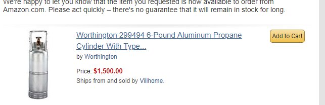

    lloyd im in luck, Amazon is hooking it up with a great deal :rofl:

    Grab it now before it hits $2k!!!!

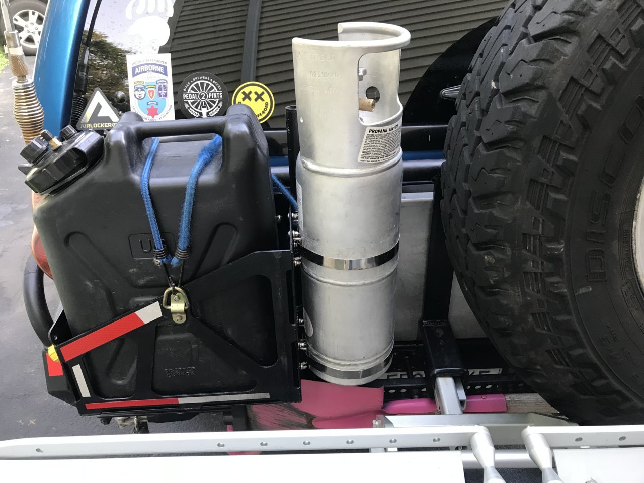

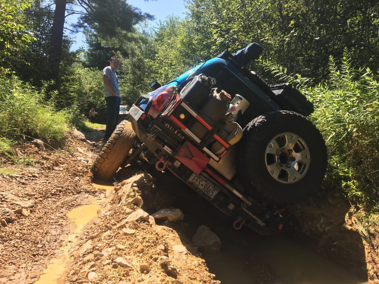

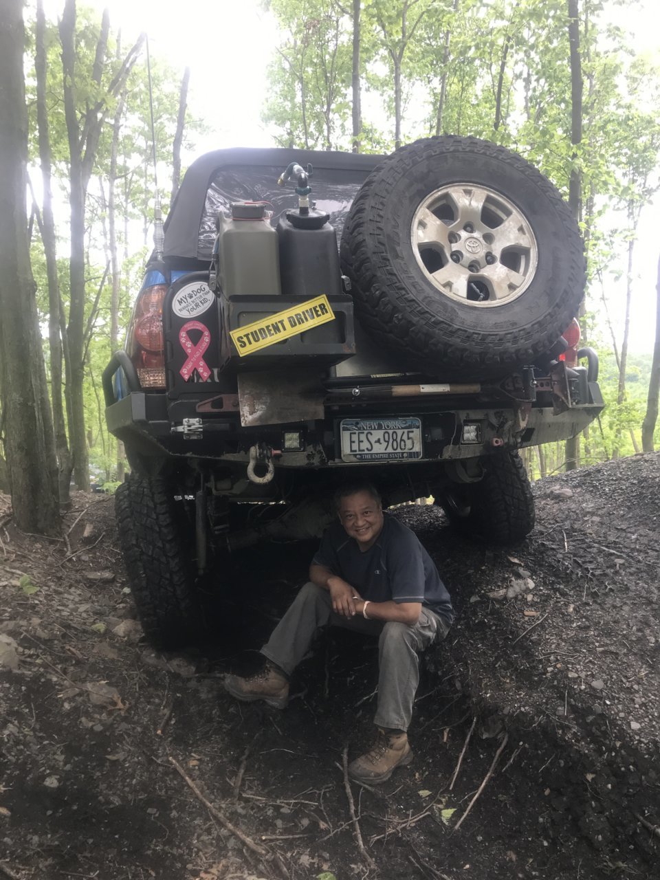

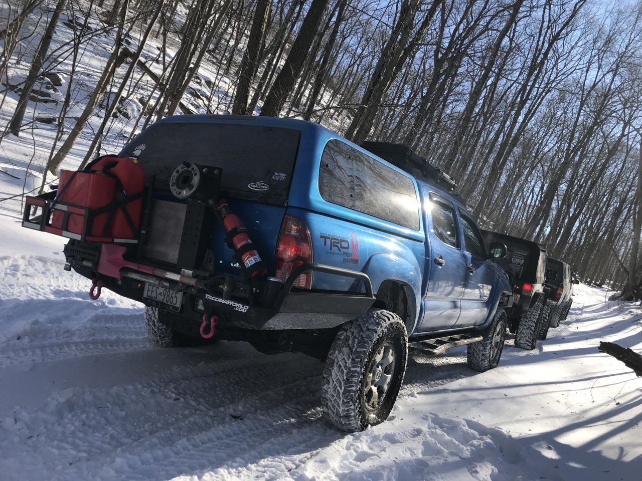

    Modular Fuel/Water Can system:
    I switch things around around as I learn and gain more experience.
    I have a dual and a single jerry can mount and I made it pretty modular. My BFF swingout has a metal plate spanning the horizontal and vertical tubing, so it allows me to drill holes where I want, then attach the holders via stainless steel hex socket bolts in any configuration I want.
    Dual only: Scepter Military Fuel Can (MFC) on DS, Scepter Military Water Can (MWC) on PS
    Dual and single: $13 Costco Gas Can and old metal jerry can with the top cut off to hold immediate need recovery gear (cuz... note that I'm with a heep in this pic.)
    Dual and Single with everything: MWC, MFC, 6 lb aluminum propane tank, recovery strap.
    Single, sideways. Which is what I now realize is exactly what I need for the NE off road parks like Rausch Creek and AAOA to improve my clearance.
