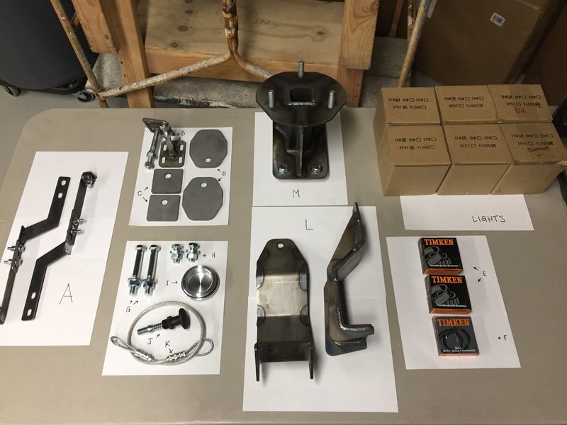

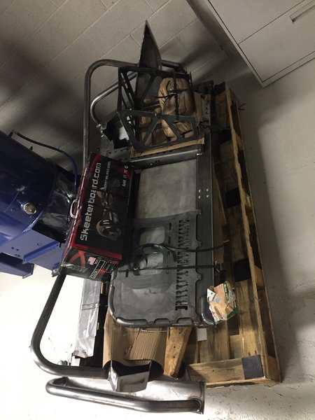

    Jigsaw puzzle has arrived.
    I might have to do this in the spring. Temps too cold for me.
    Pallet fit just between the wheel wells, with an inch to spare.
    Front Plate Bumper with standard winch mount, full hoops and dual pair LED Pod cut-outs and custom 2" receiver. Rear HC Plate Bumper with single pair LED Pod cut-outs, Tire Swing-out, Dual Can Fuel Carrier, Fold down table
    Small parts and hardware. Photographed and Inventoried.
    I'll try to document the installation.
    Feel free to identify the lettered parts and provide installation tips or tricks, cautionary input, etc.

    A: bed side side supports. Replace the ones you cut off when you do the bed sides. One side bolts to factory bracket holes. Other end clamps to bed sides.
    L: front bumper frame braces.
    C&D: front frame plates. Strengthen frame where the bolts go through.
    M: self explanatory.
    I don't have any of the other pieces.
    I: looks like a bearing cap.
    J: Spring latch for the swingout?
    K: Cable to support table when it's folded down?
    bski22 and Subway4X4[QUOTED][OP] like this.

    Those timken bearings are for the swingout. This is the order from the bottom to the top:
    Then "I" gets rubber malleted into the top of the swingout
    Tapered bearing
    Swingout
    Tapered bearing
    Seal
    Start reading from here, and go up
    bski22 and Subway4X4[OP] like this.

    For spindle component assembly do this:
    Insert greasy bearing into bottom of gate (cage) taper side up,
    Then tap seal in, Rubber seal with long rubber part down,
    then hang gate on bumper spindle.
    Then install second greasy bearing with taper side down,
    washer,
    nut, You'll need a 1-7/16" socket. Tighten, so gate opens with slight resistance.
    screw aluminum cage lid on by hand, it's threaded, do not use a rubber mallet to hit as someone else suggested.
    Visual representation of what it looks like with seal and first bearing.
