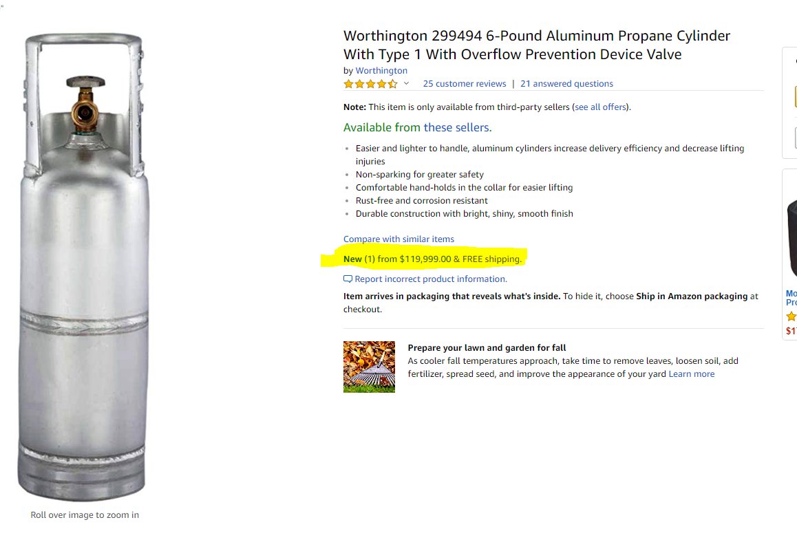

    Maybe we can get Amazon to bring the price down to $118,999.00

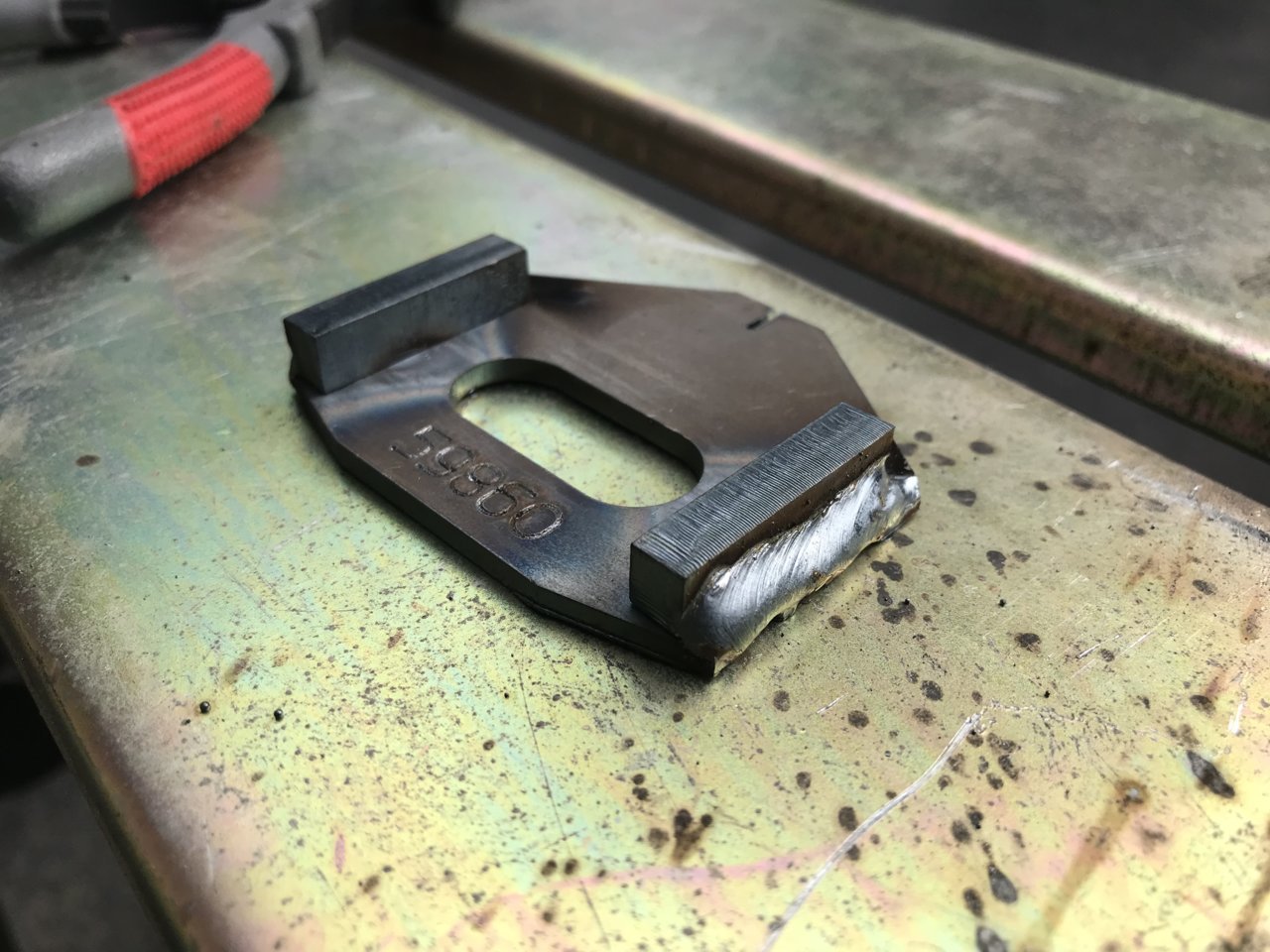

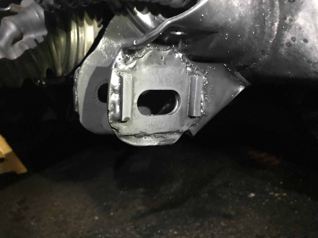

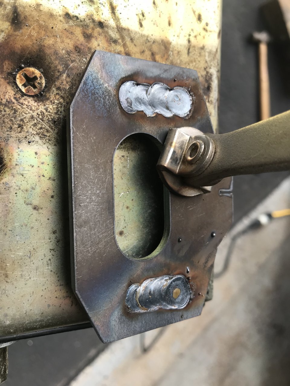

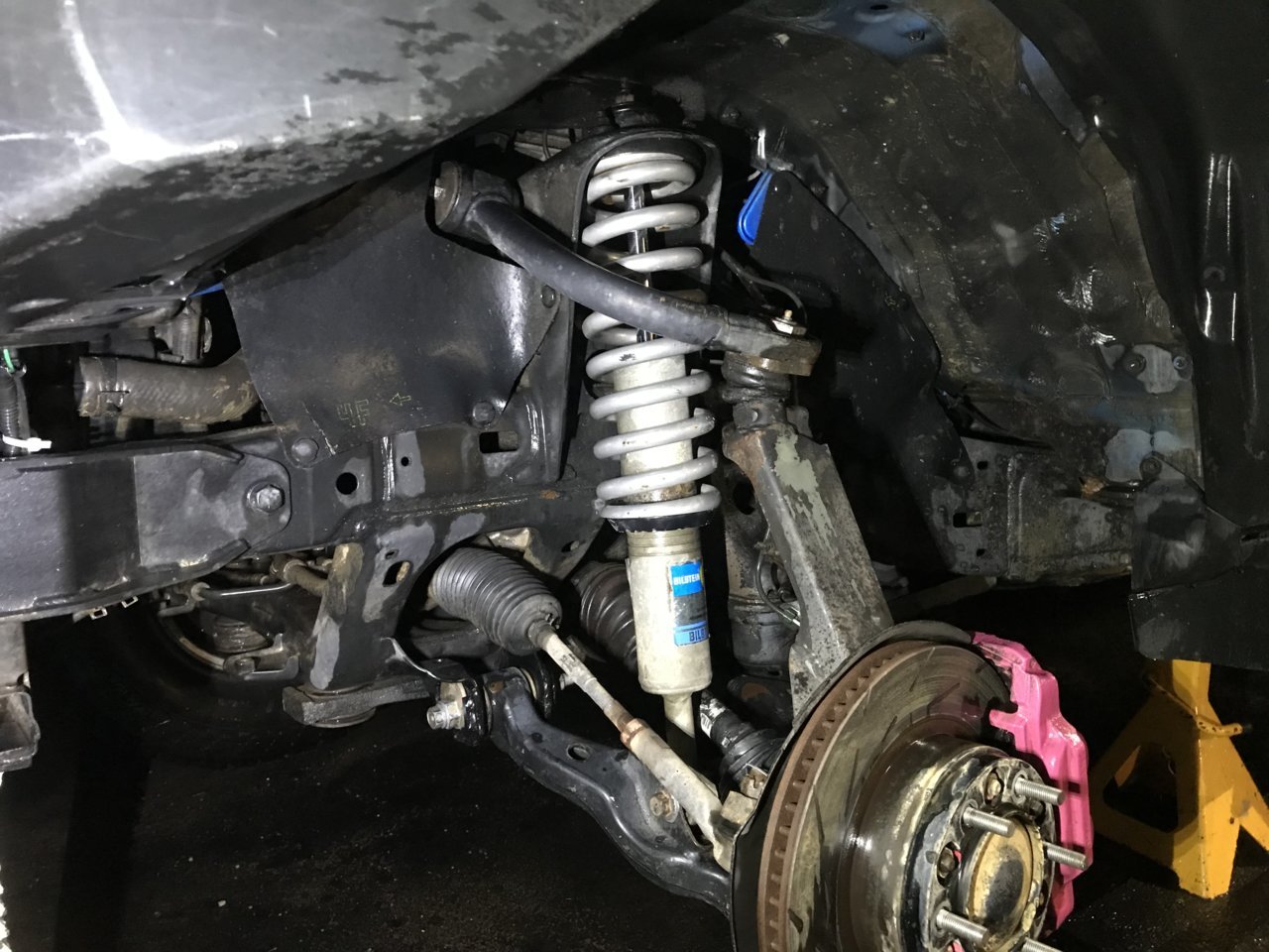

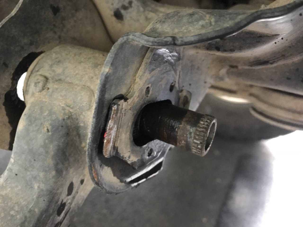

    Total Chaos Cam Tab Gussets finally welded and installed
    Weld:
    Back side
    Front side

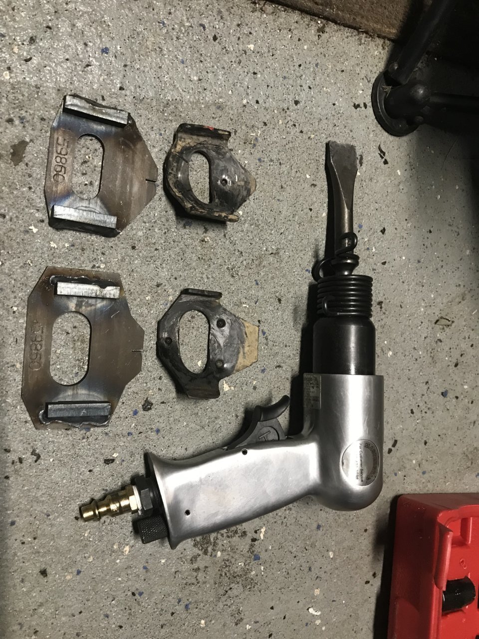

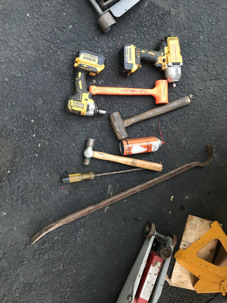

    Metal sleeve inside front bushing was rusted/frozen onto the bushing.
    Lot's of Kroil and basic tools of persuasion:
    Used my air chisel that i've had for a good 18 years or so. Didn't have to drill out the rivets. Make sure the chisel is sharp.
    Welded on:

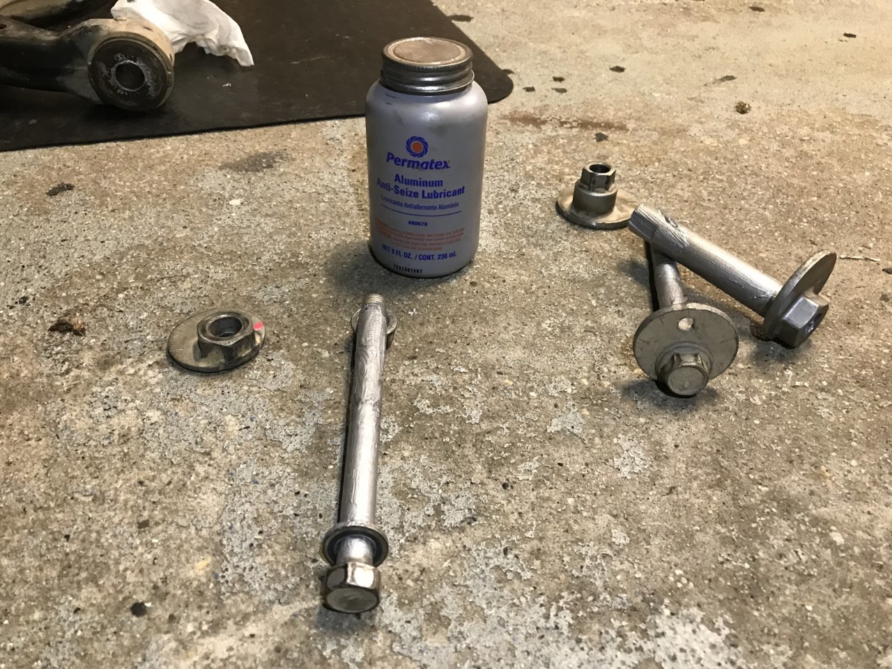

    Used a shit load of anti seize for reinstall of all bolts.
    Done
