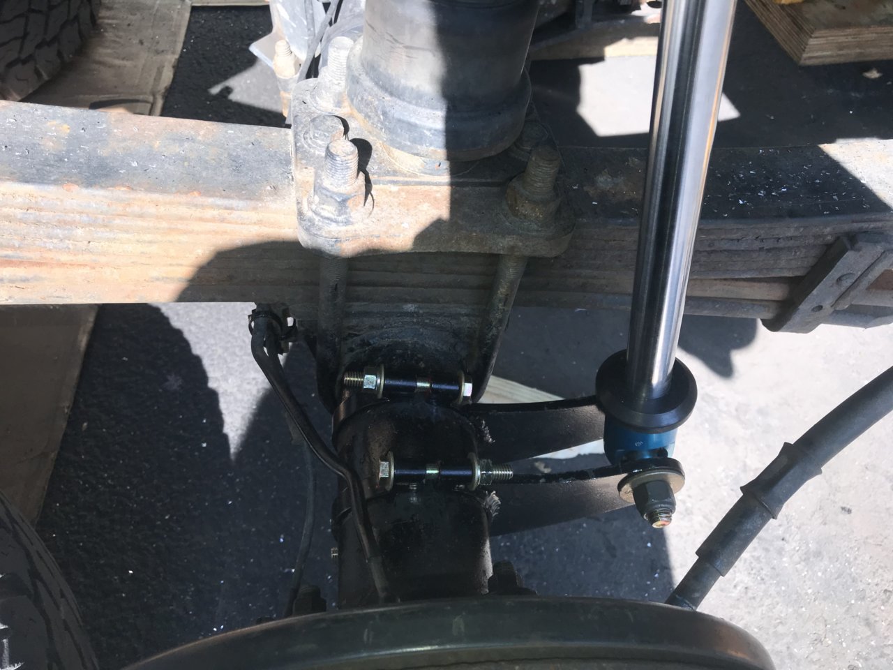

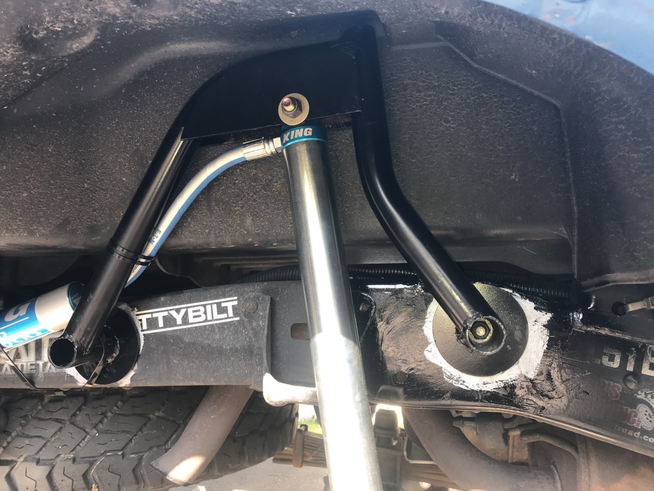

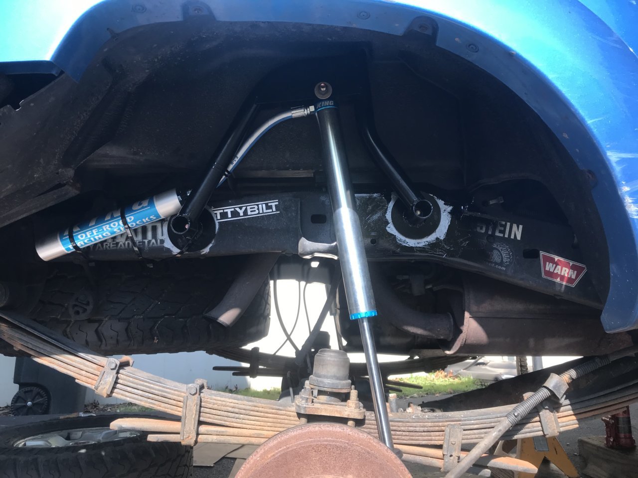

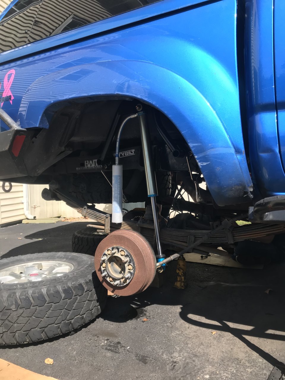

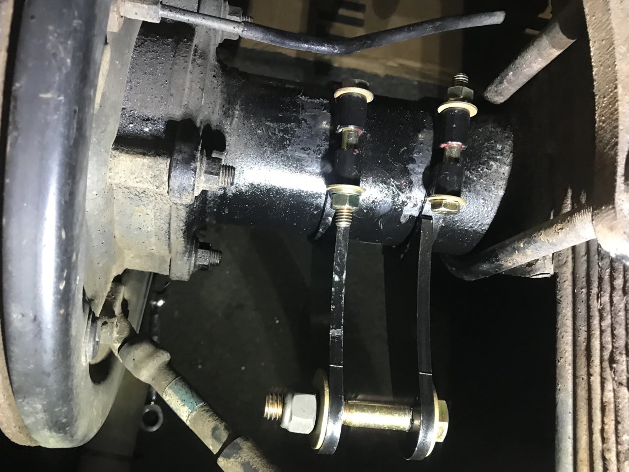

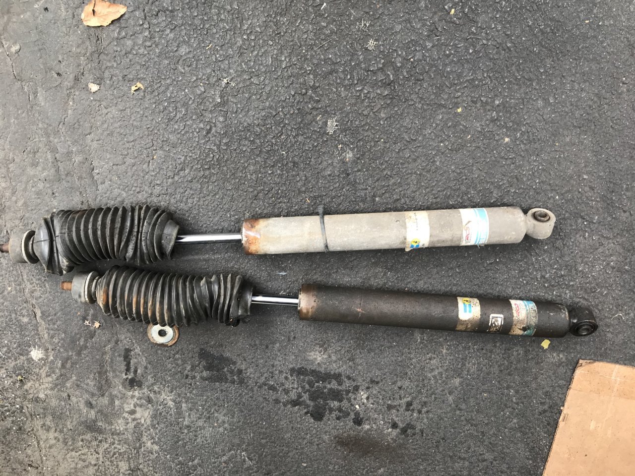

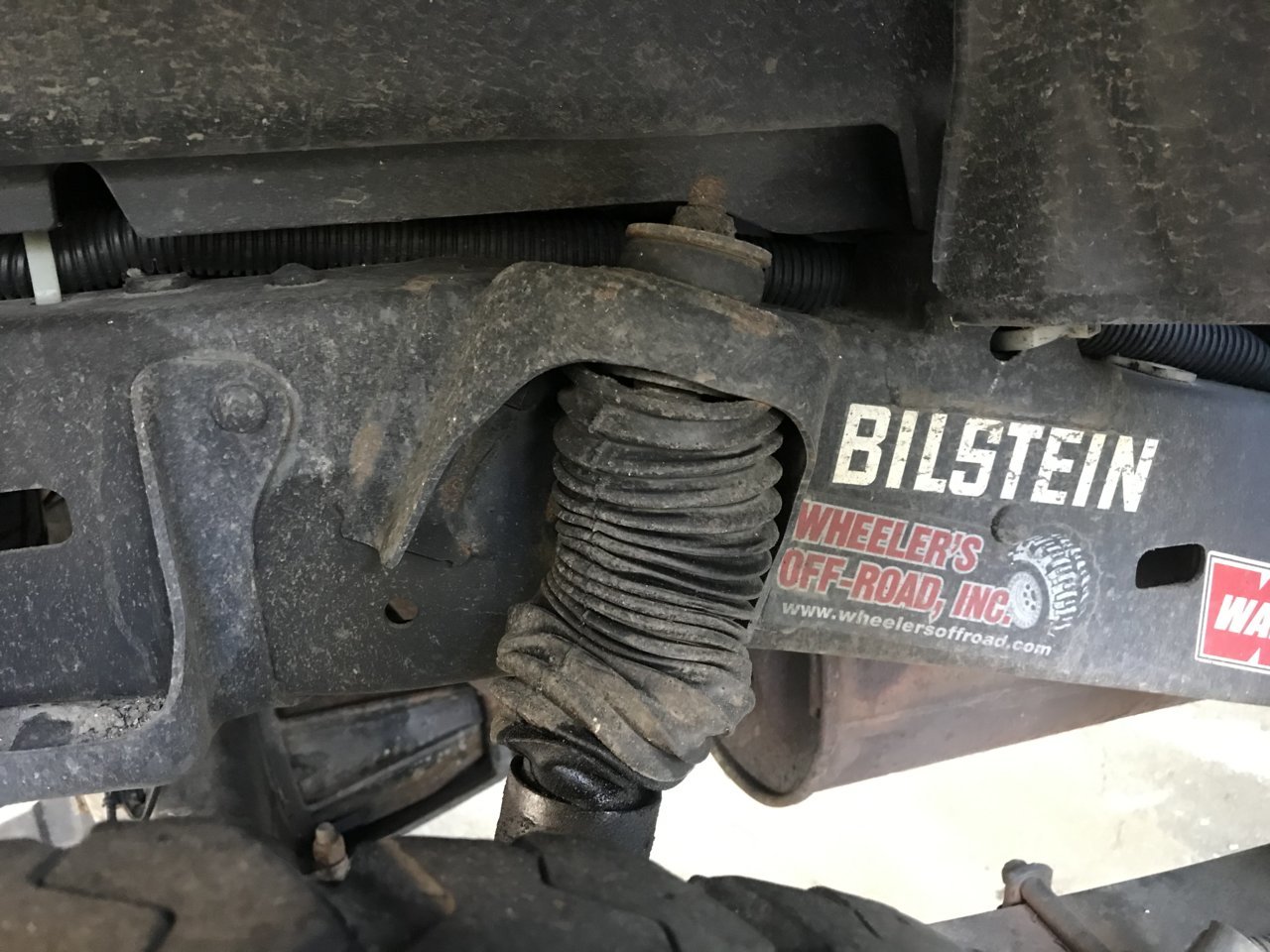

    How to replace rear shocks in five easy steps:
    1. Remove fuckered up old shocks and grind off the OEM upper frame mounts and lower axle mounts.
    B67959DD-5FB9-4A55-9494-76ED1A29ECB2.jpg 7A34E271-148C-41D3-8CDE-5D91877A906F.jpg

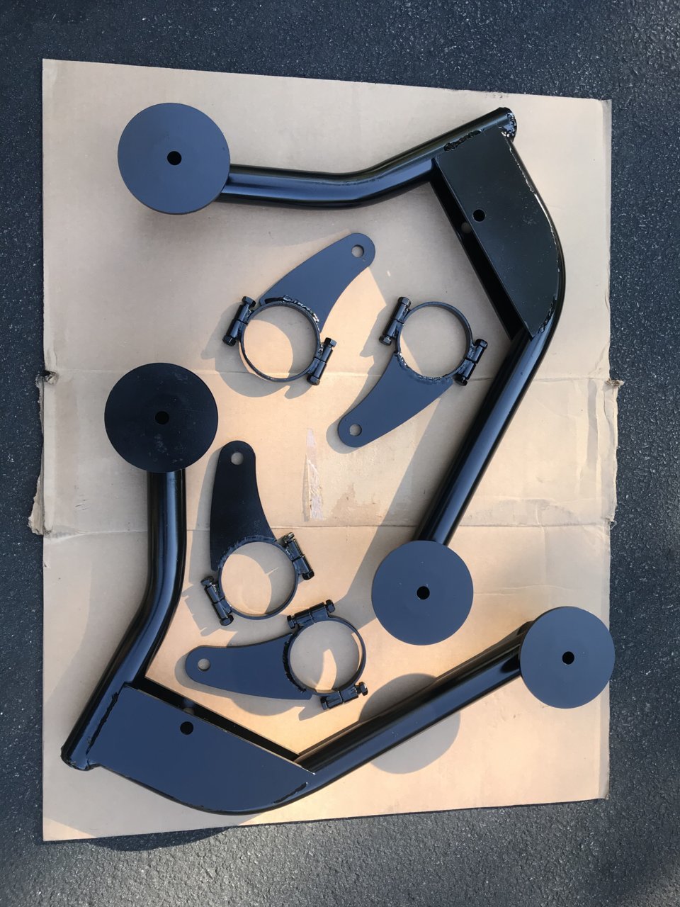

    2. Admire freshly rattle canned #graymanfab shock relocate kit by @Arcticelf and dry fit lower axle mounts and upper frame mounts.
    551F4027-0430-4ADB-B0B1-4AACD5D0C7CD.jpg 5EECE659-377A-45A5-9303-B82447C09F72.jpg F5BFEF10-13D2-473E-BB6C-378483386097.jpg

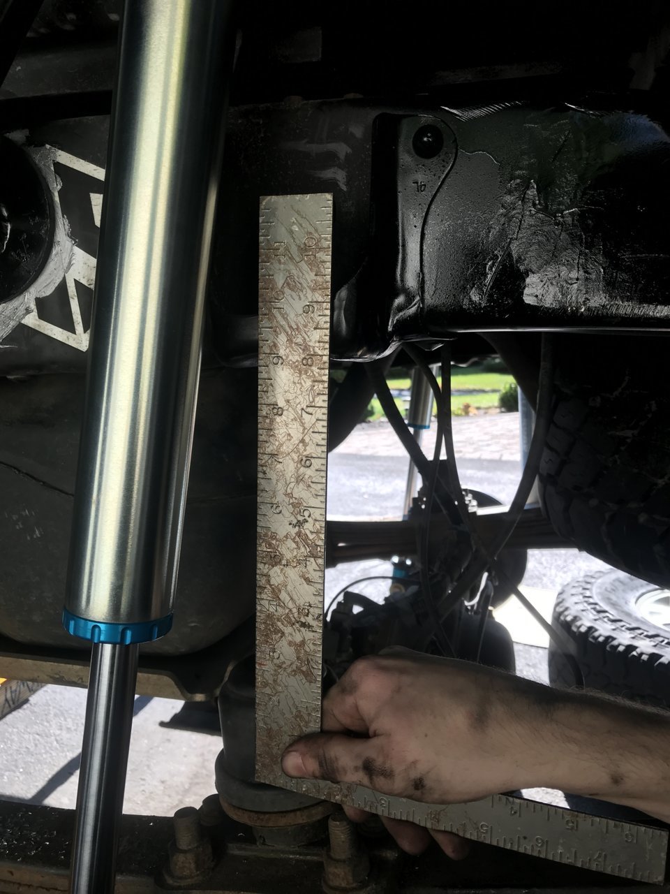

    3. Drill 1/2” holes into frame to bolt on the shock hoops. Liberally apply anti-seize to hoop mount and frame interface in an attempt to reduce future rust rot.
    4. Measure length of bottom of frame to bottom of bumpstop. This will be the length of exposed shaft. Use a bottle jack to lift up the lower shock eye that’s bolted onto the adjustable lower mount. Tighten the lower mount clamps.
    5. Make sure all nuts and bolts are tightened up, zip tie the reservoirs to the frame and reinstall tires.
    Much thanks and gratitude to @Lux , @JCjeeper abd @Sofatank for sacrificing their weekend to help me with this shock install and also giving their best shot at trying to figure out my rig’s electrical gremlins.

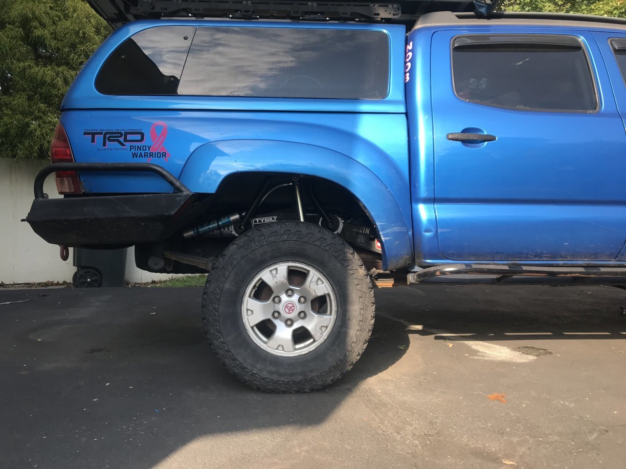

    oh shit, very fancy fancy for the old man!!!
    your bumper is crooked...
    12" smoothies!!!!!
    you gonna weld those towers on eventually??

    What’s going to keep the lower mounts from just rotating around the axle? I would take a paint pen and draw a line from mount to axle so you have a reference in case it does.
    fatfurious2 and Subway4X4[OP] like this.

    That’s a great idea. I’ll do that.
    I still have more inches of future extension if I go with with a different leaf pack
    or hangers. Ability to rotate that lower mount might help adjust for that.

    My bumper is crooked AND bent in various places. Those damn malls can be brutal.

    Massive amounts of friction, and the clamping force. We did a similar setup on @TwistedTLM4 s truck, no movement for several months.
    Subway4X4[OP] and TwistedTLM4 like this.

    They can be welded, but there's not much need too. The idea is to make 12" kings a reality for the welding impaired.
    Brian422 and Subway4X4[OP] like this.
