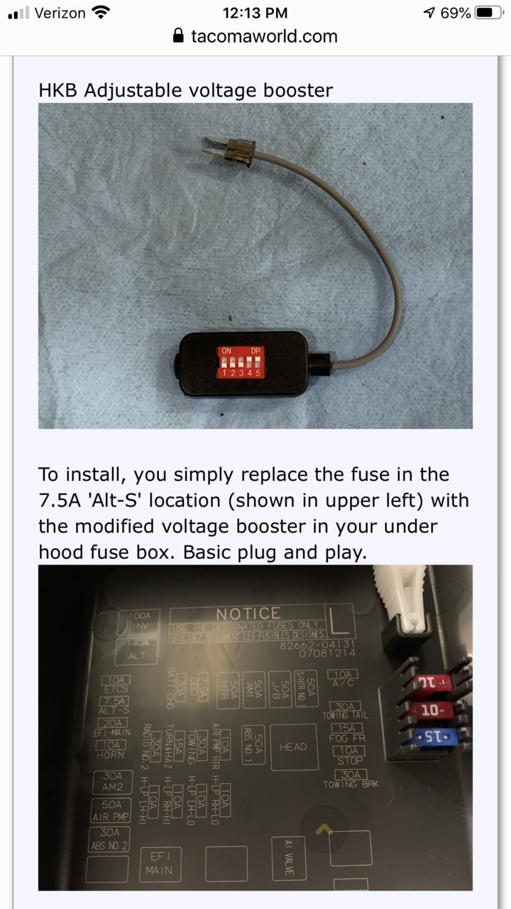

    Someone suggested that there’s a fuse that’s in the engine bay fuse box that regulates when the alternator starts charging. Anyone familiar with this?

    There is a wire in the engine bay fuse box that provides the measured voltage for when the battery is charging. There's a reference too it somewhere in the 2nd battery or battery relocation threads. It's one of the wires you tie into when doing a blue-sea ACR install.

    I ordered the replacement fuse rather than the adjustable gizmo after installing an AGM battery.

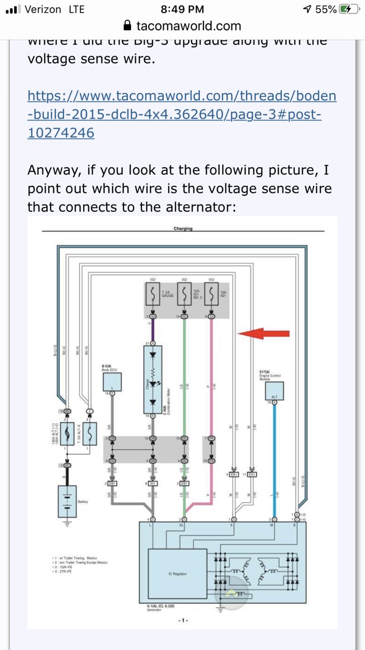

    Ok. So I know where the find the WHITE voltage sensing wire at the alternator connector and at the engine fuse box.
    What do I do with this wire?
    Just check for continuity? Check the fuse where this is attached?

    Did you check the Alt-S fuse? Try swapping with one of the spare fuses on the fuse box lid even if it seems fine and recheck your voltage at the battery with the truck running. There shouldn’t be any load on the Alt-S circuit, so swapping the 7.5A with a 10A spare will be fine for the test. I believe the 2nd Gen voltage regulator is integrated into the alternator, meaning it sounds like an issue on the voltage regulator “Alt-S” circuit.

    Make sure the voltage there is the same as the voltage on your battery. If it's higher at the fuse box than you're not getting as much juice to the battery as you should. If it's the same then the problem is probably the actual sensor/controller.

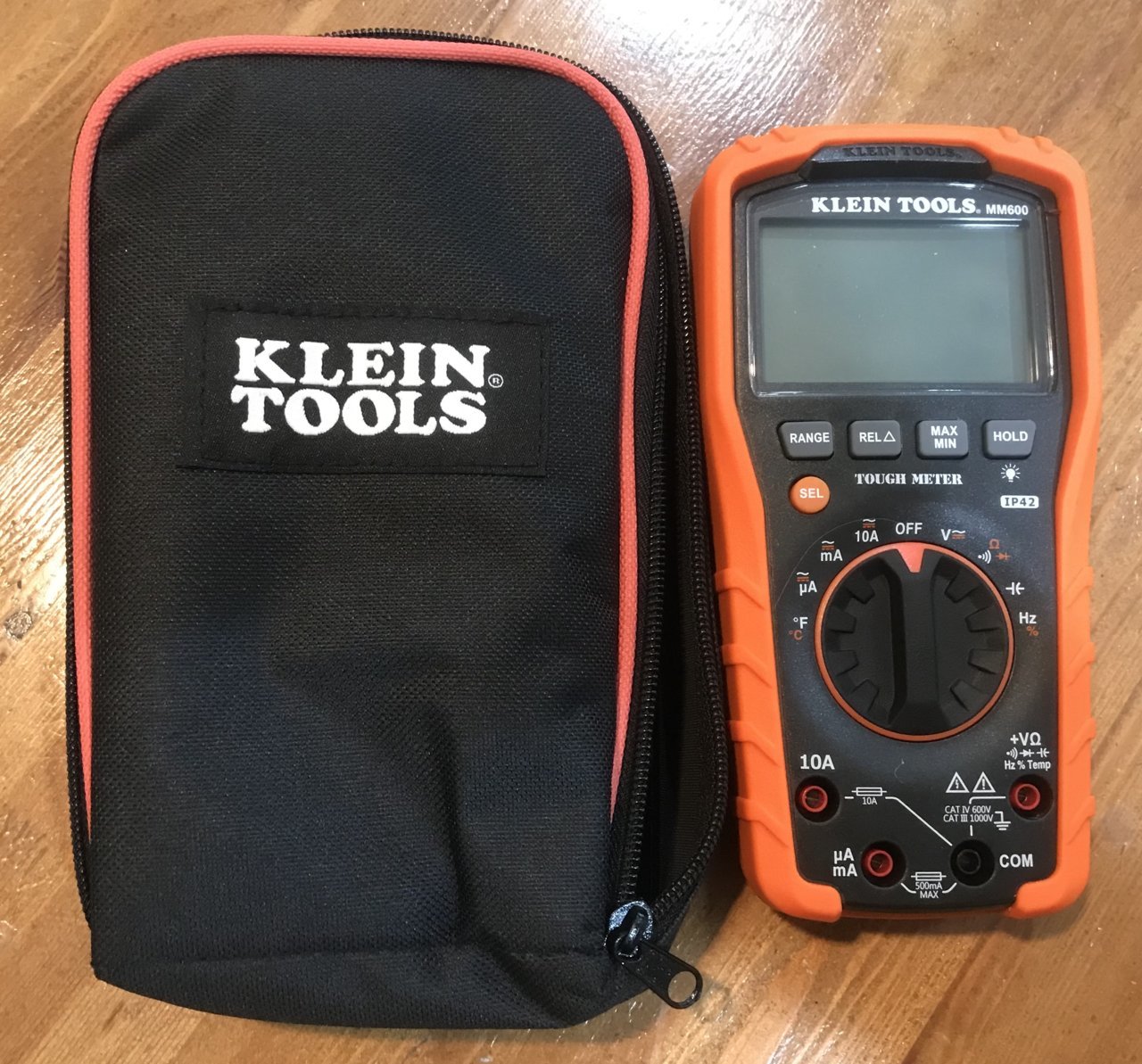

    My 10 year old Harbor Freight multimeter crapped out.
    Got a decent replacement this time. A Klein Auto Ranging model. I looked at Fluke, but this one had same/more functionality at half the price.

    oooo link? I have an old OLD fluke and some of the buttons are falling off. I want to replace it.
