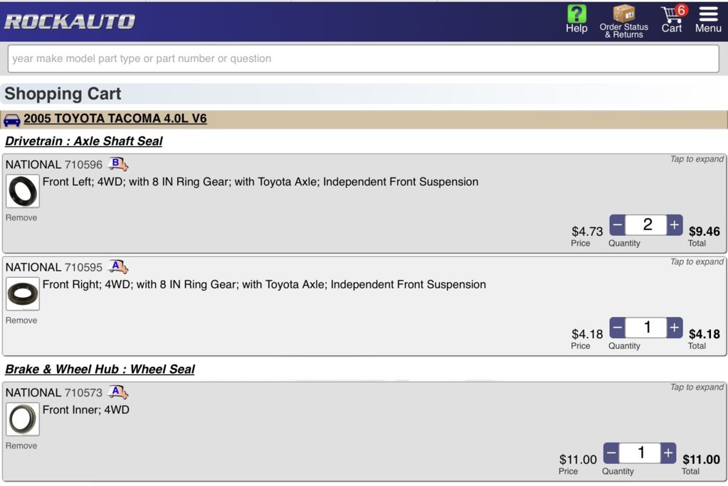

    IMG_2129.jpg CV Axle seals.
    I didn’t want pay the ridiculous stealership prices. The National Seals are made in Japan.
    Knuckle Toyota OEM 90316-A0001
    AKA Wheel Seal (Rock Auto)
    National or Timken seal #710573
    CV Axle Toyota OEM 90304-A0001
    AKA “Axle Shaft Seal” (Rock Auto)
    National or Timken #710595 Pass Side
    National or Timken #710596 Driver Side
  19. Aug 29, 2025 at 6:56 PM
    #1519

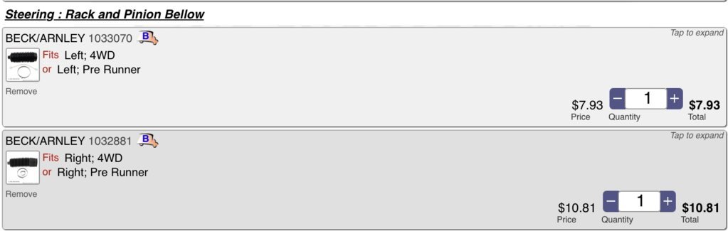

    Steering arm boots or “bellows”
    I ordered several sets from Amazon and none fit correctly even though Amazon says “Exact Fit” for my ‘05.
    RockAuto came to the rescue.
    I hope Beck-Arnley is a good brand.

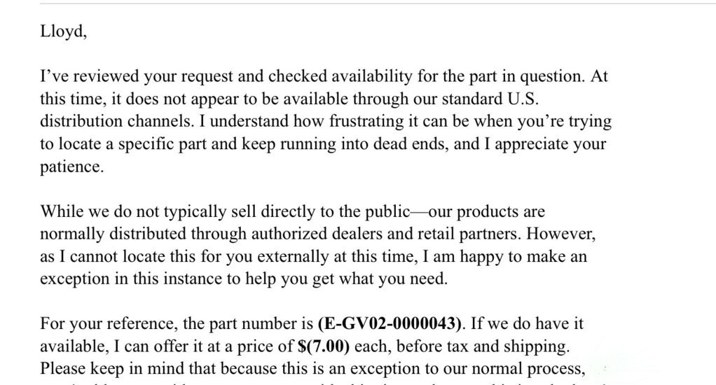

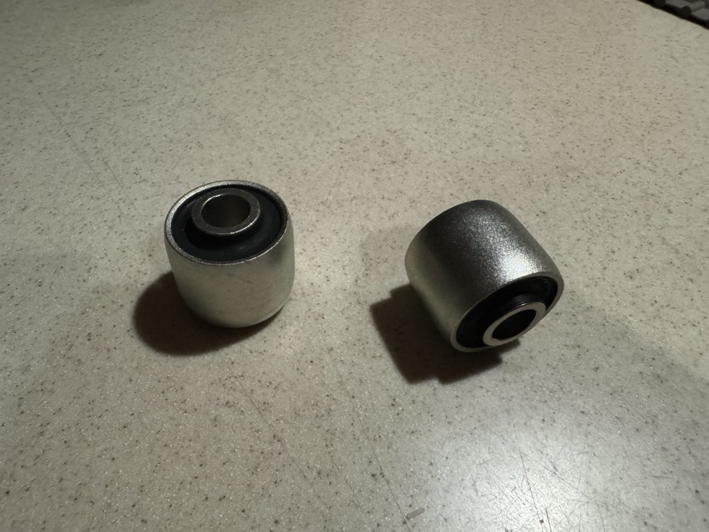

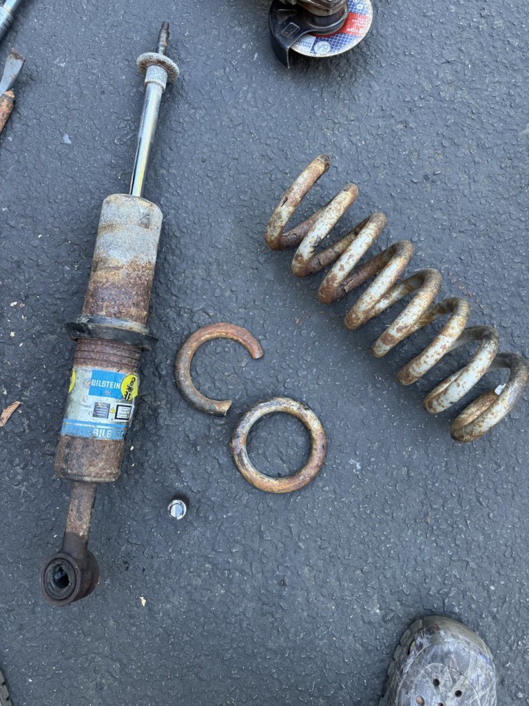

    I wanted new shocks but since I’m now on a fixed income, I have to make do with my current Bilstein 6112’s. The shock exterior looks rough, but no leaks. The lower shock bushings were well worn, so needs to be replaced.
    I looked EVERYWHERE for replacement bushings with zero success.
    Finally shot an email to Bilstein and they sent me four. They’re not off the shelf bushings, and they don’t normally sell them. They made an exception to their normal process.
    Part number is E-GV02-0000043
