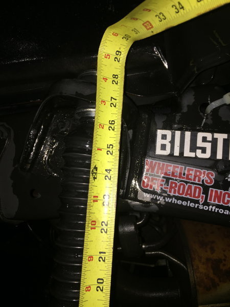

    OK. Now I know I haven't been dreaming my near-maxed out full rear shock extension.
    I measured my max extension at about a hair under 27"
    @Crom just re-measured his rear extension and its maxed out at 27.28"
    We have the exact same rear set-up: Dakars + 28XL OME AAL, 3 degree shim, U-bolt Flip, B110 Shocks, Superbumps and STOCK SHACKLES.
    The only difference between our two set ups is that Nick retained the 1/2" thick overload OME Dakar Spring. I removed it. This explains the approx 1/2" difference in our max extension measurement.

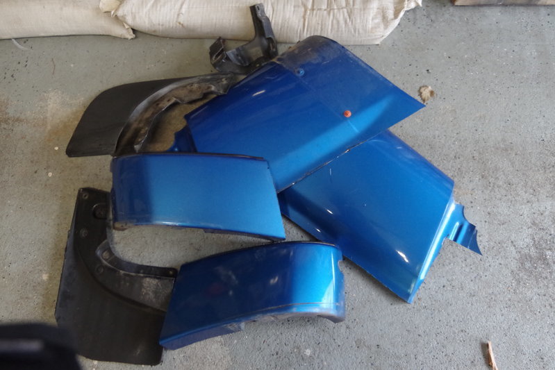

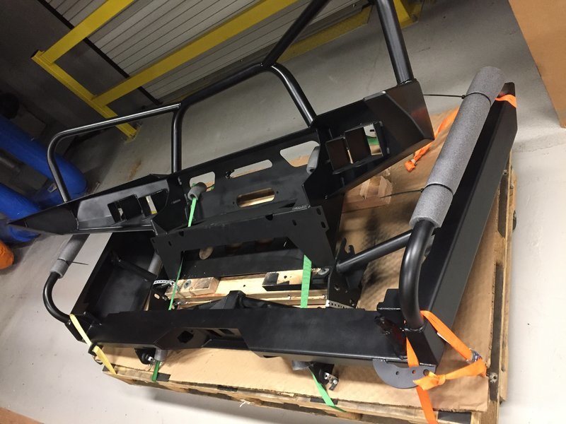

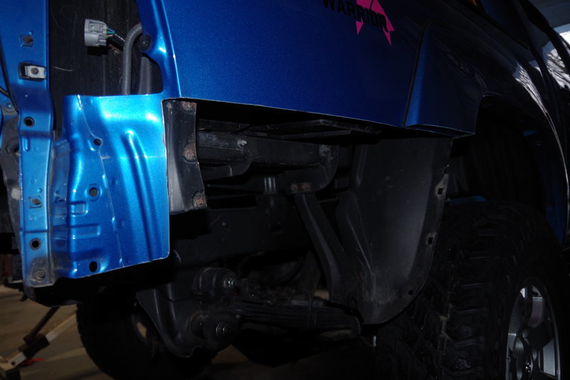

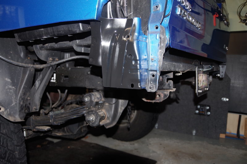

    Finally cut and edge painted my bedsides in preparation for my BFF Rear HC Bumper.
    I used touch-up paint for the visible edges. Regular rattle can paint for the other, not-so-visible areas/edges.
    Bye-bye pieces of truck that I've been keeping safe for the past 12 years...
    Prepped, primered, painted and palletized for the trip home.
    Prep: Krud Kutter, Water Rinse, Acetone wash, Light sanding
    Primer: Self Etching Rustoleum Rattle Can
    Paint: Krylon Satin Rattle Can (on sale at Wally World for 2 bucks a can)

    Hmmmm so does that mean my B110's are limiting my droop with the shackleflip?
  11. Jan 3, 2017 at 6:22 PM
    #171
    Subway4X4
    Subway4X4 [OP] Shameless Copy Cat
    Nov 10, 2015
    #169260
    11,668
    Lloyd
    NY/NJ
    05 Speedway Blue DCSB OR TRD
    Everything TW members recommend
    I'm thinking yes. But if you can confirm and let me know that would be great.
    Your best bet is to do the same flexing and measuring exercise that Nick did. Here.

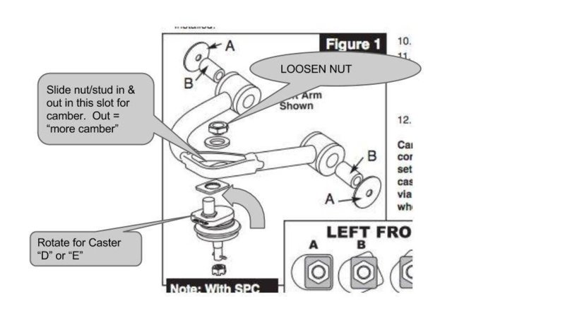

    Getting ready to do my front suspension:
    Lilcarkid, Nimble9 and uurx like this.
  16. Jan 4, 2017 at 4:57 PM
    #176
    stairgod
    stairgod NOOB
    Aug 16, 2015
    #161924
    7,965
    Jo n
    PA/NJ
    2011 MGM Trail Limo
    Locked Boosted 35s
    No resis on those COs...
  17. Jan 4, 2017 at 5:12 PM
    #177
    Subway4X4
    Nov 10, 2015
    #169260
    11,668
    Lloyd
    NY/NJ
    Trying to do initial homework before the big installation weekend.
    I've done coils springs a couple times this past year, so I'm not forecasting any issues.
    The SPC LR UCA's are a different story.
    Any words of wisdom on installation?
    How about the initial settings before I go off to get an alignment?
    From what I have learned on this thread:
    1. Initial Caster should be set at "D" setting
    2. Initial Camber should be in the middle of the "Camber" slot
    3. OEM LCA Eccentric bolts should be set to "Neutral"
    FWIW, the front suspension will have Billie B6112's, Eibach 700 lb coils to support a HEAVY front end: BFF plate bumper/full hoops, 12k Winch with steel cable, full @Mobtown Offroad steel skids, Aux battery system in engine bay. OEM wheels on 255-85-R16 ST Cooper Maxx's.
    Tagging some peeps that I know have LR UCA's: @HolyHandGrenade @Sub-Zero @uurx

    None
    why are you messing with the LCAs? and yea i put the ucas to the neutral setting and it put it right at 3.0degrees. are you assembling the coils and springs on the truck? install of ucas is pretty simple, unless you ask Tim, he will try to tell you you wont be able to get it done in one night :p
