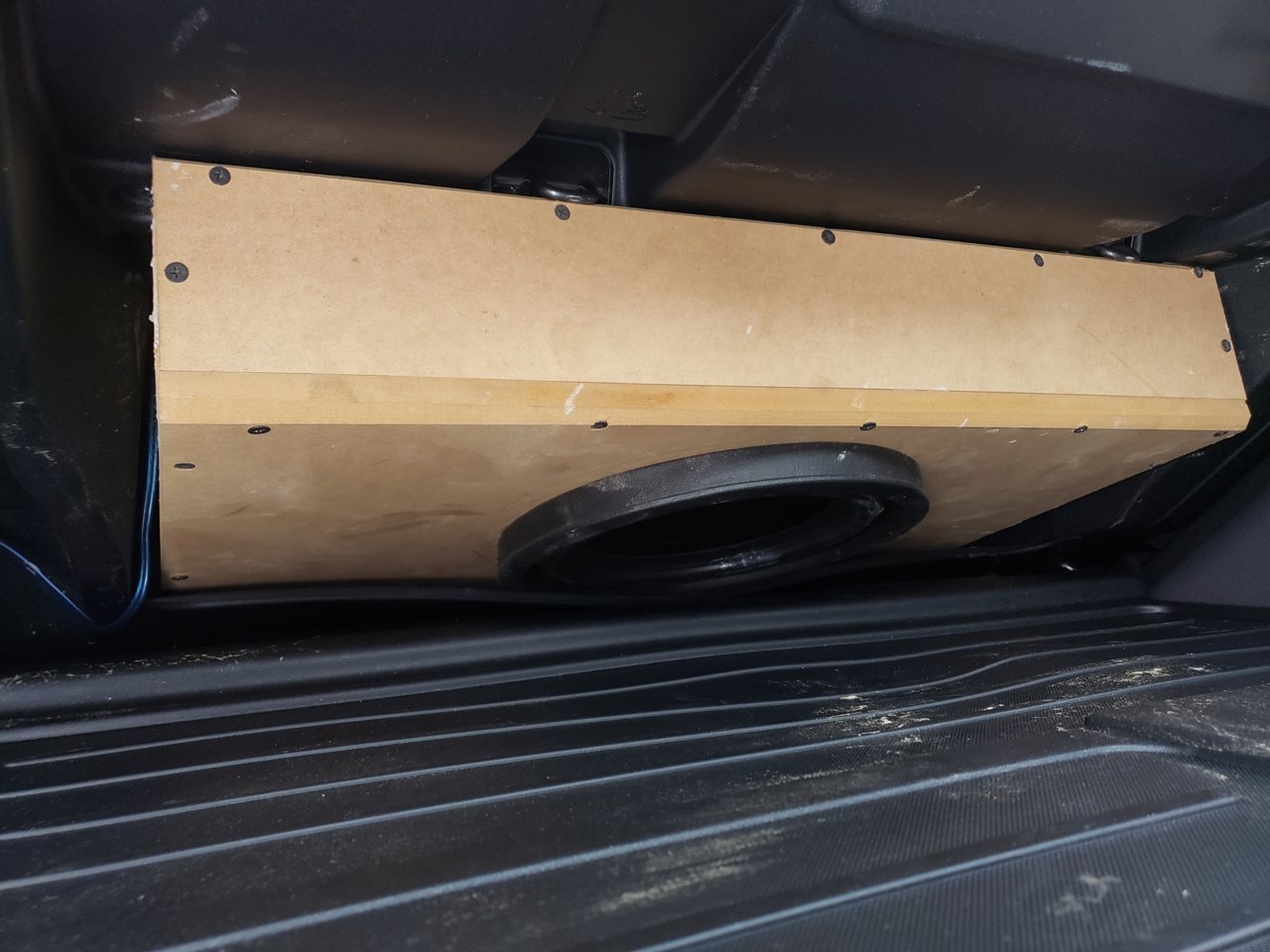

    Not carpeted yet, but I built this to fit in the plastic tray behind the passenger rear seat for the same reason, I didn't want to start disassembling a new truck. One shallow mount Alpine 10 and I mounted the amp under the front passenger seat. More than enough bass and sounds really good to me.

    What’s the dimensions and how much volume does the enclosure contain?

    Rough measurements because it's been a few days. 22x12x6. Puts it at .91 cubic feet. The alpine sub that I put in the box has a 4 1/8 deep basket and has plenty of room.
