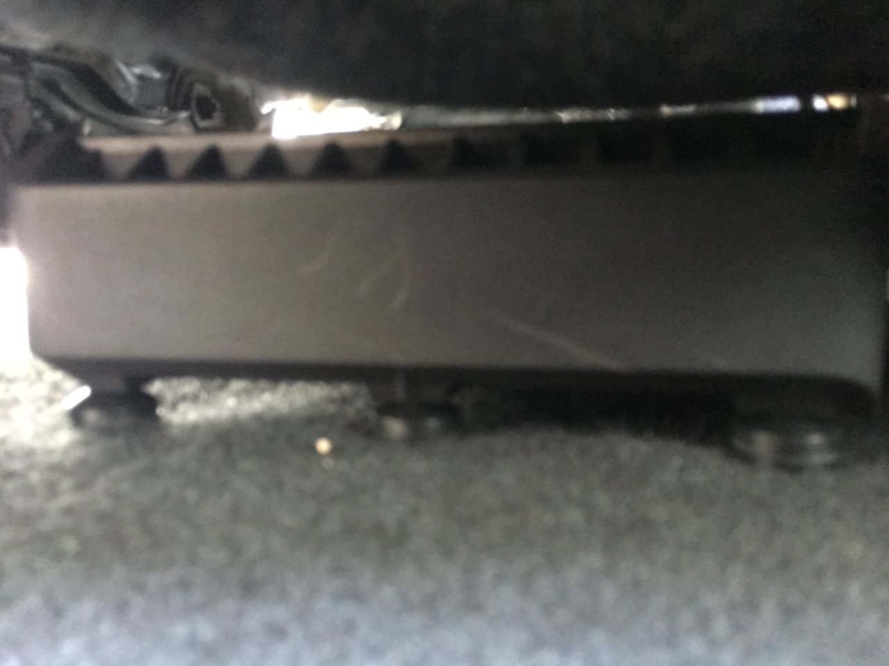

  16. Nov 21, 2018 at 3:41 PM
    #36
    badfish_55
    badfish_55 Unknown Member
    Sep 29, 2017
    #231512
    174
    OC-->TN
    '17 TRD Sport
    I got this beast to fit under the front seat with a few spacers to give it some breathing room
    presta24 likes this.

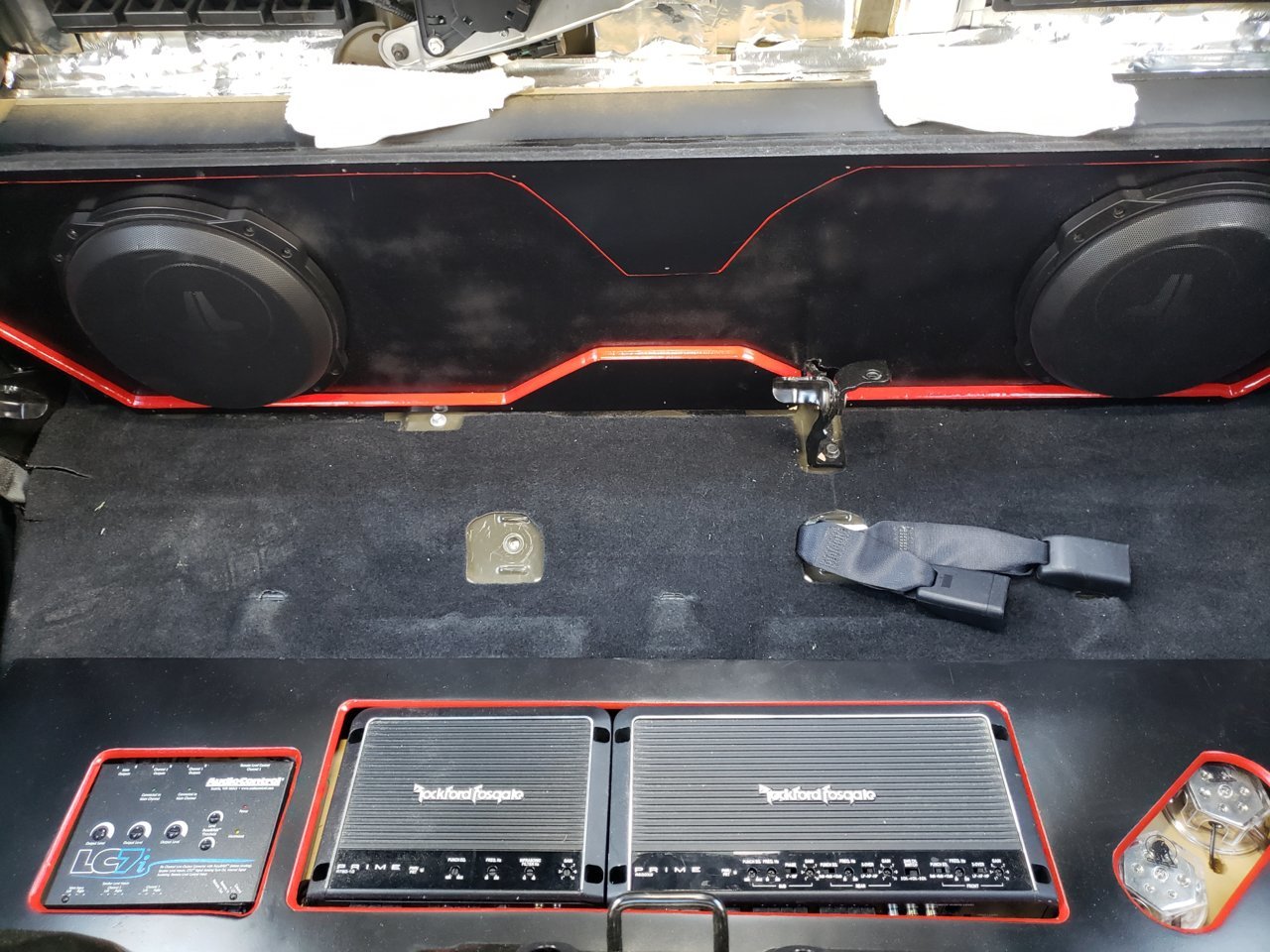

  20. Nov 22, 2018 at 9:10 AM
    #40
    ratcityrain
    ratcityrain Well-Known Member
    Jun 3, 2015
    #156667
    1,374
    Seattle, WA
    2017 Double Cab Off Road
    OEM Running boards |oemassive headlights | winjet tail lights | led lighting | hid headlight & fogs | oem tri-fold Bed cover | Custom dual JL Audio 10tw3-d4 sub box and custom amp rack | black off road wheels | painted oem grille | jbl door speakers |
    This is my setup now. Dual JL 10TW3-D4 in custom box I made myself, Rockford 5 channel for doors and Rockford mono for subs. I still need to work on the upper part to finish it off.2018-08-03 17.17.26.jpg
