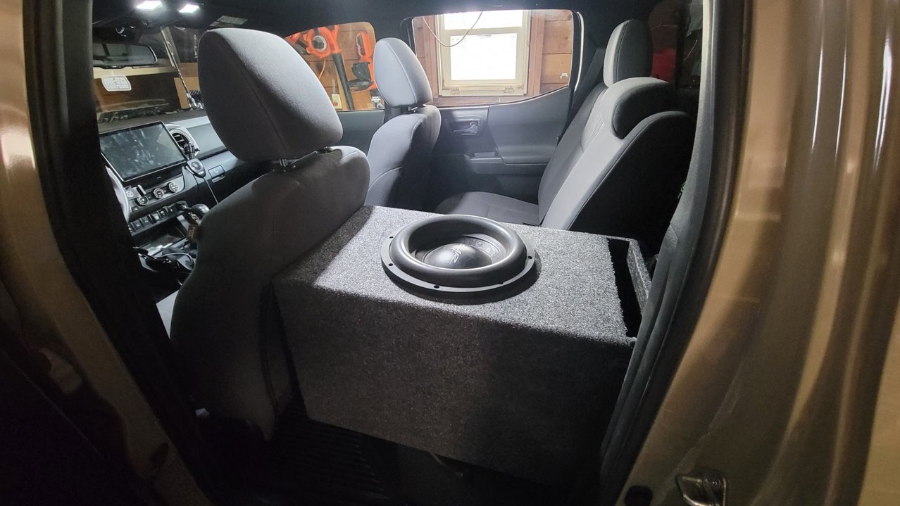

    Yea... I tried a few different behind the rear seat configs and none of them even came close to producing enough low end. Think I have a problem...
    This is what I ended up with and it's perfect, other than the amount of room it takes up.

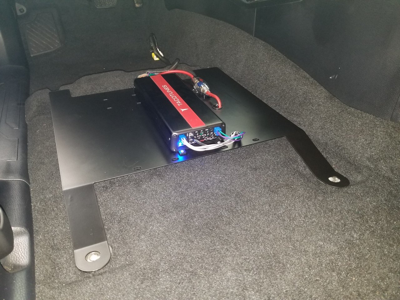

    Please send me info on that amp and rack. Just got a Stealth Box and want to to the taco tune route. Part numbers would be great.
    Nice build.
  13. Oct 7, 2021 at 5:38 PM
    #93
    HTOWN4X4
    HTOWN4X4 Well-Known Member
    Aug 7, 2018
    #262038
    314
    2017 DCSB MGM 4X4
    I don't remember the part numbers, but just go the taco tunes website and you will find the plug & play amp, wire harness and amp rack.

    Thanks, just ordered both harness. I will use a LC7i and a JL 300/1 amp for the sub and an old Alpine KTP-455 for the door speakers. Thanks for the reply.

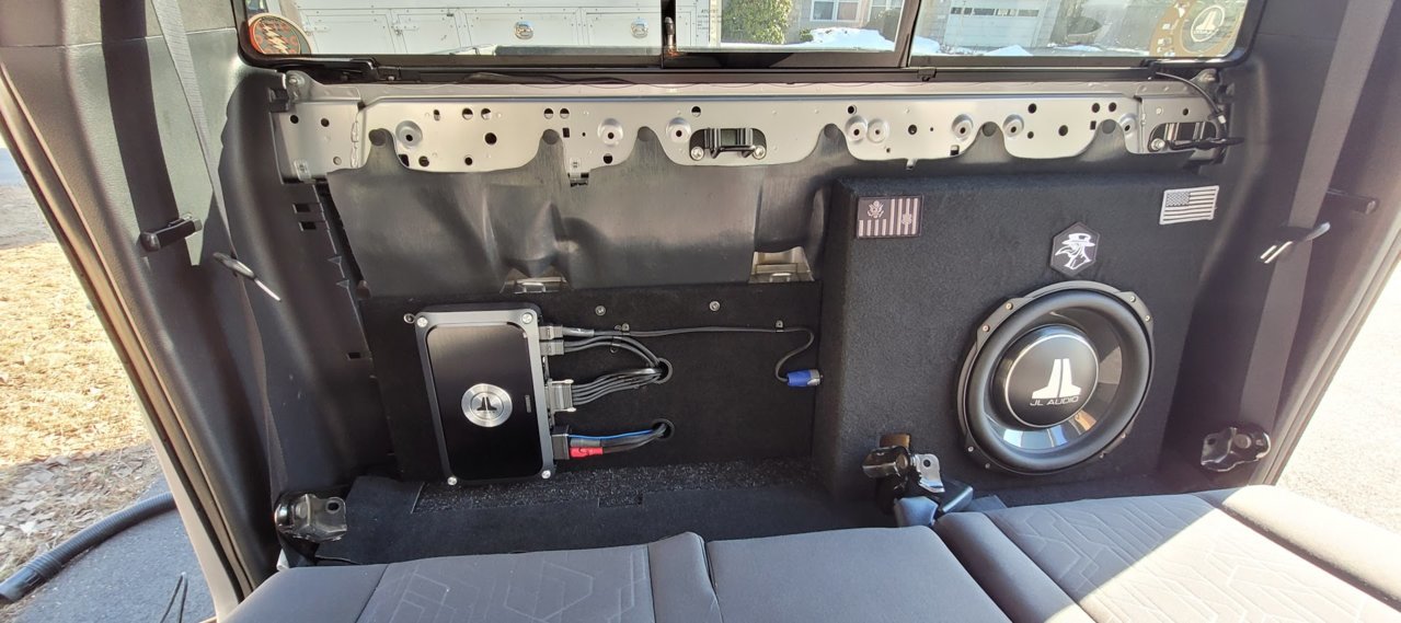

    What I made. Wanted to keep the cubbie too, but realized it just wasn't worth it.

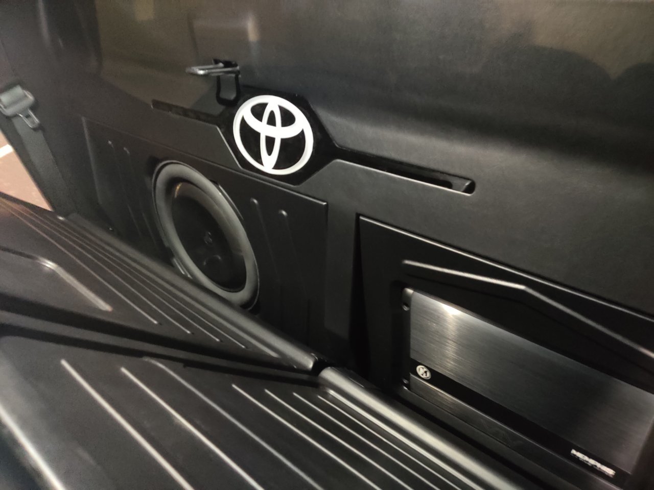

    Well, I finally got my system installed. Very pleased with how it turned out. I have the Pioneer DMH-WC6600NEX that replaced the factory head unit (had the JBL system from the factory). The whole system has been replaced. I am running Memphis Audio 6X9 components in the door and 6 1/2s in the rear (both are carbon fiber cones- M Class series). The tweeters are a bit harsh at times but I have lots of control via an iData DSR1 (using it in general mode and not vehicle specific mode), which gives me an equalizer and DSP plus some nice controls to punch up the subwoofer a bit more. I have a single JL Audio 13TW5 and all speakers are powered by a Memphis Audio Viv900.5 5 channel amp. Gains are only at about half and it's WAY louder than the factory and sounds very clean. I will post links to the 3 videos (eventually) that the guy that did the work created. He did amazing work and it looks factory behind the back seat.
    Now that I have done this change, I am already thinking of what I may want to upgrade already. I am looking at the BLAM separates for the doors so I guess I may have opened pandoras box. I may not change but you never know. LOL
