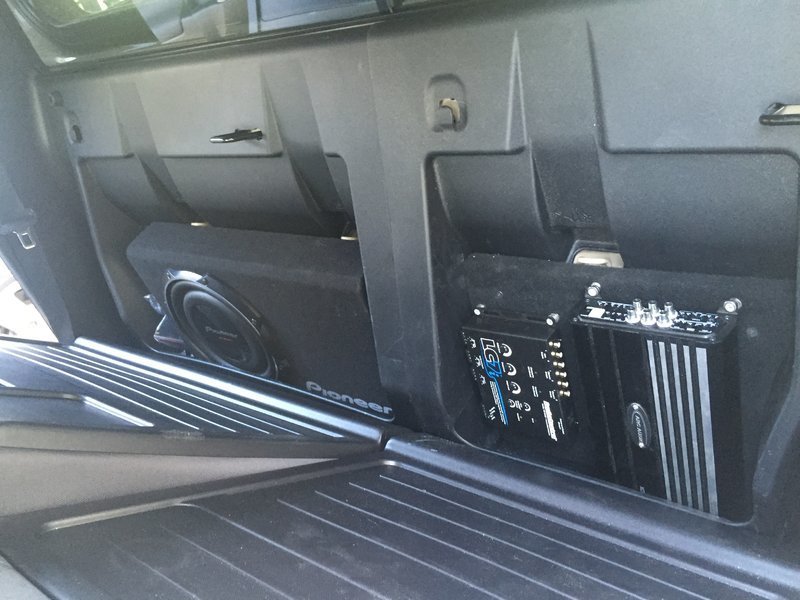

    Snugtop Rebel with some options Body Armor Rock Steps Rhino Mats Weathertech Mudflaps Radar detector hardwired to rear view mirror. Stereo upgrade: Amp: Arc Audio XDI805 LOC: AudioConnect LC7i Front Speakers: Hybrid Audio Technologies Claris 6.5 Rear Speakers: Hybrid Audio Technologies Mirus 5.25 Sub: Pioneer TS-SW2502S4 Box: Pioneer Ud-SW250T Bilstein 5100s OME 885 Springs Single Add-A-Leaf BFG KO2 265/75/16
    Box: Pioneer Ud-sw250t
    Here's what I'm using. It looks like it's made for the truck, and is a very affordable option for someone wanting to add some thump.

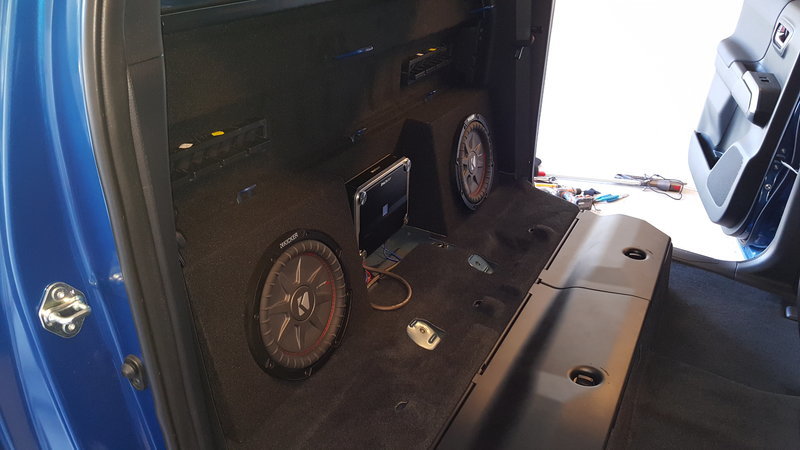

    Tow package, LED interior lighting, led low beams, led fog lights, led licence plate lights, OEM bed mat, OEM mud flaps, OEM chrome raised tailgate letter inserts, nerf bars, AVS ventshades. Complete Kicker audio system (4 channel amp, mids and tweets in the front, 2 ways in the back, 2 10 inch comp rt subs, Zxsum8, alpine pdx 1.600 boxes and amp rack by Mr Marv), Pop & Lock, Mobtown locking bed storage doors, Bilstein 5100s, Katzkin Leather interior, Redline Hoodstruts, Backflip.
    You have to be careful of the two vents on the back wall. The 3rd gens are the first model to have them there. I had @Mr Marv build the boxes and amp rack for my 2 10s. He was very reasonably priced even with shipping from California. The build quality of his boxes are 2nd to none.
