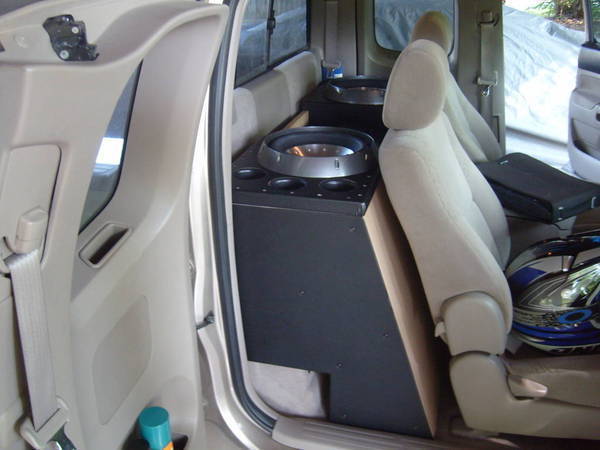

    So I have finished wiring and installing my 12 inch sub in the access cab. After getting everything powered and fused, I turned it on and I am very impressed. This post is due to the hundreds I have read basically bashing stock headunits that cause impotent subwoofers.
    I bought the major components used to save money.
    Scosche 4 channel RCA line converter 20.00
    JL CL-RLC Line driver 30.00
    JL 500/1v2 amp 300.00
    JL 12w6v2 subwoofer 100.00
    Sealed enclosure (building a new one to better fit the access cab free
    4 gauge wiring with 60 amp fuse 30.00
    12 guage speaker wire 5.00
    The big issue people complain about is a lack of voltage from the deck
    to the rear speakers, not enough to make the subwoofer work.
    I can confirm this is true, I was getting 0.3v arriving to my amp.
    The line driver was installed and now I keep it at 6v.
    Honestly this thing can be heard blocks away if that is your thing. I have mine tuned so as not that loud. I like my 6 disc stock deck that I bought off a user on here despite its shortcomings.
    If anyone is considering this setup I highly recommend it. One subwoofer on a stock system is incredibly popular due to the simplicity. Install was a breeze and I used some writeups on here for disassembling the interior to run wires.

    Nice set-up, but where do the people sit back there?

    There is only room for 1 chick, bro's ride the back. :D

    Well to be honest, I didn't do anything different than what are already posted.
    Run 4 gauge wire from battery 10 inches, fuse, then run the rest through the firewall and along the driver floor panel. I have a few pictures of it but nothing that would be of much use right now. I haven't built the new box yet.
    RCA converter from off the back of the deck from the ceiling speakers. Ran that up the middle under the middle console and under the carpet, then matched them up with the power and found a solid ground point under the rear access seat. Remote wire parallels the power in my setup.
    Again my point in all this was it is a very simple setup, stock headunit, and is very loud if you want it to be.
