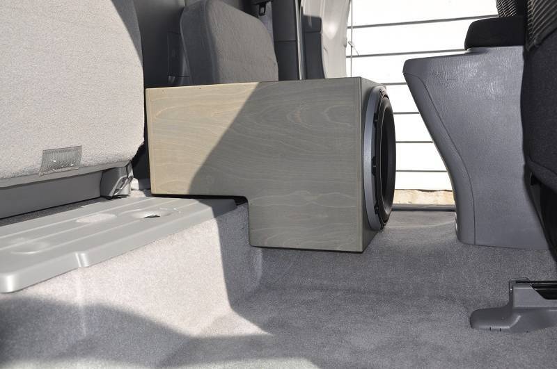

    Not new to car audio, just not a competition level person. I've always had systems in my vehicles over the last 10 years. This is my first experience with the tacoma install and a good system so I didn't know what to expect.
    You are correct that on the 500/1 the input level should be at the lowest level where it sounds good. This was the main point of my experience. I installed it without a line driver and the level switch at low (for 2 volt input or less) and honestly the sub was pretty weak.
    I added the line driver and switched the input level to high and lowered the input level to almost zero and got great results, hence no need to upgrade the headunit.
    Of note to people considering this amp, the manual has many different examples of setups that can be used as a guide. I don't suggest finding a JL person to tune it, but instead suggest some common sense, reading the entire manual, and reading car audio forums which is what I did. The bass boost that I referenced above was far too strong for my taste and thus it is turned all the way down.
