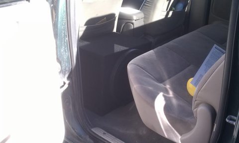

    Here is a picture of the caraudiofactory sub box installed.

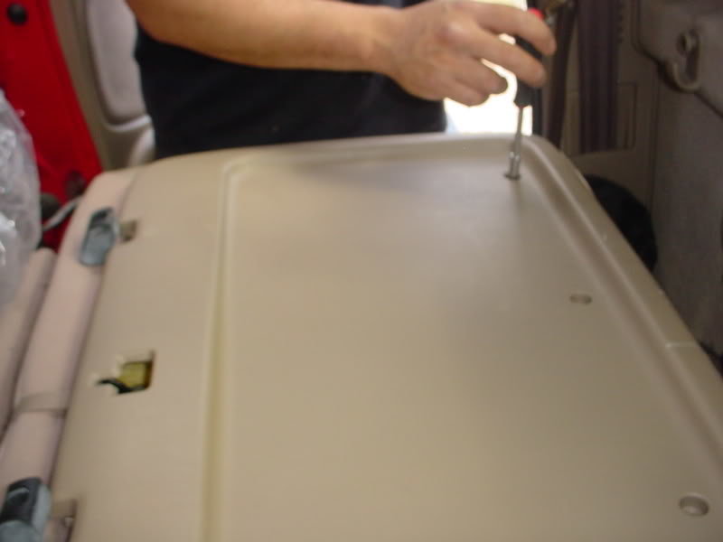

    The plastic covers Astraa70
    mentioned just cover up the yellow foam and metal horizontal bars that can be see in the picture. The covers look like this

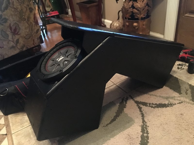

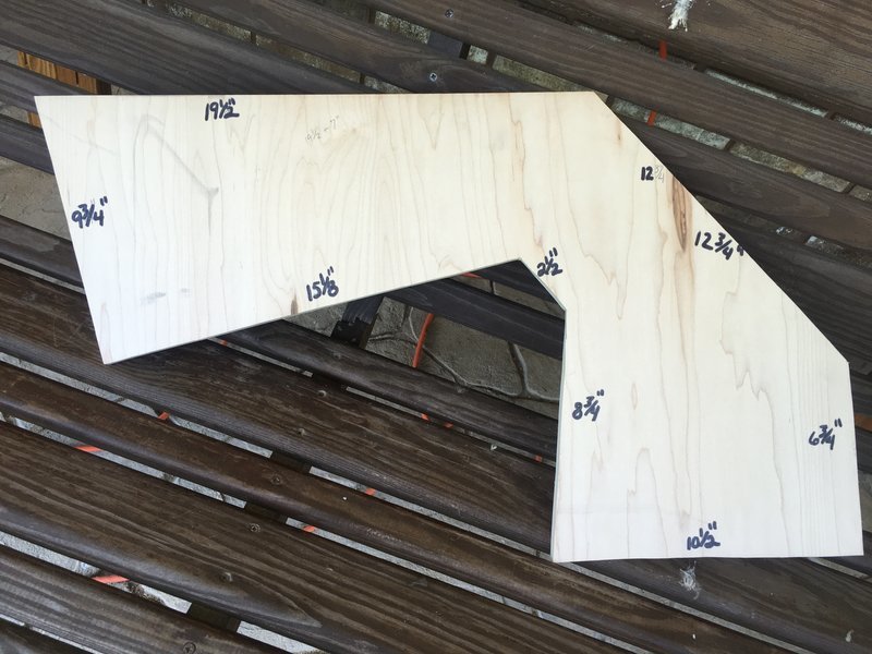

    I know this is very late but maybe someone will benefit. I'm almost done building a sub box/center console for the back seat. When done it will have cup holders. I had bought the Kicker 8" shallow sub to put in a box behind the back seat. Liked this option I saw in a forum better. Made from 1/2" birch plywood.

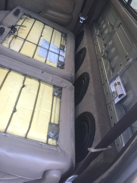

    built a box for 4 8's behind my seat.

    I like the behind the seat set up but I didn't want to remove everything. I bet having four 8s ROCKS!

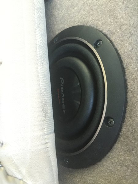

    That looks very nice. I would miss the storage back there though. I put a single 10" behind the seat and found the back cab wall rattled like crazy with the stock stiffener rails. Some mass loader (RAAMaudio) fixed her up though.

    Good idea adding the top/cup holders to it. :thumbsup:

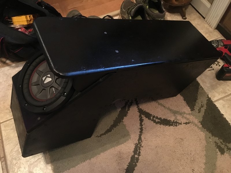

    Sprayed the box down with rattle can bed liner. Cheap cup holders are in shipment. image.jpg image.jpg Will get a black Kicker grill protector.

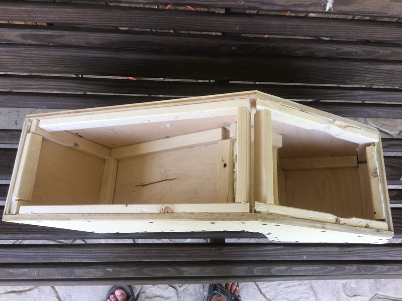

    ill take some pics of the 2 10's tomorrow.
    it's the same concept as these 4 8's but we cut the baby seat anchor bar thing out so the box can extend higher (for airspace) .
