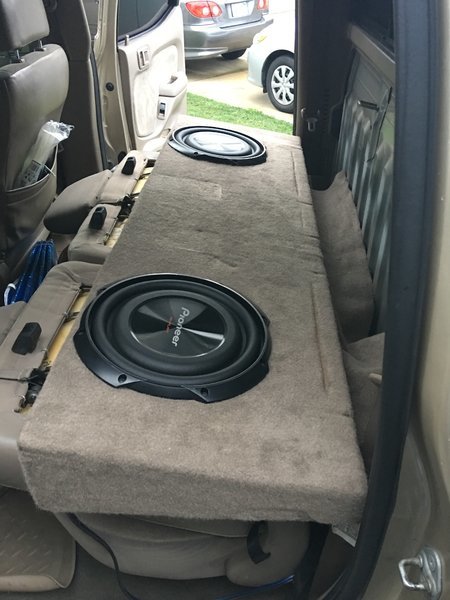

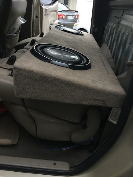

    here's a pic of my setup at the moment. with two 10's you HAVE to cut out that cross bar on the back of the cab. i've never tried the old thin pioneers , but you are going to have to cut some foam out for the cone to travel further

    Goals! Looks like I now have another project... How does it compare to the 8s?
    Never thought abound removing the cross bar but I can see how it would allow for a larger box. I'm sure the extra breathing room helps.

    the 4 8's are great and all but i listen to a lot of edm and deep house music. i wanted something that made the bass travel more. the 8's shook the truck and you could feel the floor shake a little on the outside but i wasn't really feeling the full throw. i have my amp at 1/3 bass and my bass knob below half and the 10's do the job great! don't sound proof the rear cab just ask for more carpet so you can place it behind your box.

    the trade off for wanting dual subs is that you'll need to remove that crossbar so the box can extend higher. it shouldn't be a problem unless you use car seats because that's where they anchor on to

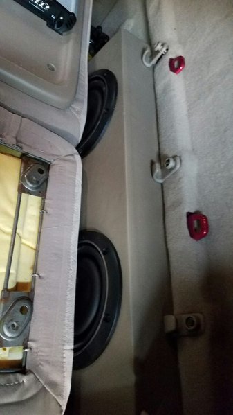

    Hey, I got a 2004 Tundra DC Limited and im wanting to put 2 10 inch subs behind the seats. I am struggling to find ideas on how to do this, any help or advice with be greatly appreciated!

    best bet would be to cut all the stuff out behind the seat like the cross member for the baby seat anchor and the jack mounts and build a box that would take up the entire space then get some shallow mounts
    since it’s a tundra you’ll probs be able to fit a sub thicker than a tacoma and i suggest 2 JL 10” subs
    we have 3 tacos and one has a custom fiberglass box molded exactly to fit behind the rear seats with 2 JL shallowmount 10s and the seat rear seats were pushed foward like an inch(best sound system), i have 2 pioneer shallow mount 10s and they’re alright , my parents have a box that fits 2 8” pioneers and all they had to cut out was just the jack and took mount behind the seat and it’s the perfect amount of bass for them
