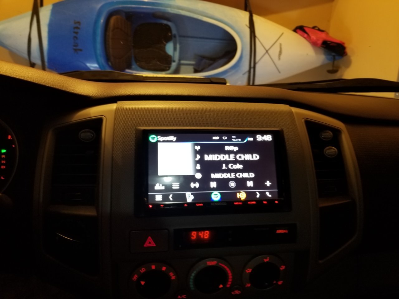

    Well there are lots of different kinds of aftermarket head units, and I don't have a stock one. I was in the same boat about not liking aftermarket ones until i found one i liked, ill post a pic in a sec. Also are you referring to a Bluetooth transmitter?

    I have no clue man I got my entire setup, new speakers and all as my graduation present. I used to use a bluetooth transmitter to and trust me the sound is subpar once you hear nice audio quality 20190215_214824.jpg
