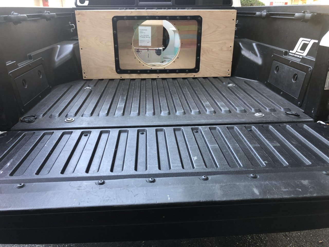

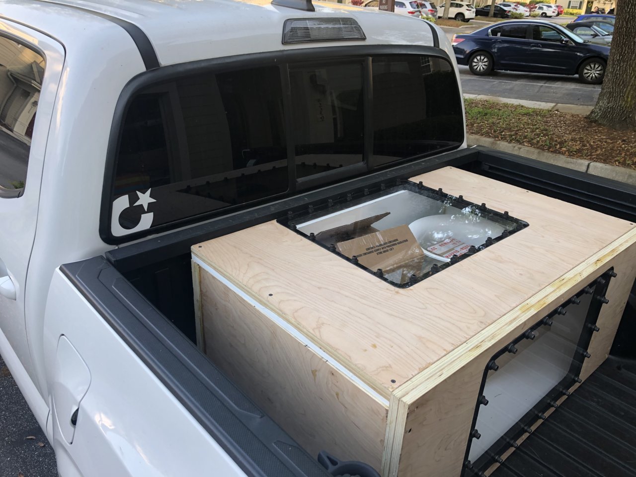

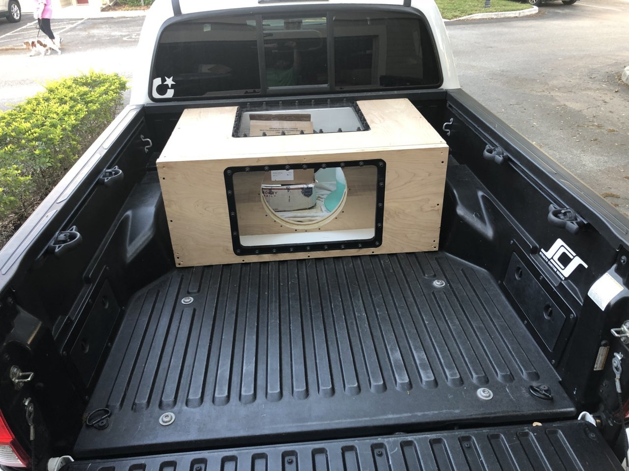

    box/enclosure in the bed with the port into the cab. I have been working on one slowly. Here is some pics of it in the truck while I was moving

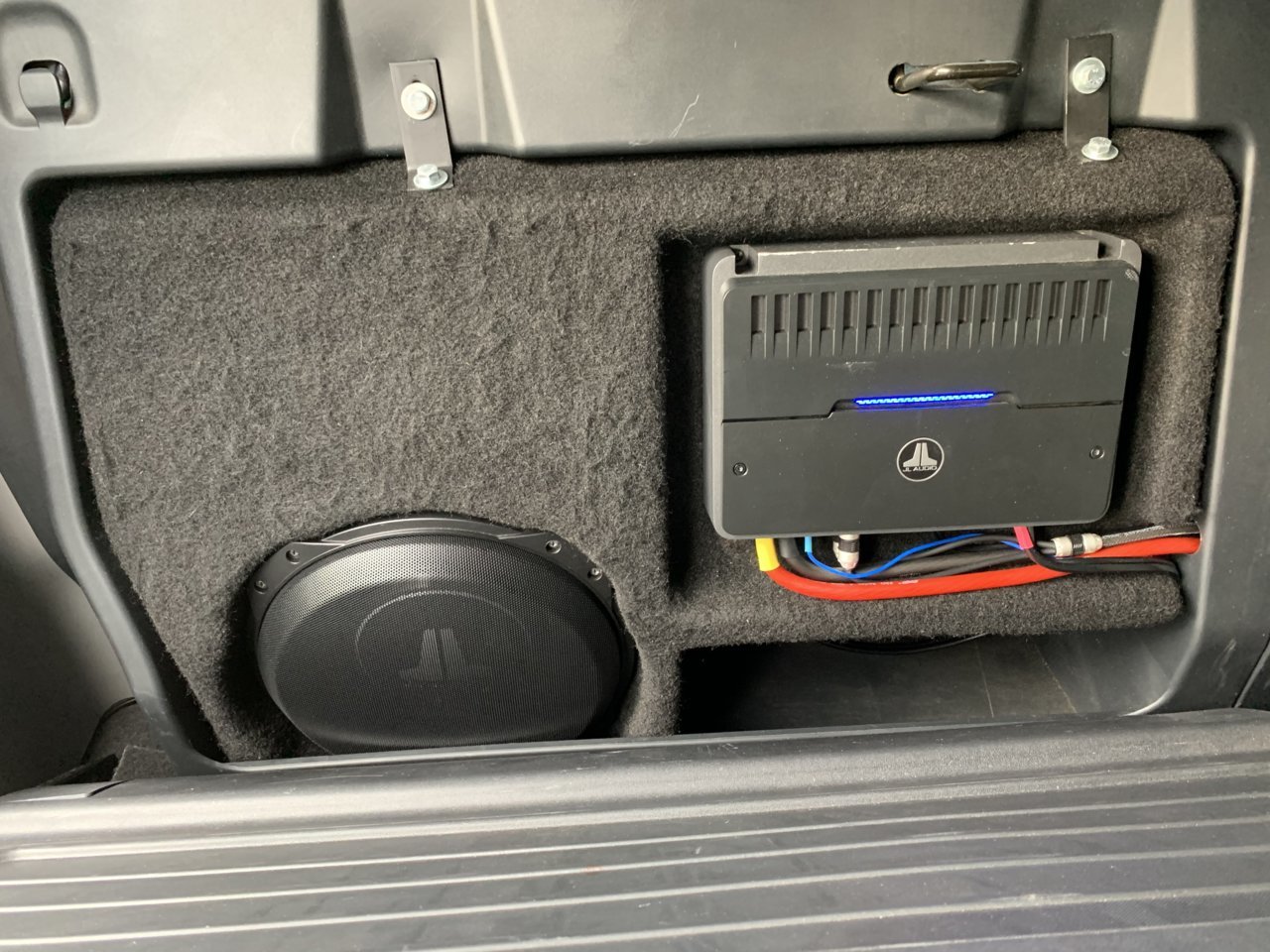

    Old setup - JL Audio sealed 10" stealthbox with JL Audio RD500/1D:

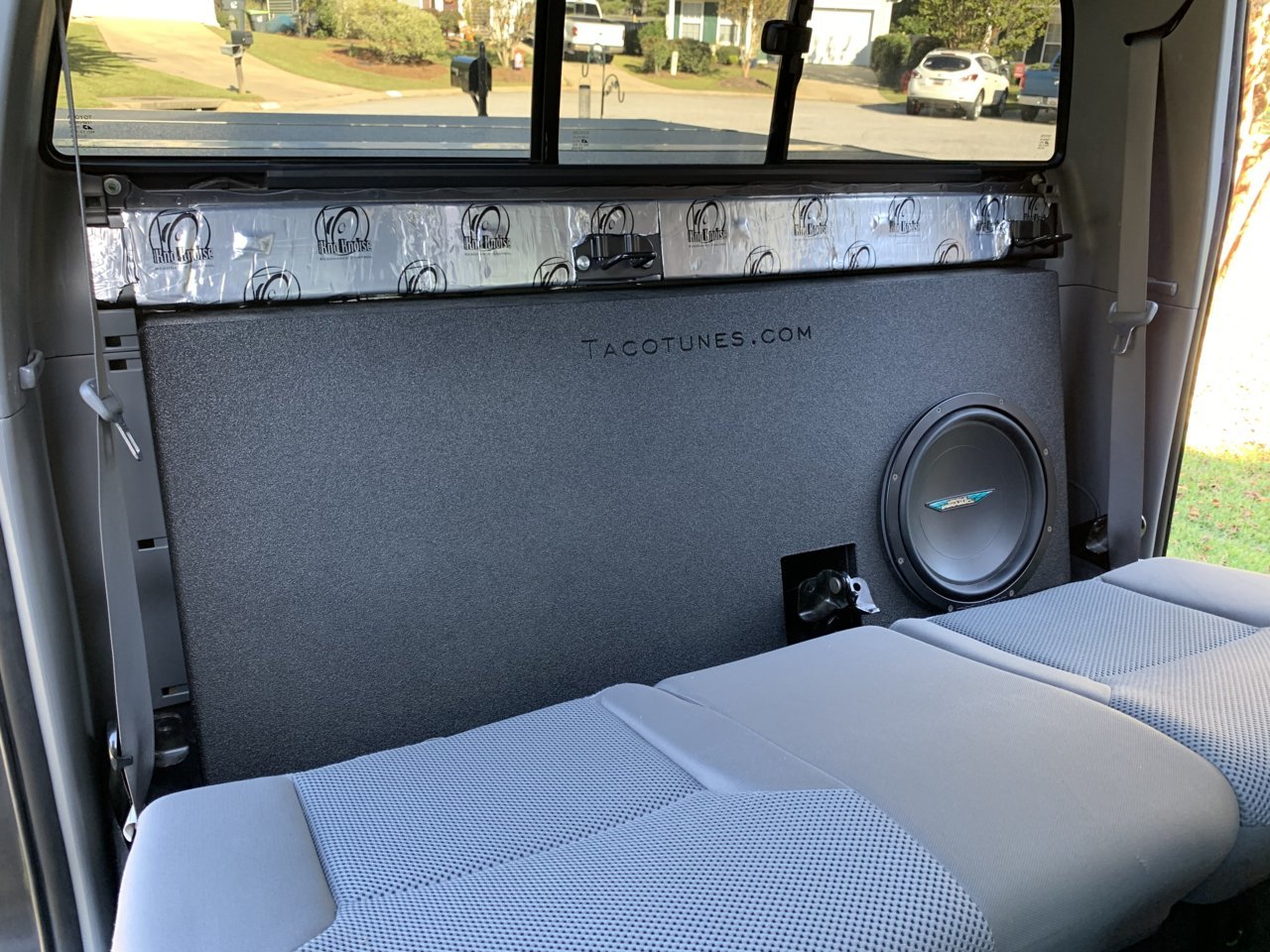

    New setup - older gen ********* 12" ported box with an Image Dynamics IDQ12D2 sub wired in parallel to 1 Ohm (rated at 750W RMS). Being driven by an old Precision Power Black Ice 2600.1D rated at 1300W RMS at 1 Ohm (gain set low to not overdrive the ID sub):
    Pic is before I put the rear seatbacks back in. They go back in fine, but you are no longer able to fold them down all the way.
    I just helped a friend this weekend install a complete stereo setup in his 2015 double cab Taco. For his low end he got the newest version 12" ported box from ********* with an IDQ12D4 sub. Wired his sub in parallel (2 Ohms) and have a JL Audio JX1000/1D driving it at 1000W RMS. Pretty much hits just as hard as mine. With this setup you will have more then just your rearview mirror shaking. The rear glass flexes if you really push it!:p
