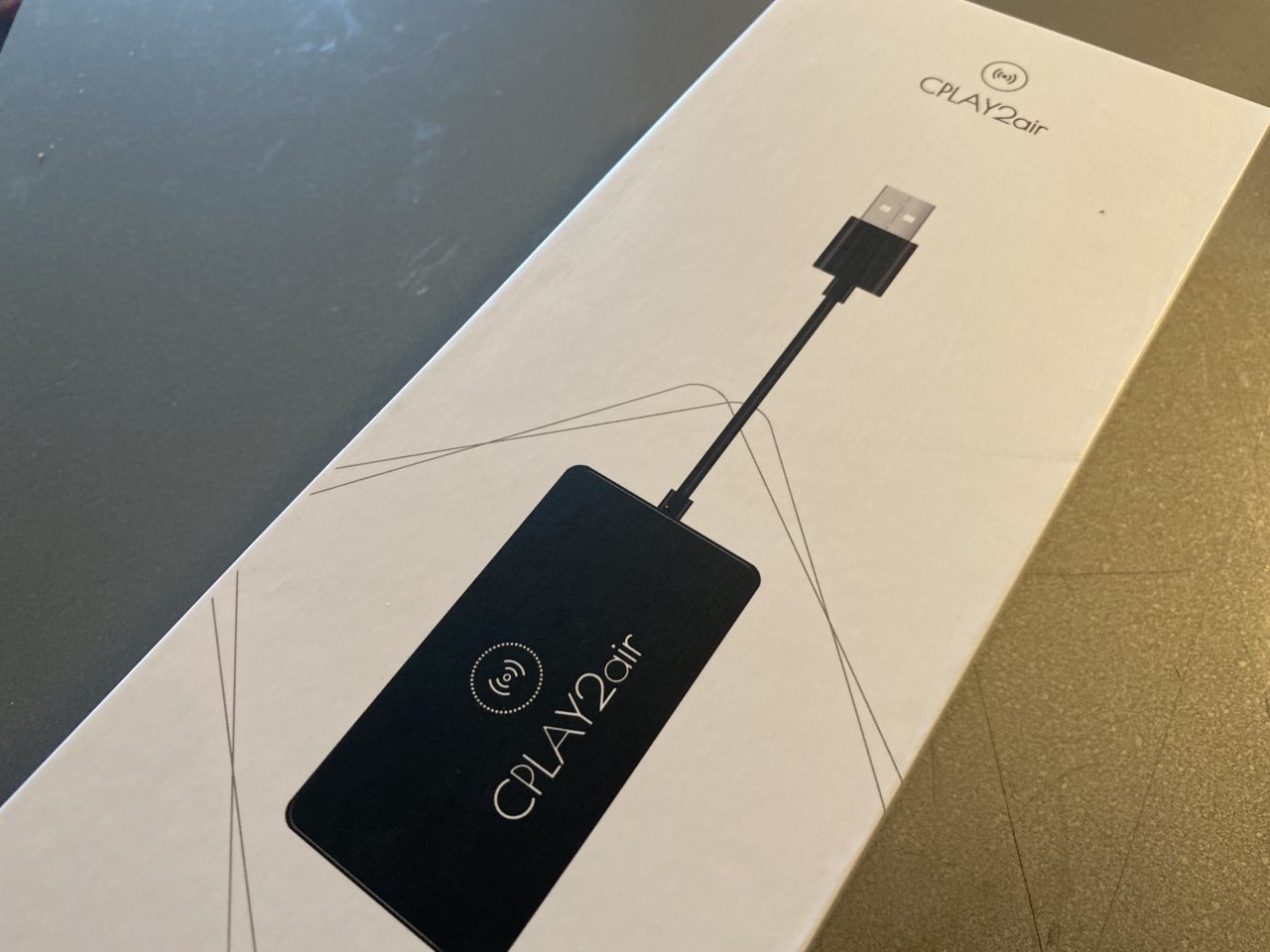

    I’m super geeked about this. One of my favorite features of the 2020 models was the inclusion of CarPlay (at OEM equipment) and the Qi (wireless) charging pad. That said, I’m disappointed that it lacked the ability to support the newer wireless CarPlay connection. Here’s a way to solve for that.
    The CPLAY2Air adapter (https://carplay2air.com/) plugs into the USB port and when the unit is turned on, it provides an interface on the actual head unit to configure and connect ones iPhone through Bluetooth to support wireless CarPlay. It’s small, easy to setup, and thus far, appears to “just work”. Now I can cut the cord and use the Qi pad for phone charging when needed.
    I’m not thrilled with the location and have a 90 degree USB adapter that will be delivered to allow a better positioning, but I’m still planning to fix the small CPLAY2Air adapter in the same general vicinity.

  2. Mar 14, 2020 at 5:29 AM

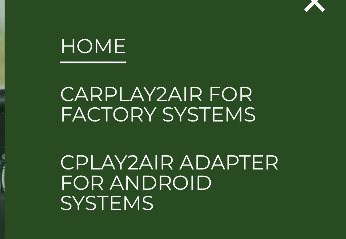

    From the same website they have an aftermarket one for android use it looks like here are their options for adapters 81F0A674-0DE3-4E7D-AC42-D09DF96672AB.jpg

    fully functional CarPlay connection. Everything works including call answering and the beloved Siri button on my steering wheel.

    I’ve been running errands today and in and out of the truck several times. I’m not even taking my phone out of my pocket and it just starts up and works. No complaints or issues thus far.

    Looking at the site, I think they mean it allows you to use your Apple phone wirelessly with CarPlay with a head unit that is based on Android, not use it for connecting an Android phone for AA wirelessly. Hopefully that makes sense, but basically the jist of it is it doesn't help with Android Auto (wireless or otherwise), from what I understand.
