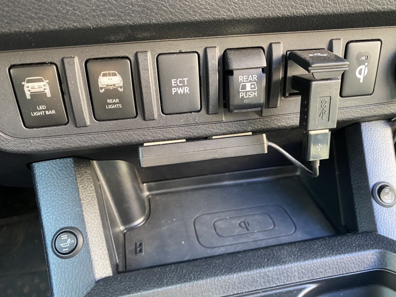

    This is not mirroring, it's carplay. You can use any apps that are carplay compatible, but the format is in carplay. I use waze, audible, Amazon music, music for itunes and on the phone, text messaging just to name a few and apple maps works fine. Also access my homekit stuff like opening and closing my garage door well before I get to my house. However it doesn't mirror apps that are not compatible. You aren't going to be able to pull up netflix or youtube.
    I left my USB location alone and I just took some velcro and mounted it below the USB connection in the top of the cubby hole right there.

  12. Apr 29, 2020 at 9:38 AM
    #32
    DamGuide
    DamGuide Well-Known Member
    Nov 29, 2019
    #312054
    671
    Nooga, TN
    2020 TRD Offroad
    Here's how it looks in my truck

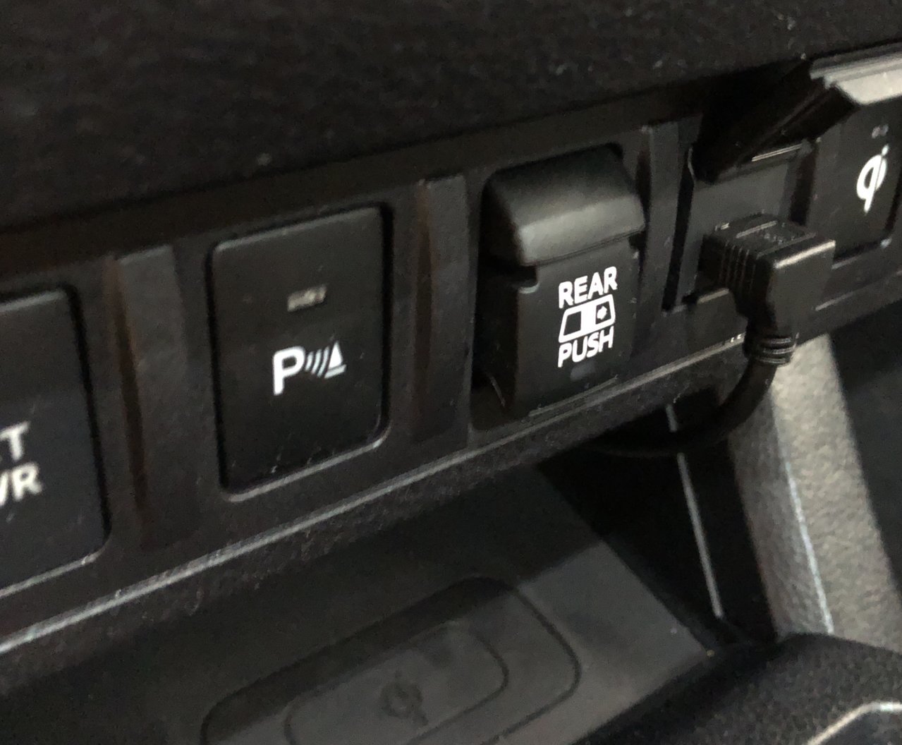

    3” long right angle usb extender cable adapter from a truck stop works fine. I tried a plain right angle USB adapter, but it protruded more from the dash than using the straight plug.
    A90E8850-8F2B-4774-A792-12DEE9E8C8B4.jpg 732F1B89-2046-4E26-8C31-A25D873EDA60.jpg
