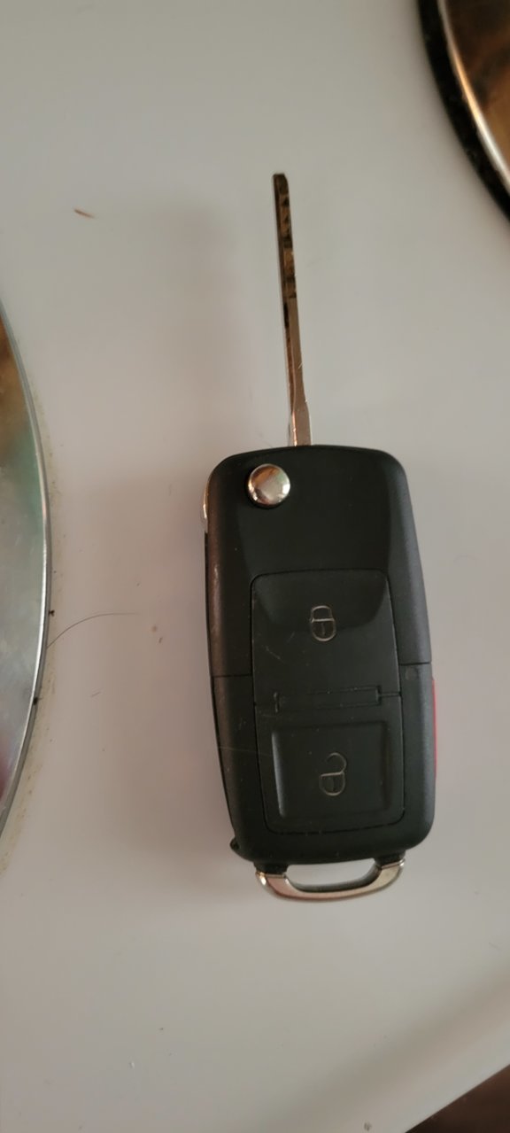

    Why was this all so easy on my '14 base model? I guess I don't have the chip in my key.
    The truck came to us with only 1 original key and no remotes. I got a duplicate key cut for $5 and it is just a plain metal key with no plastic parts. Ordered 2 remote fobs off Amazon, and one flip-key remote shell off eBay. Got everything working lickety-split by using that trick where you turn the key off and on, open and close the door, yadda yadda.
    My only real problem is the other keys in my pocket seem to press the buttons on the flip out key remote fob. So this results in the truck accidentally locking and unlocking itself when I bend down to tie my shoe or some such thing.

    Well I think I just got lucky. Locksmith wanted $40 to cut and program my ebay key with no warranty. They made several attempts and could not cut it to open door or turn ignition. No start. No program. No charge. So I paid $100 for a new key cut and programmed. They made a non chip key to check the cut before wasting a chip key. So I walked out with my ebay key cut only, a door only key and a new chip programmed key for $100 even. Being a machinist I figured I would measure and compare the ebay key to the original and new programmed keys. Only difference was the cut started 0.030" earlier, or closer to the end, on the ebay key than the others. I put it in the door and pulled it out 1/32". Opened the door. I put it in the ignition. Pulled it out 1/32". Turned the ignition and STARTED THE TRUCK. They did not program the ebay key. Why does it work. I don't care why. All I know is for $100 I have 2 new chipped keys that work plus a door only key. With the locksmith keys, the ebay key and new fob I am out a total of $117. The cheapest local dealer wanted $120 plus tax for 1 new key cut and programmed. It's like winning on a scratch lottery ticket.

    I would retry your ebay key with the other keys not nearby or in the car. Your new chipped/programmed key could have allowed the ebay key to work just by being nearby. It would probably allow your door only key to start the truck as well.
    But at least you got one fully working key!

    Well I left all keys in the garage in the back yard. Went to the truck in the front yard 90 feet away. Put ebay key in and it started right up. Now can you explain that. This key was in my pocket when they were out front programming the one single key to my truck. I am quite baffled.

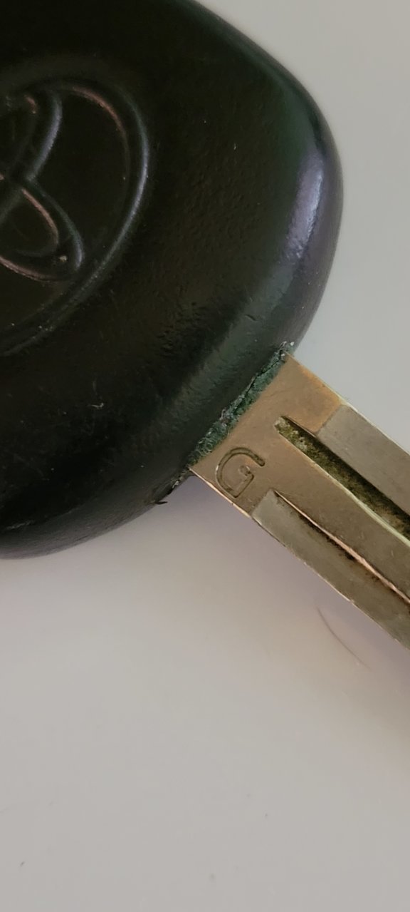

    I think as long as you have a "G" key you are good to go
    The techsteam deal didn't work for me but I used this forum and found someone with techstream nearby and had it programmed in less than 2 minutes. Only cost me a 6 pack and the flip key. I used the same link that is on post #1 and it's been fine for awhile now.
