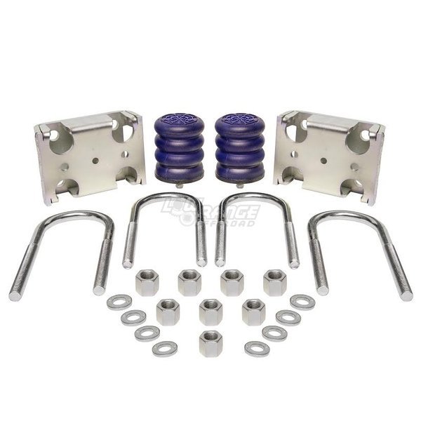

    Low Range Off road's post says 80% compression and 4" tall so compressed height should be ~1"

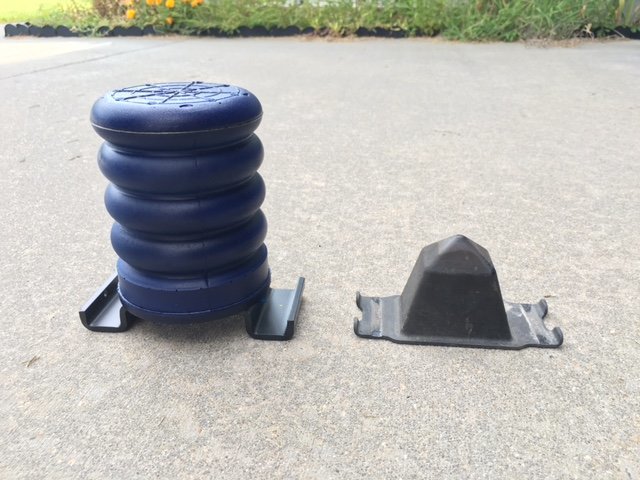

    here is a picture of a sumospring model ssr-610-40 beside a factory bump. This is the tacoma specific one, for trucks without a flip kit. Low range's flip kit uses a smaller sumospring because it is elevated by the flip kit . You can see it has fewer "humps" though I assume it is the same diameter. If low ranges sumo is 4 inches, and each "hump" is an inch then the regular sumo looks to be 6 inches or so. Though they say it can compress 80%, people are hauling heavy loads and towing with sumos and stock springs with very little squatting.
    Maybe they are too tall to use as bumpstops on a lifted taco, if they don't readily compress.
    If the tacoma specific sumo is too tall to use as a bumpstop, maybe this woukd work. This looks like just the upper part of the low range kit, perhaps this could be mounted to the frame above the axle. I see flip kits for 64$, these bumps are 125$, so for sub 200$ you could be flipped and bumped with an install you can do yourself.
    http://autoplicity.com/8069634-super-springs-ssf-106-40-sumosprings

    Love that sumo flip kit bundle
