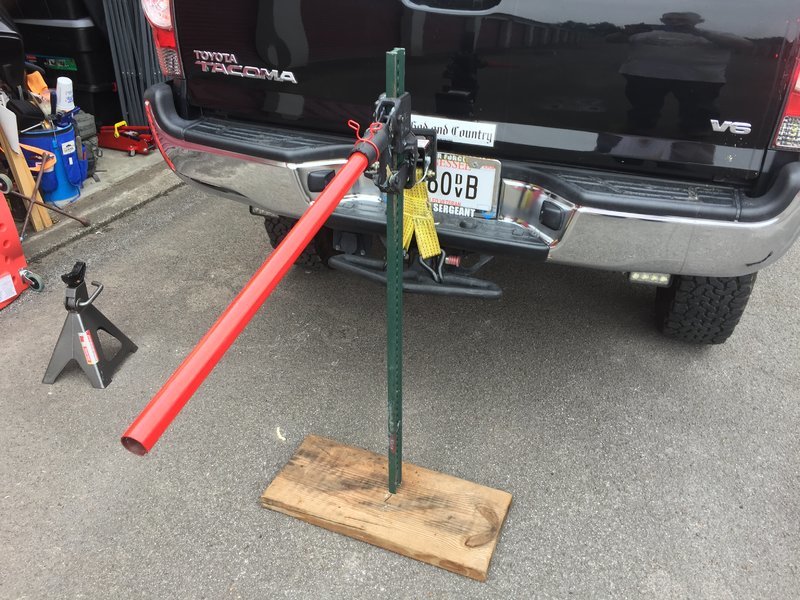

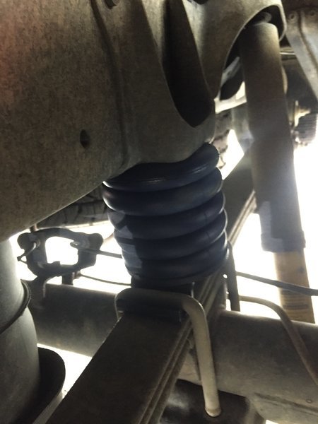

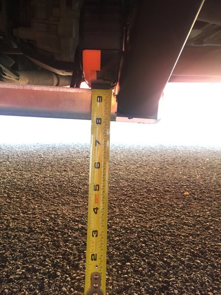

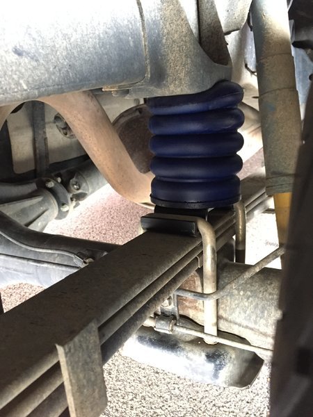

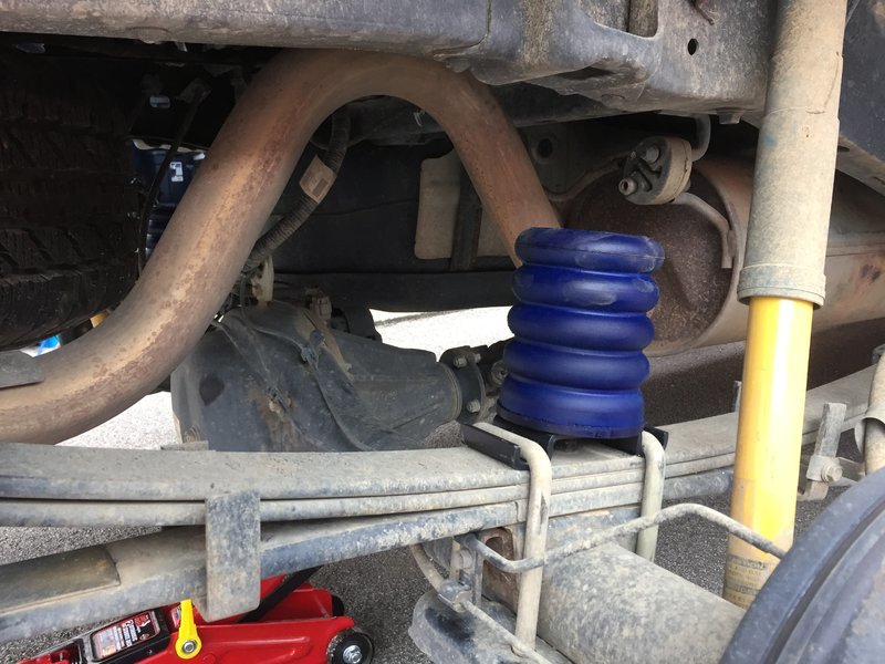

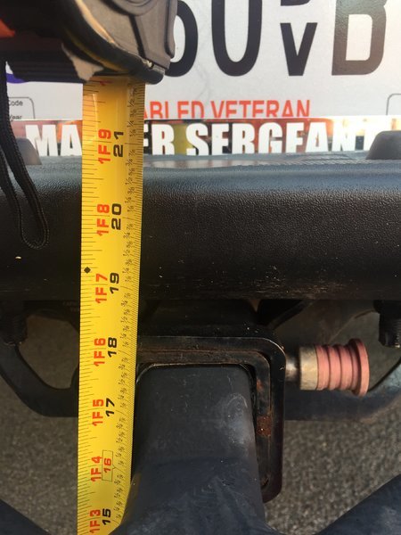

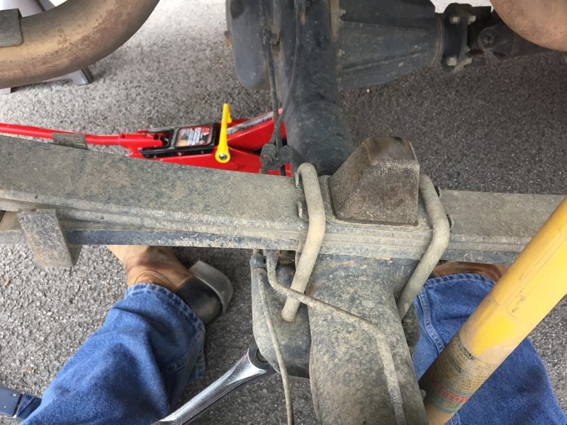

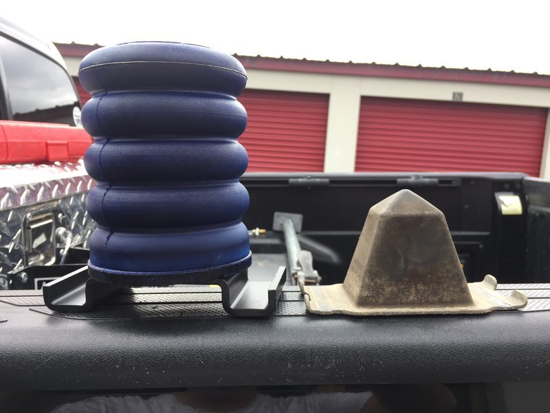

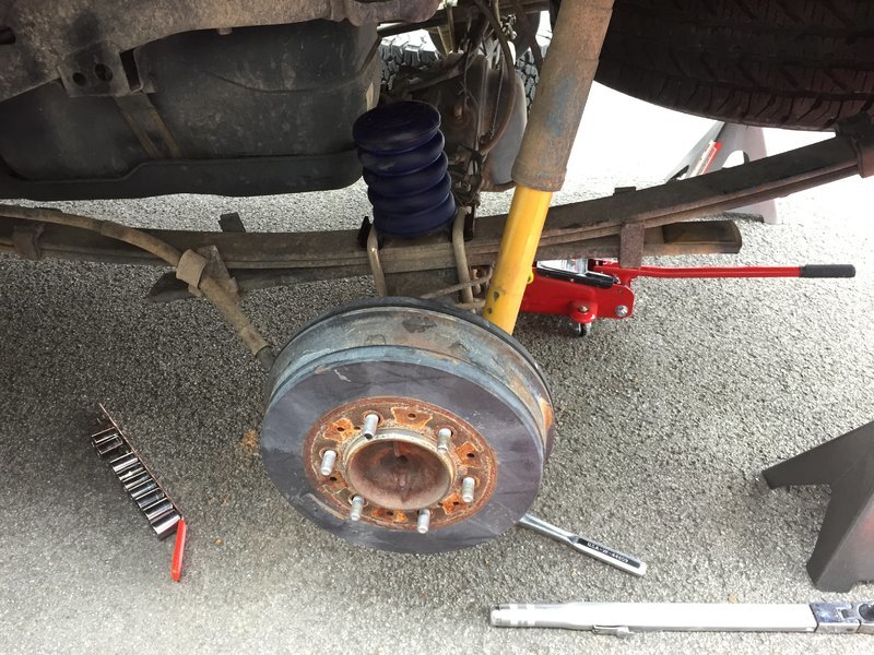

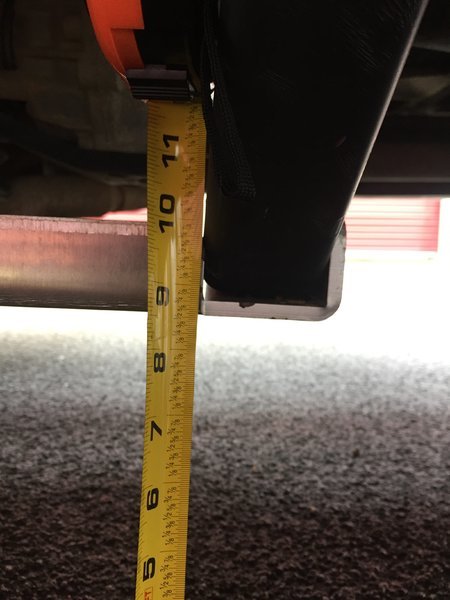

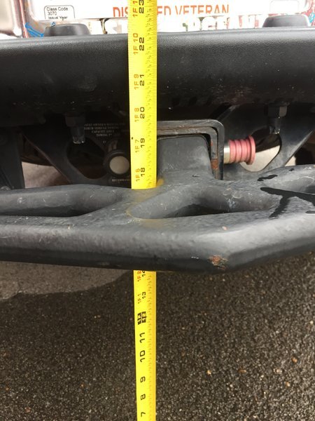

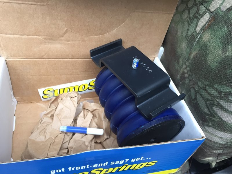

    I worked on installing my SumoSprings today. Some success and some failure. I tooks some base measurements, then I started with the rear springs. That actually went fairly well. I took my wheels off to make the U-bolts easier to get too, but that is not actually a required step. The spings come with the base screwed on, but you'll need to unscrew them and add loctite (supplied) to the bolt. You'll need a 19mm socket. When you loosen the U-bolts it won't be neccessary to completely remove them, but you do need to back them off till there is only a couple treads left to get the new sumo's mount in place. I started with a breaker bar, but found it wasn't neccessary. A standard 1/2' drive ratchet work just fine. Retighten the U-bolts and torque to 75ftlbs. Intallation of both sides took me about 1&1/2 hours. And I move a lot slower than most folks. Some of you I'm sure can get this done in less than an hour. Once everything was on the ground again I re-measured the hieght of the bumper and skid plate again. The bumper was about 1.5 inches higher and the skid plate was .75 inches higher. I'm going to drive them for a few days and then measure again to see if they settle.
    Base meaurements: Top of hitch 18 5/16" and skid plate at 7 3/4".
    Separte the two pieces and add loctite.
    Sitting back on the ground.
    Post installation measurement: Top of hitch 19 3/4" and skid plate at 8 1/2" (not driven on
    Spintly and IronPeak[OP] like this.
  16. Sep 17, 2016 at 3:45 PM
    #76
    KRAMERICA
    KRAMERICA Old Man Mike
    Mar 22, 2015
    #151504
    3,859
    Middle Tenn
    '18 F250 Super Duty
    A couple of rear window decals...
    The front was another issue. The supersprings website says to use CSS-1094 for the 4WD trucks. With the suppension at full extention they wouldn't go in. I made a significant effort to get the Sumo's installed, but they just wouldn't fit. I eventually got out the caliper and measured them, I found that the space between my coils at max was .7230 inches, the center of the sumo's measures .9485 inches. I'll contact the Supersprings and find out what up. Autopolicity has two models listed the CSS-1094, and the CSS-1125. I went back to supersprings website and the 1125's are listed for the 2WD Tacoma's. All I can say at this point is something aint right!

    I did lube them with soap as their installation video suggests, and I had them pretty slick. But getting .9485" thick sumo spring to fit into the .7230" space between the coils wasn't working. I just couldn't compress them the extra 1/4" I need to get them started in between the coils. If I could have gotten them started, I think I could have gotten them on. I watched several video's on YouTube of other people installing them on other types of vehicle and none of them seemed to be having the same kinda trouble I did.
