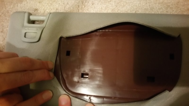

    Hey guys need some help on this one. So base models as you know don't cone with a mirror in the sunvisor, not such big deal for me, but the wife always claims about it. So after looking up a factory one and seeing it cost $$$ I'm ttying to figure how to add one. I noticed after feeling around the one I have there is something underneath the fabric like a cutout. I was woundering anybody cut it open and find out what's in there.
    If not what have you guys done to add one. Glued on, taped on, velcro...

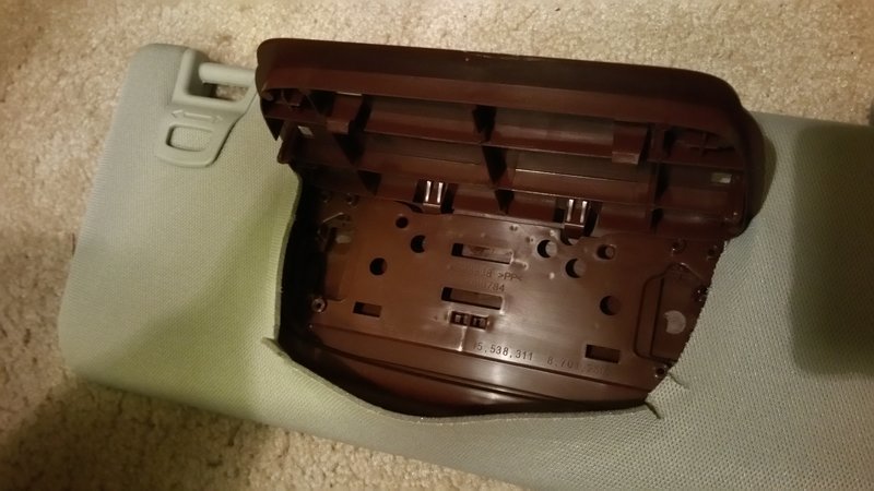

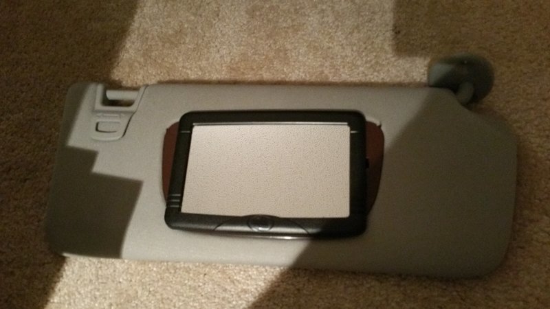

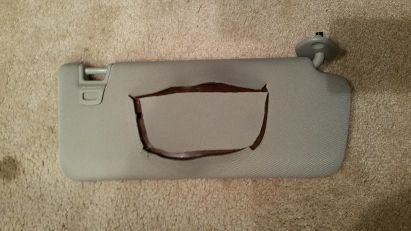

    Well my curiosity got the best of me, I cut it open. It has the basic setup for the mirror but no mirror. So I got one from my local auto parts store, and used some double sided tape to attach. Looks good for now, until I can get one from a wrecking yard.
