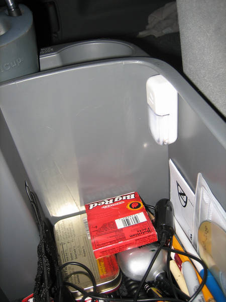

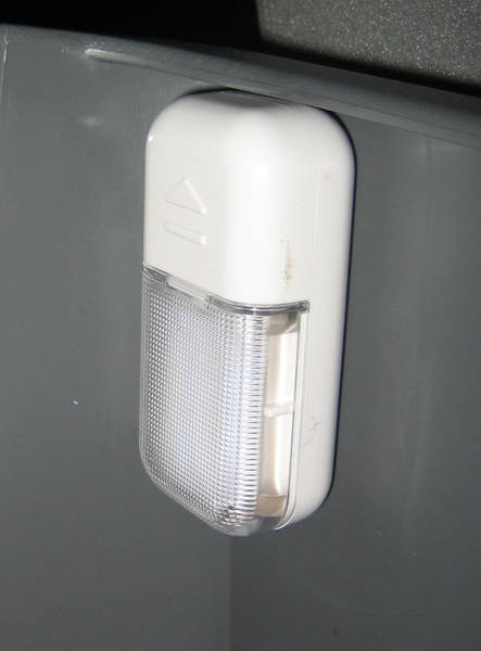

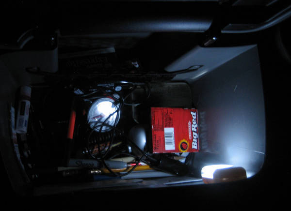

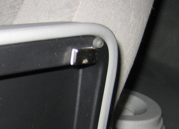

    My wife bought these little magnet-activated, battery-operated LED lights; they came in a 10 pack (as seen on TV!) and she only used a few. I've found many uses for the rest including a nice way to light up the center console without any wiring. Each light has an adhesive strip on the back for mounting and another on the back of the magnet that is included. Simply stick the light and magnet where they will be very close to each other when you want the light off (center console lid closed) and as soon as they are apart from each other (lid open) the light turns on. The pictures probably explain it better than I can with words:
    The light:
    Where I put the light so it would not shine up into my eyes:
    Where I put the magnet on the console lid:
    The light when activated at night:
    I have verified on several occasions that the light is off when the lid is closed and so far I've found it very useful. If you choose to mount the light someplace else, just make sure you put it where you can open the battery compartment to replace the three AG13 batteries. I think this light will also work well in the glove box, but I haven't explored this idea any further. As to where to buy these lights...I'm not positive....Edit: these lights have been available recently at Harbor Freight, Wal Mart and Home Depot.
