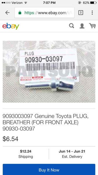

    Now i am looking to do the diff breather mod for my 06 Tacoma. I cant find the exact part number of the diff union breather i see in pictures. But i am seeing the breather from the front axle. I assume it would still work since its the same concept, but i wanted a second opinion real quick.

    If you are moving the rear diff breather; yes it will work. You still need the threaded end to screw into the rear dif. Its a strange thread so I ordered the Toyota part.
    This is what I ordered:
    Parts List:
    From your Toyota dealer ($12)
    Union, part# 90404-51319
    Breather, part# 90930-03136
    Alternative that some have used:
    Toyota Part numbers:90404-51026 Camry Union and 90930-03136 (Breather Union)

    Awesome, thanks guys im gonna go with the one Darkgoatracer put up. Cheaper overall price, i got all the other parts already. Cheers!
