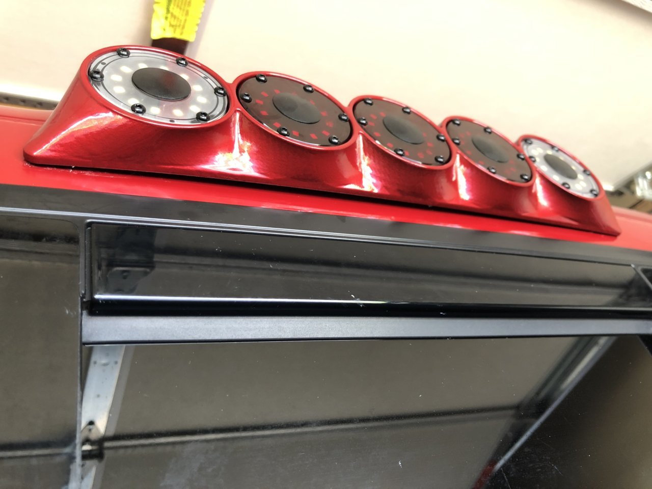

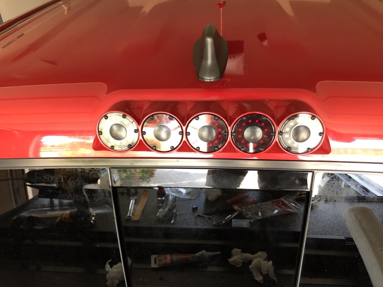

    Finally completed this project with the day off yesterday! The paint match is still growing on me.. black would have probably looked better with the BR.
    37C5BD17-86E0-4A9E-BB9B-0EB942FE2D0F.jpg 3F35323A-5D6F-433D-9635-6E66ED465D8A.jpg
    Only issue was this thing was the final step of mounting the bolts. They are wedged up against the two outer lights, so much so I couldn't get the left one alligned and it's causing the housing to bow out. Is my only option drill the holes on the cab a little wider and go with a jack nut?

    I think the color match looks great! My truck is black, so mine already matched.
    I had to drill out the cab holes to get everything to line up. Didn’t want anything in a bind. I just drilled them larger then used a little paint to prevent rust. I also put a bead of RTV silicone on the housing, around the wiring and around the mounting bolts for the lights to help seal everything.

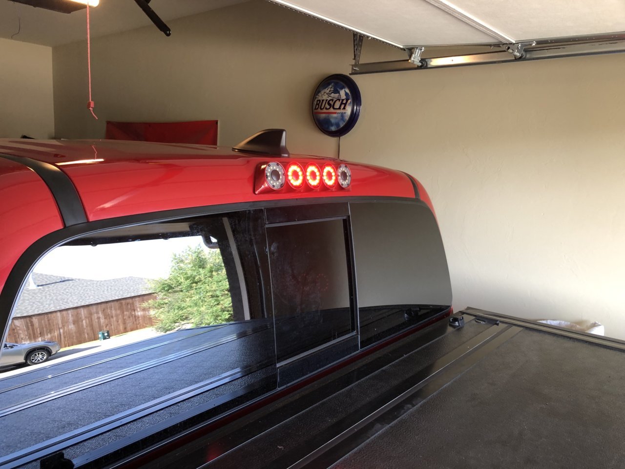

    Avid front bumper guard OVtune HPS Intake Tube Meso designs counting
    Not a great pic, but it's raining..again, so it's in the garage till the silicone cures. Thanks for the awesome product @MESO I went with 3 white to see how much it'll throw at night when messing around with things behind the truck. Also, thanks to @cruiserhead for a great write-up, my light was already cracked so I did not mind trashing it at all..:smash:3rd light.jpg
