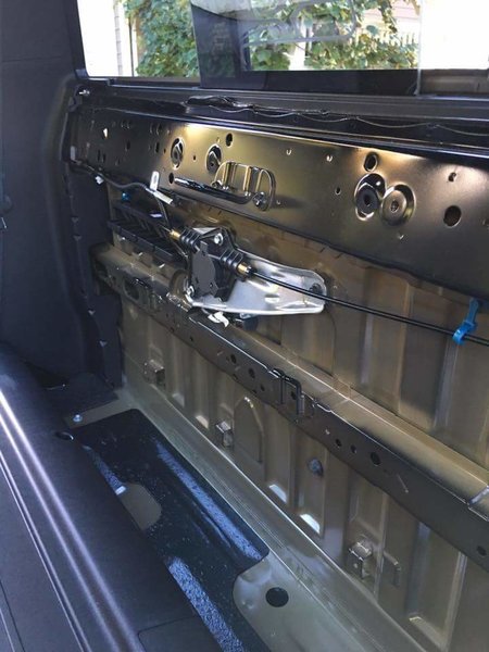

    I'm experiencing this same issue and I also suspect it's a ground issue. I'm going to pull it apart soon and beef up the ground. Anyone have a good ground location near the third brake light?
  9. Oct 13, 2019 at 7:30 PM
    #2949
    Caboose117
    Caboose117 foul mouthed Marine
    Aug 3, 2014
    #135375
    4,703
    Chad
    Kentucky
    ;IGY6 Rescue Truck
    smashed this, broke that, covered it up with tape and paint
    Go down the C pillar on one side and tie it to your seat belt bolt. That will no questions asked be the best place to ground. But you could also attach to the latch on the back wall of the cab that holds the back of the seat back but that would be more of a pain
    aside from that
    I’d avoid tapping into anything that is on the same ground as your radio

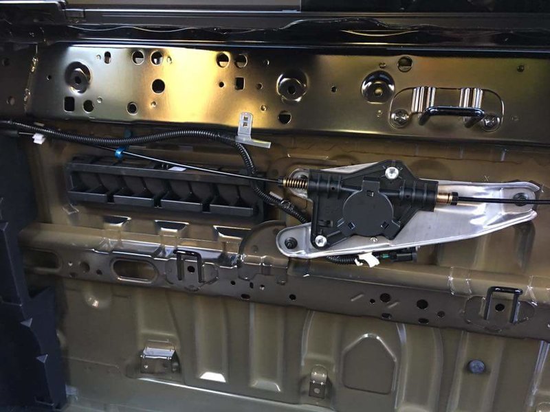

    If you by some chance have a sliding power window
    or a moon roof
    I might try grounding to those
    just not your radio
    Inferno__Taco and Boomer3731 like this.
  13. Oct 13, 2019 at 7:38 PM
    #2953
    Boomer3731
    Boomer3731 Well-Known Member
    Aug 22, 2016
    #195239
    484
    2017 DCSB TRD Sport
    Looks like the wiring for the power window runs to the passenger side.
  14. Oct 13, 2019 at 8:02 PM
    #2954
    Caboose117
    Aug 3, 2014
    #135375
    4,703
    Chad
    Kentucky
    ;IGY6 Rescue Truck
    I would definitely try to ground off the same one it uses
