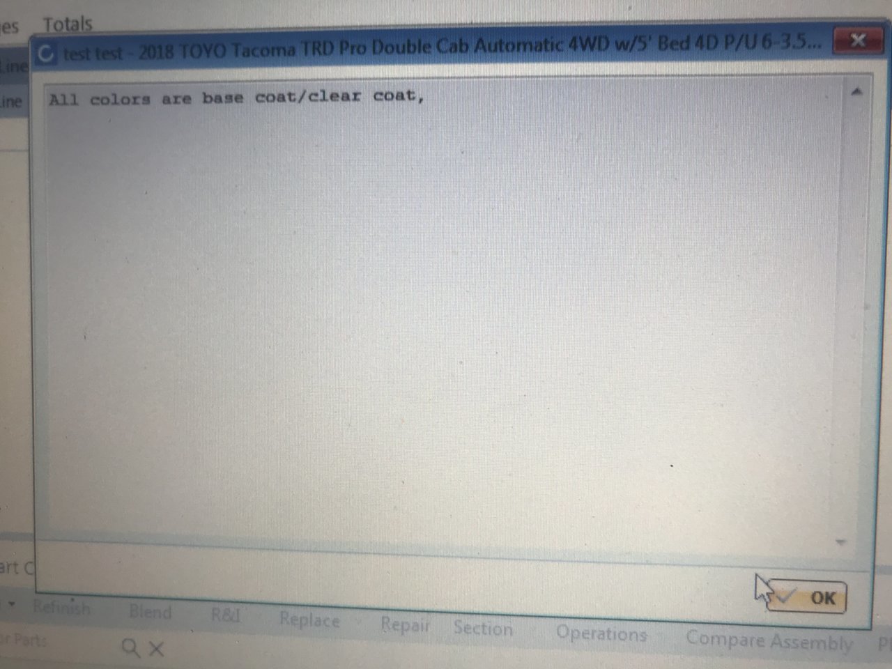

    dc7rr1
    dc7rr1 Well-Known Member
    Sep 22, 2018
    #267057
    240
    Danny
    SoCal - Montrose
    ‘18 DC TRD OR 4X4
    All colors are two stage.
    Edit: I looked it up in the CCC estimating system.
