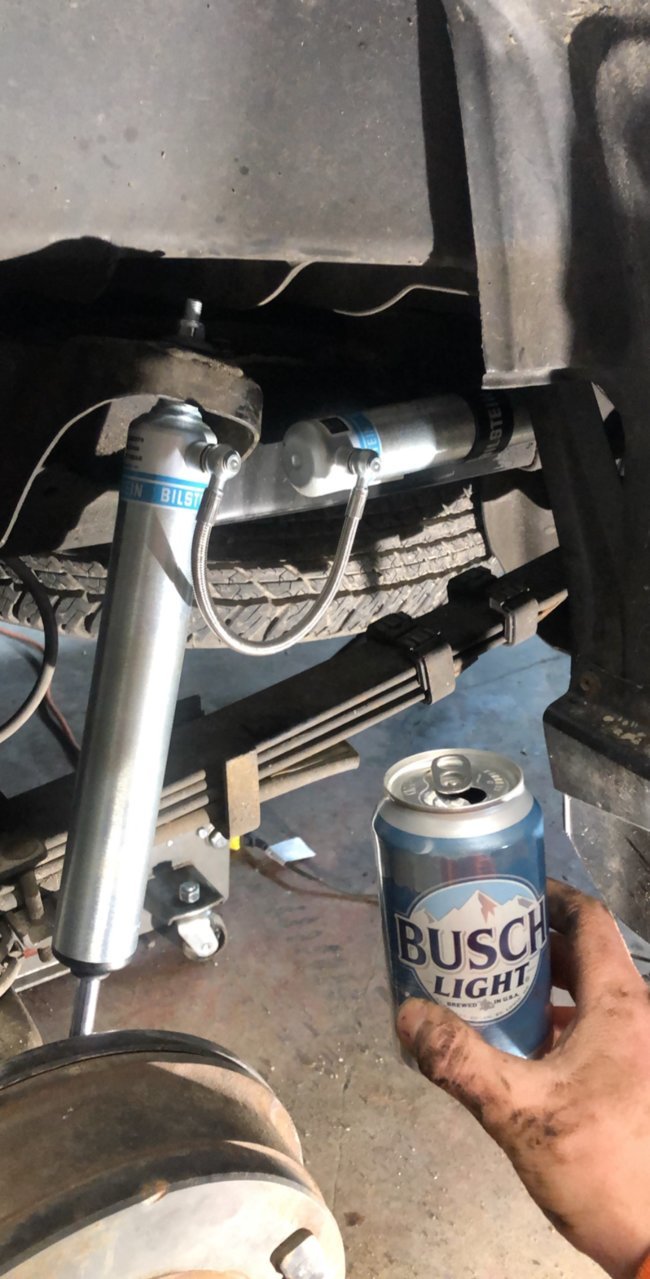

    I finished the rear suspension on my truck last night. Went with the Bilstein 5160s for the added towing and off road capability. Also added a front sway bar drop to keep the sway bar from clunking off my 885s when I was off road.

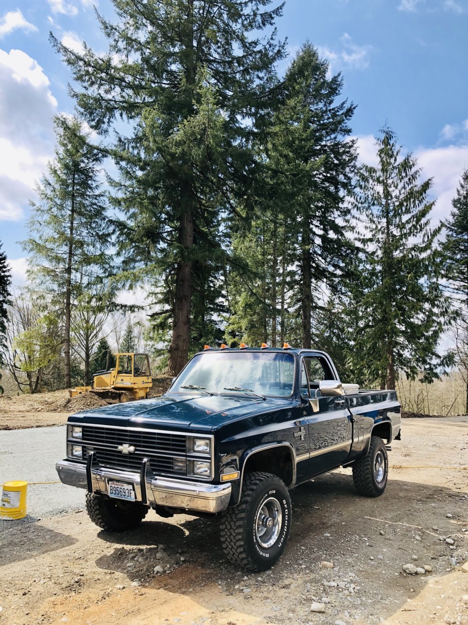

    Pulled out the Chev, new ubolts, oil change, and front and rear diff fluid flush/change. Still need to do driveline ujoints and give it a good washing but it’s getting closer to being on the road again after 4 years of mostly sitting.
