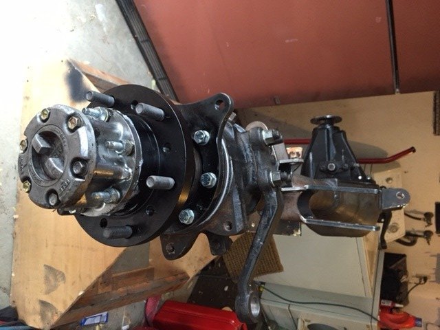

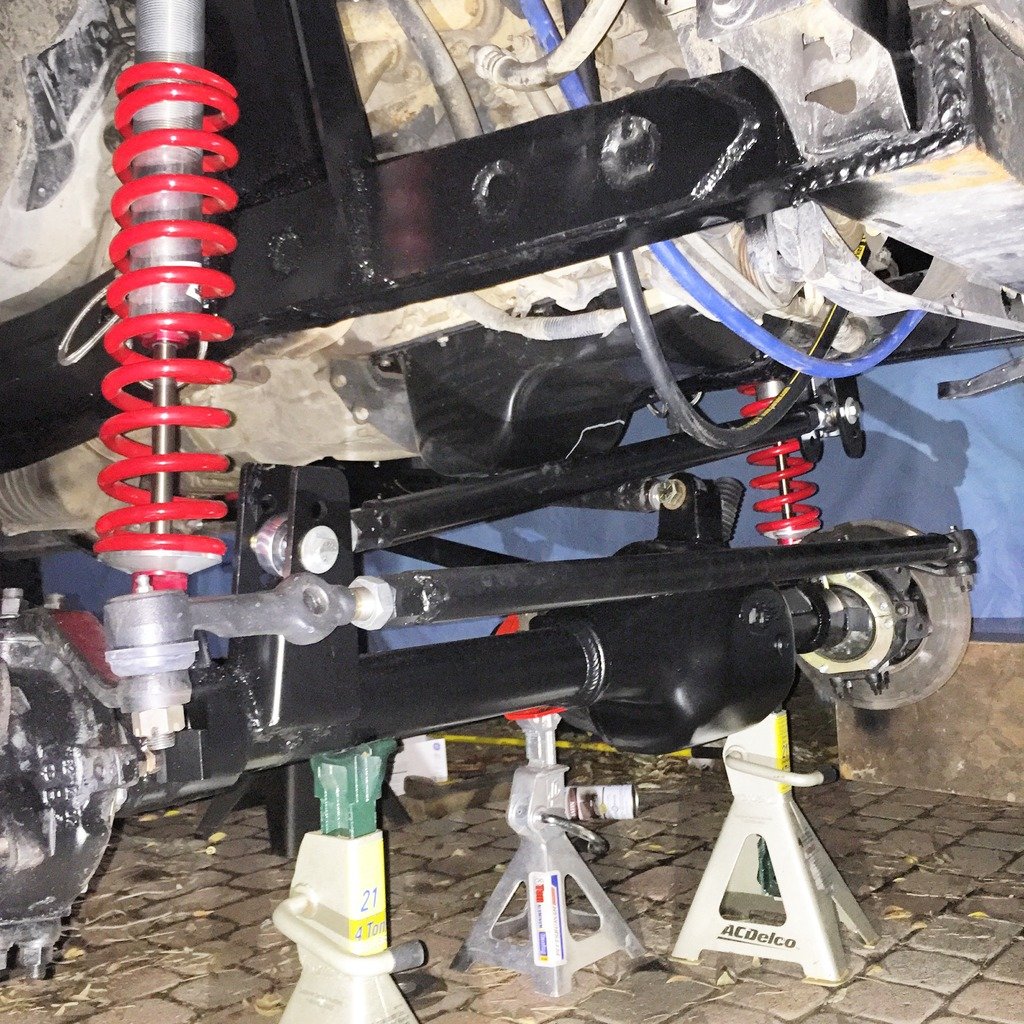

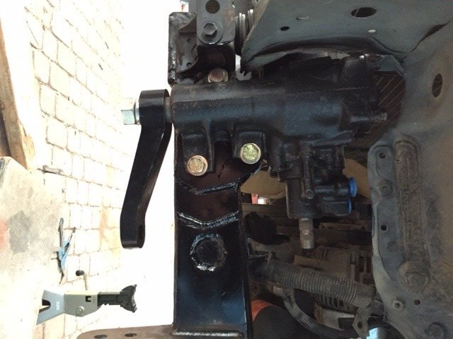

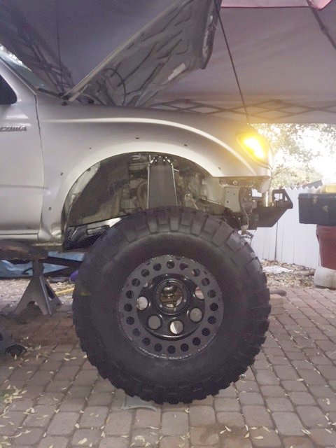

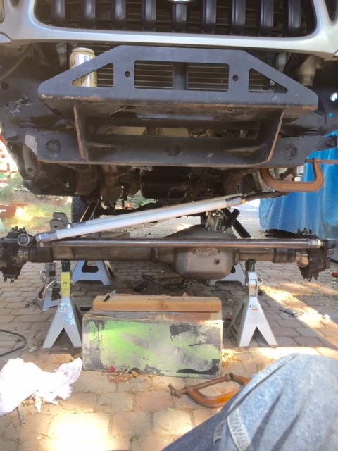

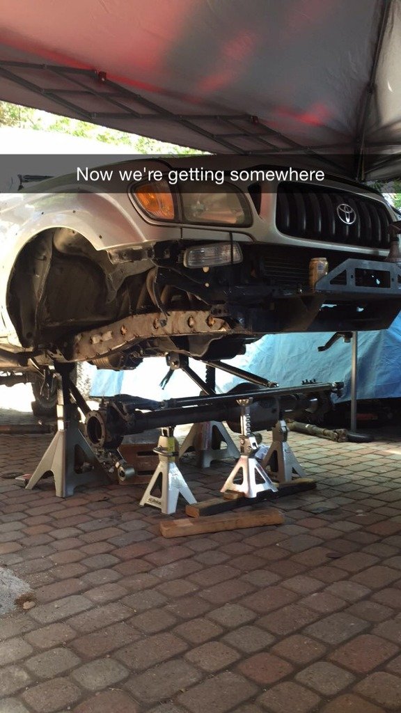

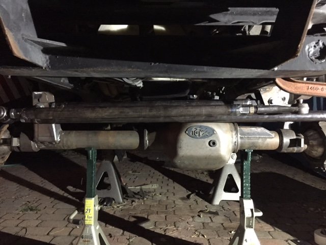

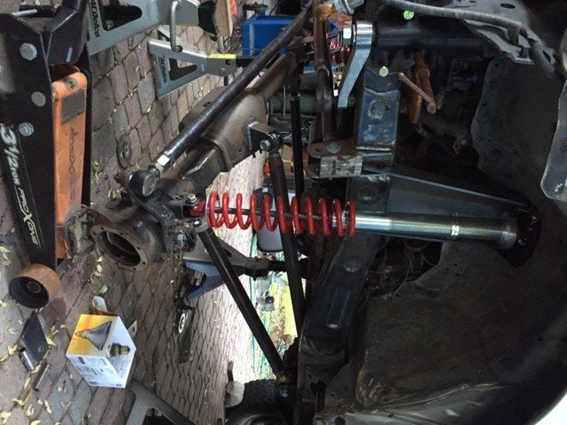

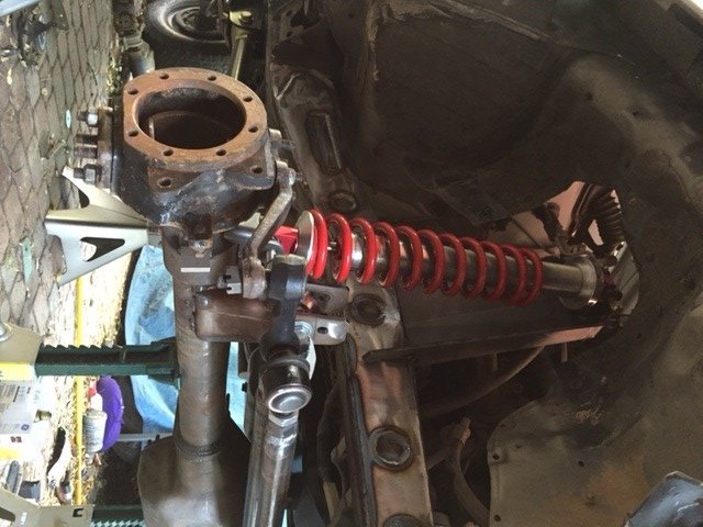

    Been lurking for a while and I'm almost done with my swap so figured I'd post it somewhere to get some opinions/flaming/whatever else anyone wants to say haha
    Found the deal of a lifetime on craigslist for a complete (all brand new) All pro 3 link with links, brackets, steering box, borgeson steering shaft, almost all the hardware, walker evans coil overs, all pro 3" leafs and a crap load of other goodies for $600....yeah $600... I ended up going with ruffstuff axle brackets instead of the dinky 3/16 brackets all pro supplied.
    So thats when I decided I was going with a solid axle for sure
    Specs:
    2002 Supercharger 3.4
    Rock assault elocker housing tacoma width with FROR tacoma brackets
    stock elocker rear
    5.29s front and rear (haven't re-geard yet, trying to be done and ready for hammers)
    3 link front with all pro frame brackets
    ruffstuff steering/panhard
    12" walker evans coil overs in ruffstuff 12'' towers
    FROR crossmember and skid plate
    etc etc etc
    Pre sas wheeling

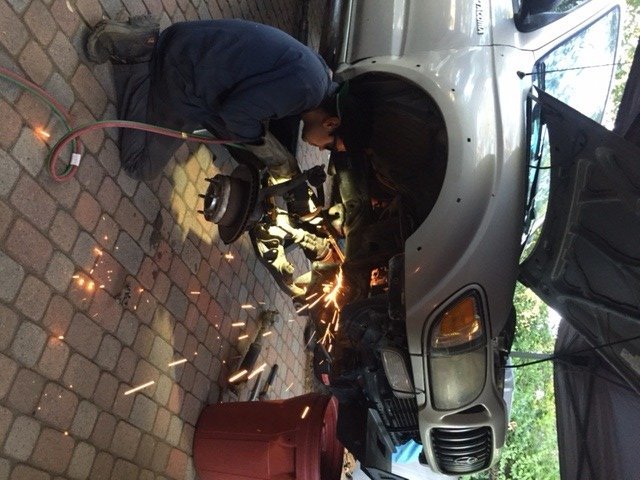

    My buddy came over to handle the torching (labor for truck parts is always nice, and I'm not very skilled with a torch) and so begins the real building.

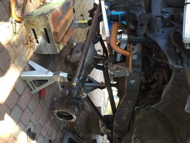

    Full Bump
    fitting shocks
    Full droop, well still and inch or two to go

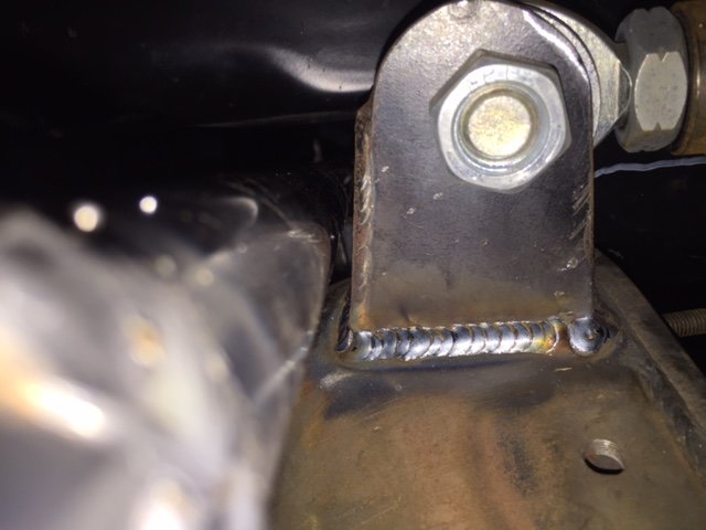

    Steering box mounted
    Tower notched for steering shaft

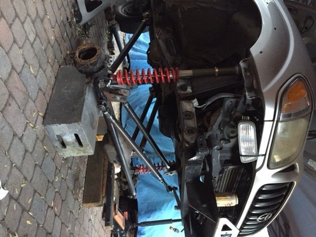

    MMMMMmmmmmmm
    starting to get an idea

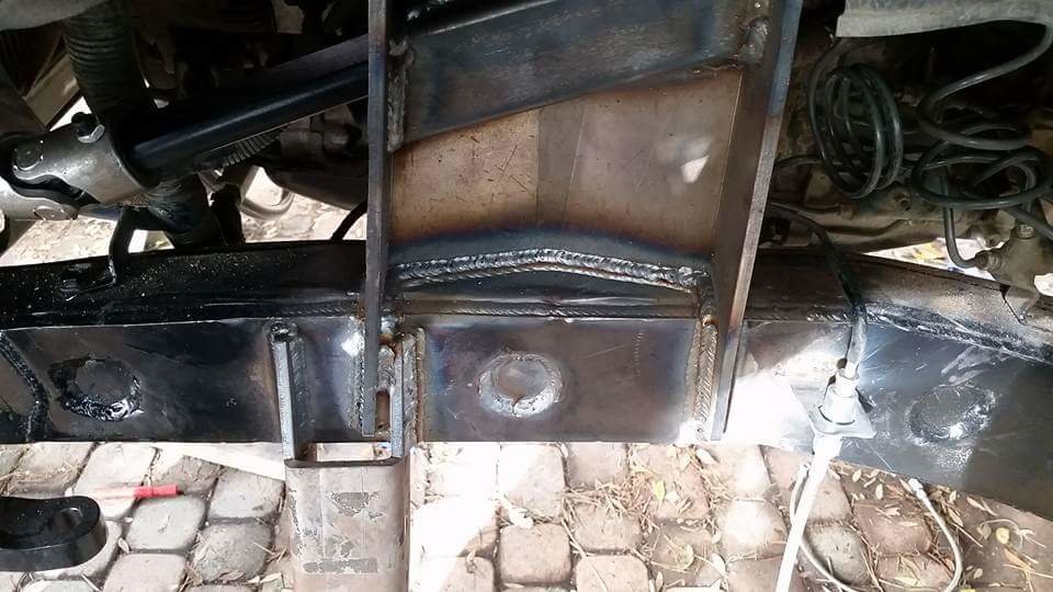

    Axle built
    Everything's painted now, starting to put it all back together tomorrow. Thanks for checking it out so far!

    Here she sits as of tonight
