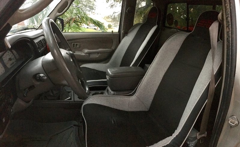

    Got these mounted up and I couldn't be happier, now my back and legs won't kill me as much on long drives. Yay for more leg room!
    I'll post a picture of them in the truck in the daylight

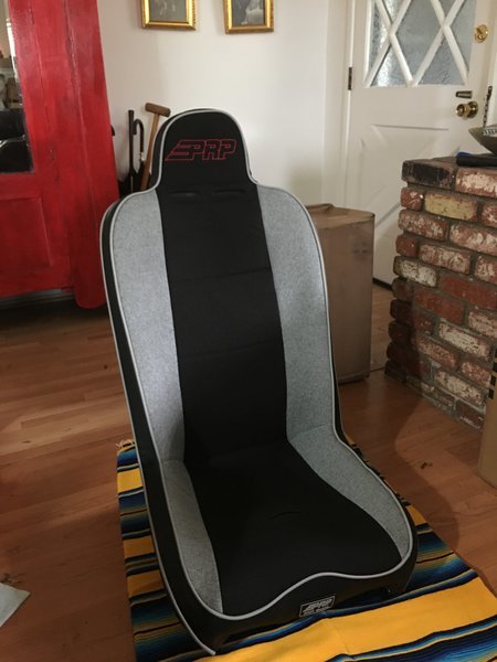

    I bought the Tacoma seat brackets from PRP which helped a lot, but I did need to drill the mounting holes out as it didn't line up exactly. I also had to unbolt the seat belt buckle and transfer it over. Pictures coming soon

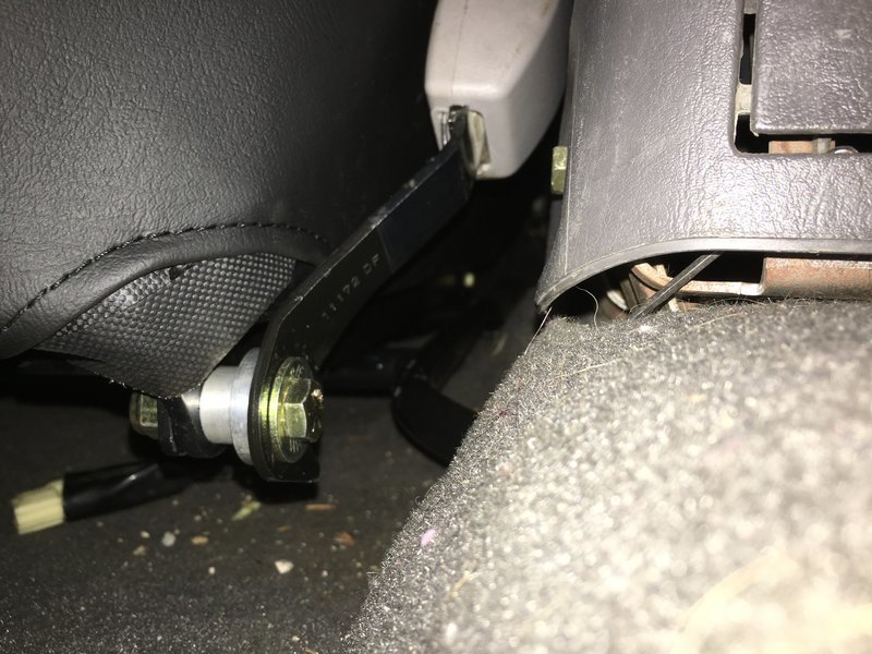

    Well putting these in wasn't too big of a job, just little stuff that got in the way. Had to make two trips to the hardware store lol.
    Don't really have any install pics, but it's pretty straight forward.
    Basically, all you get are the brackets, no bolts or nuts or anything. So to the hardware store I went for some grade 8 3/8"x3/4" bolts, lock washers and nylocks. Bolted the seat to the brackets first then realized I had to figure out how to mount the buckle to the slider (so when I go forward it does too, just like stock) this is what I came up.
    I had some leftover shock spacers I didn't end up using for my coilovers, so I threw those between the buckle and the seat slider. The plan is to extend it eventually as it's just a little bit of a pain to buckle up. But not enough of a pain for me to care right now lol.
    Again, this is just temporary until I get unlazy and build some kind of exo with bars coming through the cab for 5 points.
    And here they are mounted. So far I love these things.

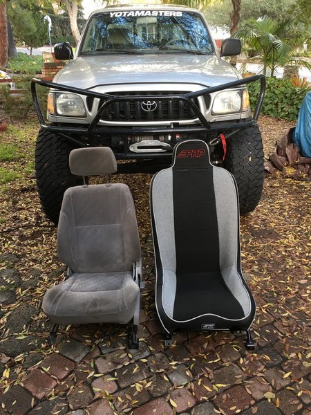

    I remember seeing this picture and thinking "how do even average sized people fit in a regular cab??"
    But I think the way you would have to go is reclining seats to save up as much legroom as you can, and if you get the daily drivers you will be sitting quite a bit lower than the stockers

    Great pic. That's exactly what i was referring to! I'm 6',0" and it is a bit tight in that reg cab lol. No chance a taller person can be comfortable in those.
    Good idea about the reclining seats. That might be the way to go. The other issue is that I want some sort of cage. Wheeling in the southwest, you really need it. An internal roll cage, my first preference, will only make the interior of the already cramped reg cab even smaller. I have seen a few examples of hybrid low profile external cages (around the cab only) that I like. That could do the trick.

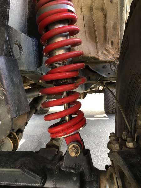

    If it ain't one thing it's another

    damn, how did that happen? Where you wheeling or did the coil snap just driving around?
    It seems like there was no significant damage. Should be an easy fix to replace that bottom coil spring.

    Just driving around lol. I think the shaft snapped off in the eyelet

    I'm about to start tearing it apart to see exactly how much I'm gonna cry when I buy replacement stuff, if it's just the coils not much crying, if I have to get new shocks....
  19. Jan 14, 2017 at 8:36 AM

    they are walker evans, with the dinky 3/4" shaft.
