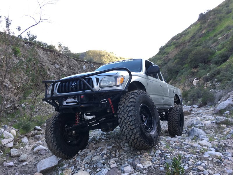

    First little shakedown was a success! Other than my front elocker motor not engaging but gonna tear into that tomorrow.
    Crawling with the duals is a whole other planet.

    Truck looks great by the way. It looks like 40"s on that pic :D
