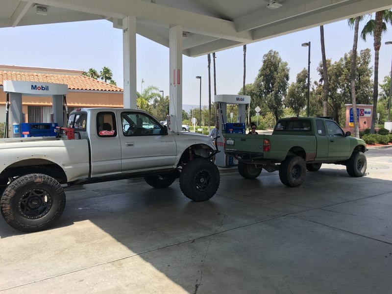

    The girlfriend was tired of driving a little Kia so we went picked her up this auto v6 4x4 with e locker spacer lift front and all pros out back this past weekend. Needs a little work but for the price it just made sense. She likes the matte green a lot lol :rolleyes:image.jpg

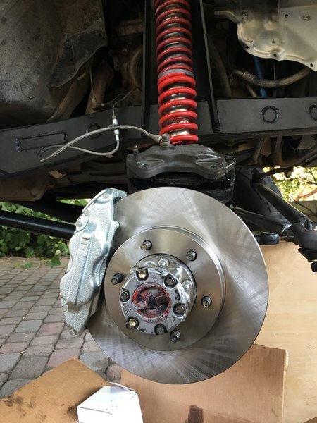

    Finally installed my 231mm tundra brakes (obviously not finished in the picture lol)image.jpg

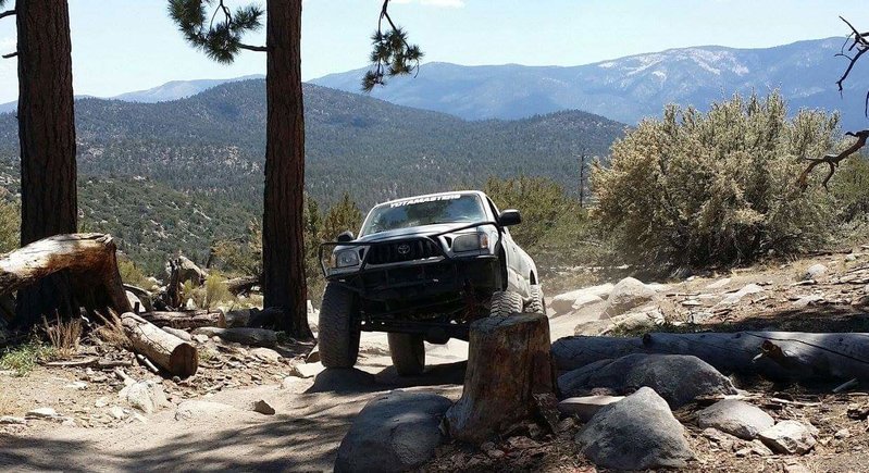

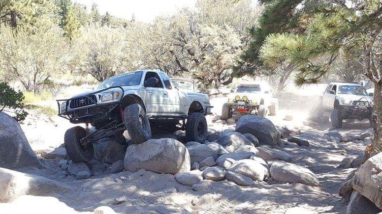

    some photos from this weekend

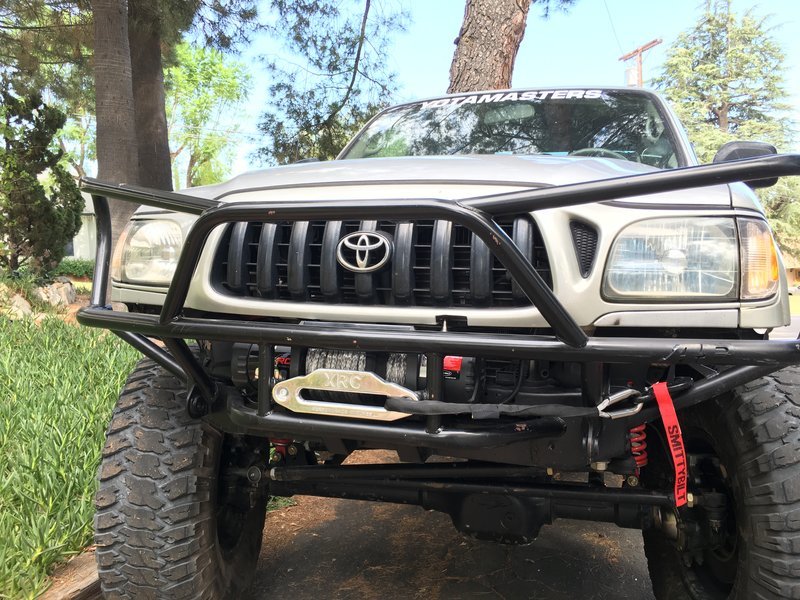

    Finally got a winch. No more big stupid empty space lol
