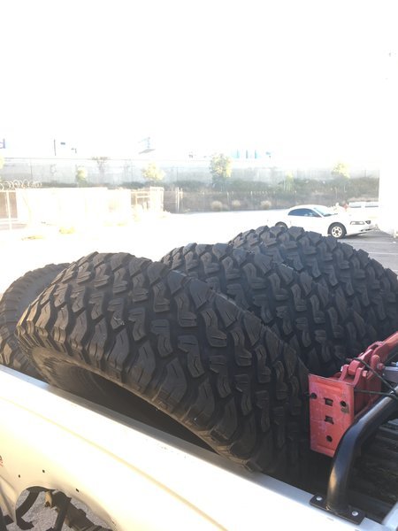

    Well pulled the trigger on 5 37x12.5x17 pit bull rockers today, they were having a 50% off sale so I just said screw it instead of continuing my search for decent used tires.

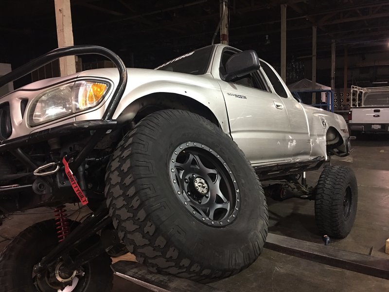

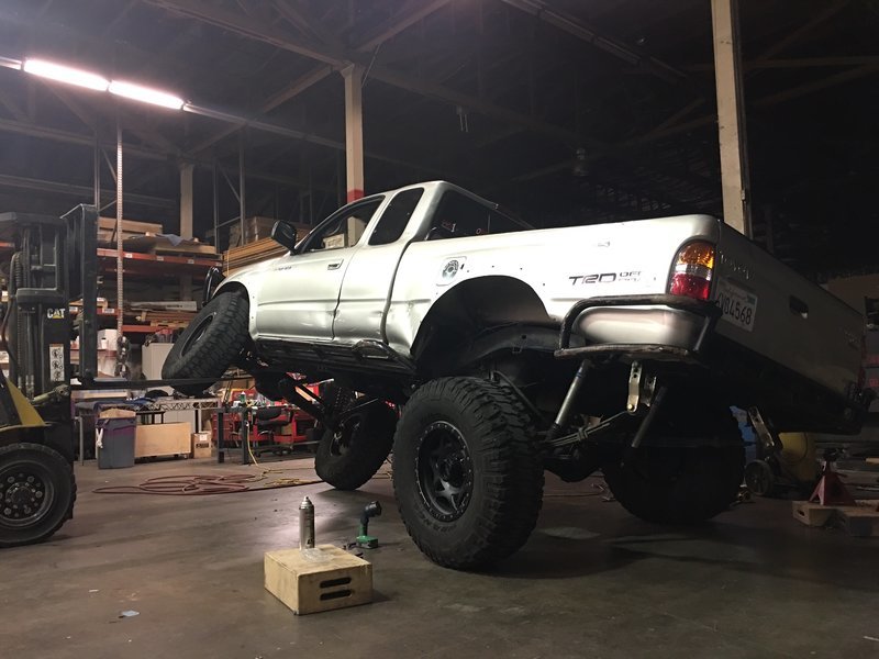

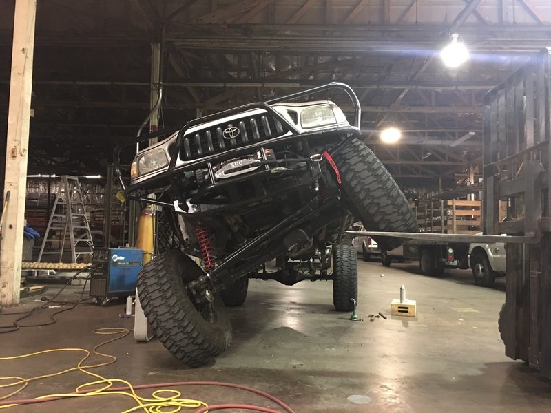

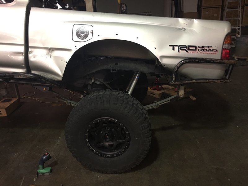

  10. Nov 17, 2016 at 6:25 AM
    #130
    Jimmynolife
    Jimmynolife [OP] Actually has a life
    Oct 22, 2015
    #167402
    574
    Jimmy
    Bend, OR
    3 linked 2002 Tacoma
    Finally threw the chevy 63s under the truck last night, still some more to do but the improvement is unbelievable.

  11. Nov 17, 2016 at 11:24 AM
    #131
    1999RegCab
    1999RegCab Well-Known Member
    Apr 4, 2014
    #127007
    1,522
    Cacti Land, AZ
    1999 Reg Cab, 2.7, 5 speed
    3-link SAS
    Nice!
    Pretty soon you gonna have more flex in the rear than the front :D
    Please post updates later about their performance. People seem to have mixed reviews with those. They are either too soft or too stiff seems like. A local guy ended up building his chevy 63" leaf packs with leafs from different year Chevy trucks (different spring rates), and that's how he eventually came up with a hybrid pack that gave him the best of both worlds. What year truck did you source yours from?
