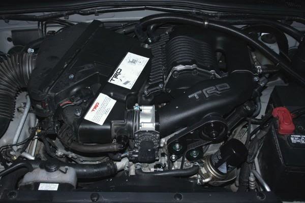

  20. Jul 13, 2008 at 12:29 PM
    #20
    NHinAK
    NHinAK Active Member
    Jul 13, 2008
    #7908
    38
    Anchorage
    08 Tundra TRD
    -Debadged
    You'll love it. I charged mine back in may and it is AWESOME! I'm having an PLX DM-200 with AFR, Boost, and Oil pressure installed next week so I can keep track of those parameters. I haven't gotten headers or exhaust yet, but those are on the list of things to do. It scoots pretty good for a 4X4 truck.:cool:
