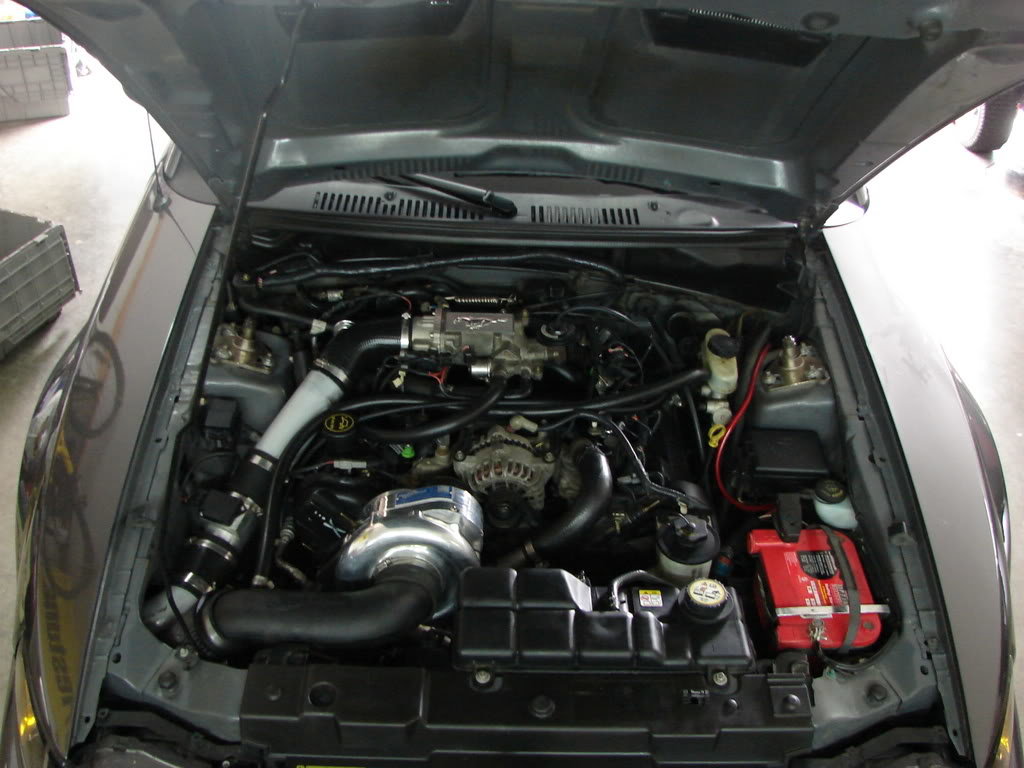

    Just as I said in the other thread, boost is the best way to add a crap load of power, while still having good street manners.
    As long as its getting enough fuel, and you keep your air fuel ratios right... (12.0 or less is typically safe) and don't over power the bottom end a supercharged engine can run for a long time with little to no trouble.
    Here is a picture of my setup:
    03 mustang GT 2v 4.6
    Procharger P1SC supercharer @ 10psi
    395rwhp 435rwtq
    all stock engine
    I did all the work myself except for the tune which was done by speedy dyno
    I don't have a charger on my truck, but I do know quite a bit about boosted engines. pm me if you have any questions.
