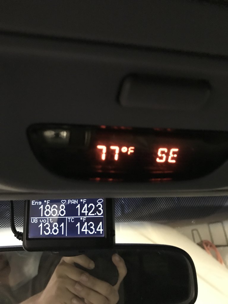

    I think my problem is somewhere else. Or maybe I need to hit the rads with a presser washer and not just a garden hose. Today idling in the starbucks drivethrough 85* ambient i hit 200 F, ac still worked though.

    We will get to the bottom of it. It's gotta be something stupid. I've been helping my brother move all day but when I get home I am going to test the fan clutch with a news paper and the engine hot.

    I actually just took a video. It seemed stiffer than I remember. Driving on the freeway is usually 190-200 temp
